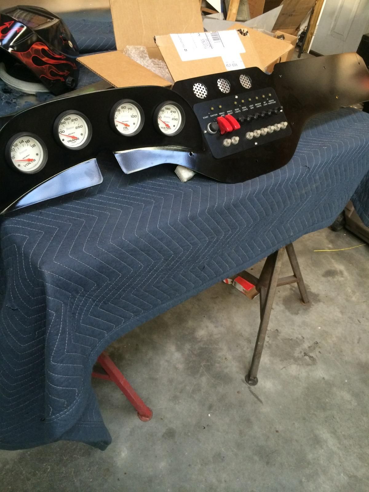

happy with my autometer phantoms. think the panel is a 12 volt guy
