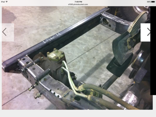

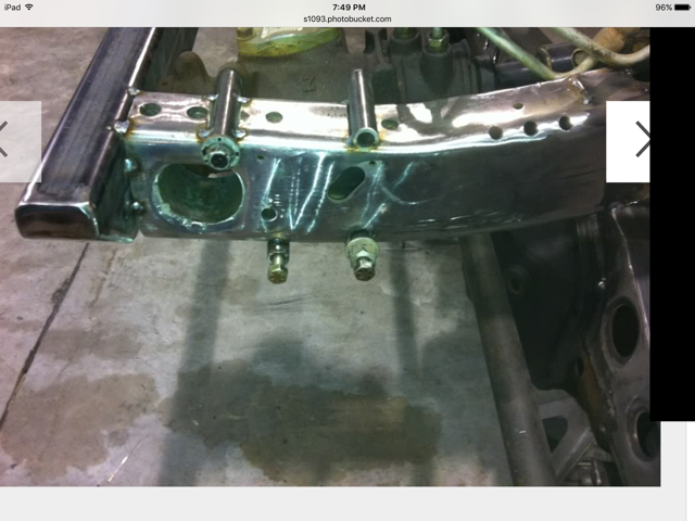

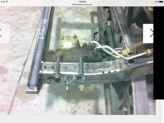

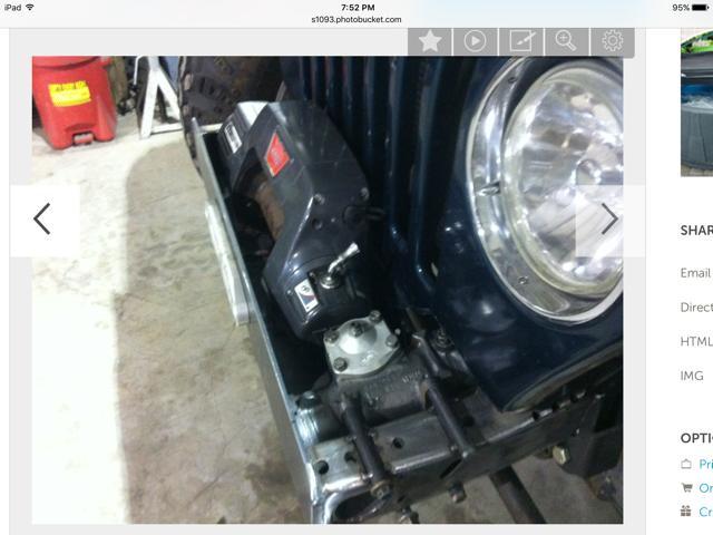

Here's how we did mine....

rugger99 said:
Nice job but a little more extreme than what I am doing. Did you get the bracket from him or the whole tube kit? Thanks for the pictures
Thanks for the pictures, I like this. You have a bumper tack welded in place, then you went a different route? Is it plate or angle iron? How does the steering shaft and joints work out?
Just the steering box mount, the tube work is my creation.
It's plate with two breaks in to make a u shape basket to hold the winch. Steering worked out good by using all factory stuff and just lengthening the shaft. I'll try to get more pics as Photobucket screwed me like everyone else.
so the winch plate is only connected to the frame in the front? have you had any issues with that flexing when winching or has it been plenty strong?
The plate is a " U " shape. It will rip the frame apart before that plate gives. :****:
It is welded to the front of the rails, go's under the rails and is broke up and is welded inside the rails on the rear. It would have to rip the 1/4 plate up between the rails and take the box off before it would come off.
Gotcha, I couldn't tell in the picutres if it was attached under the box too. I like it
