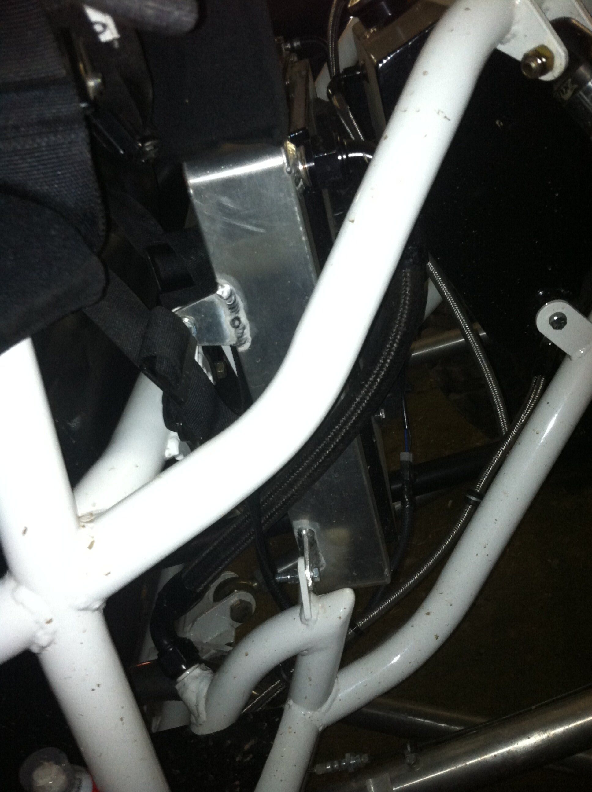

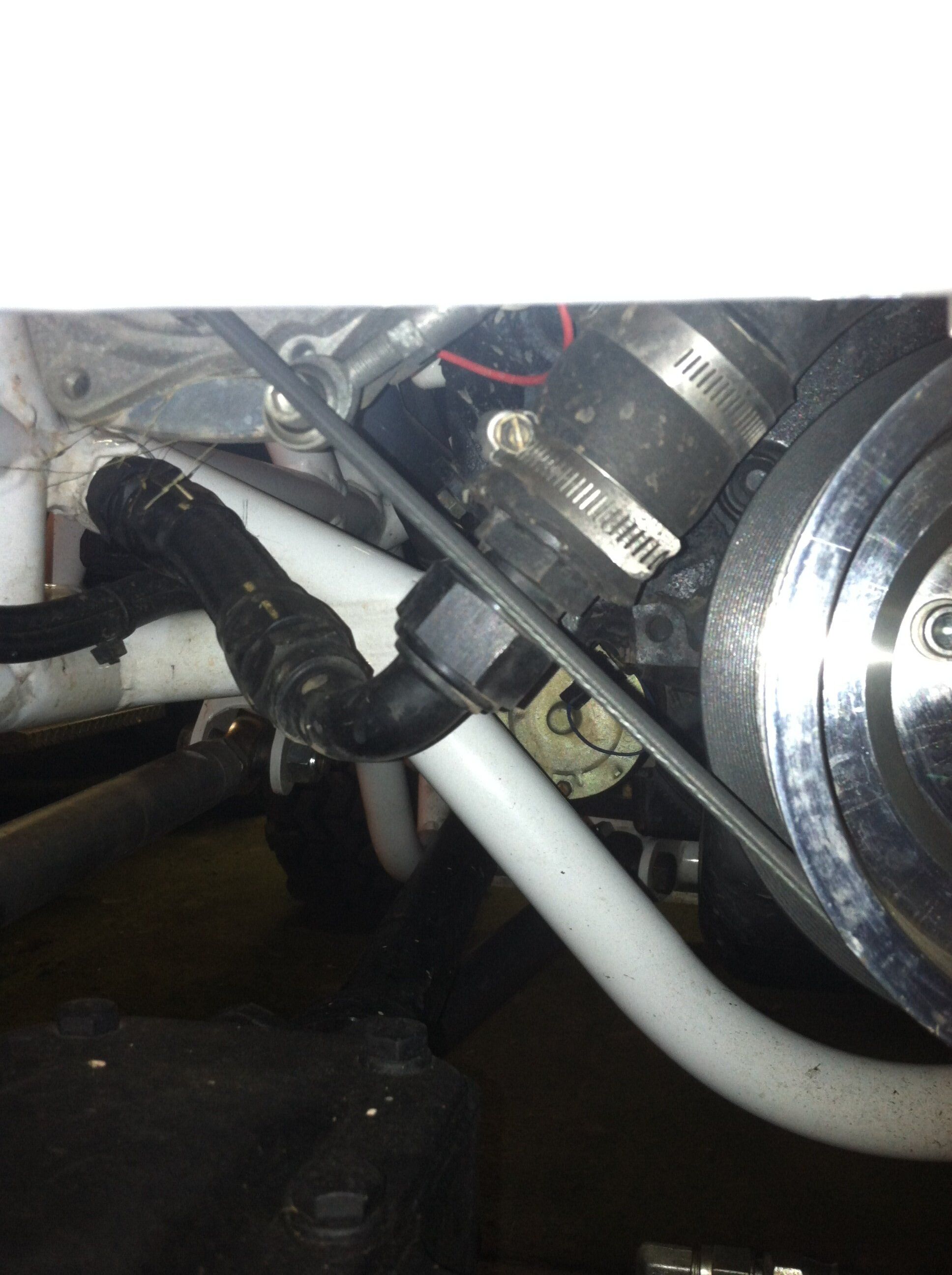

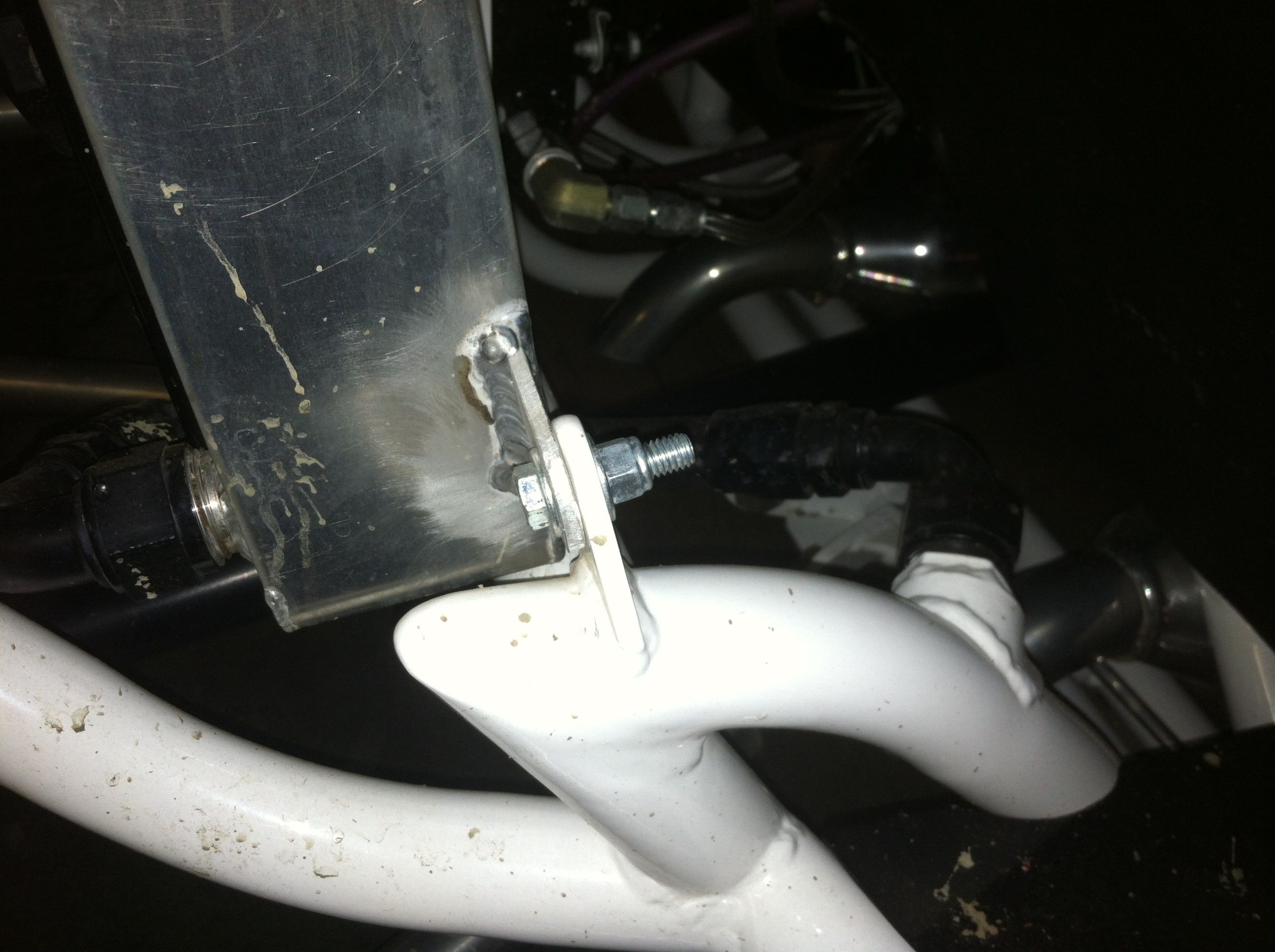

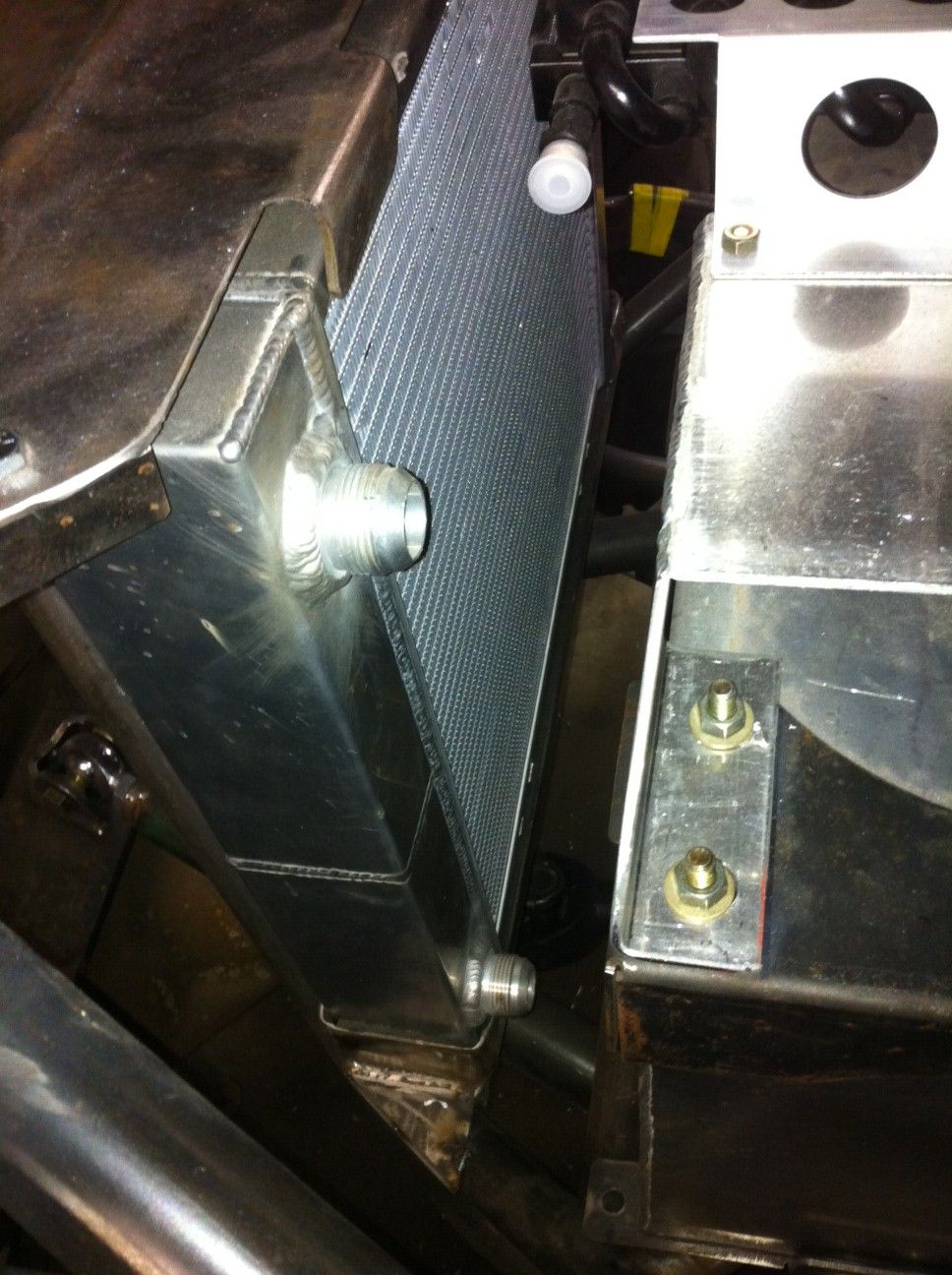

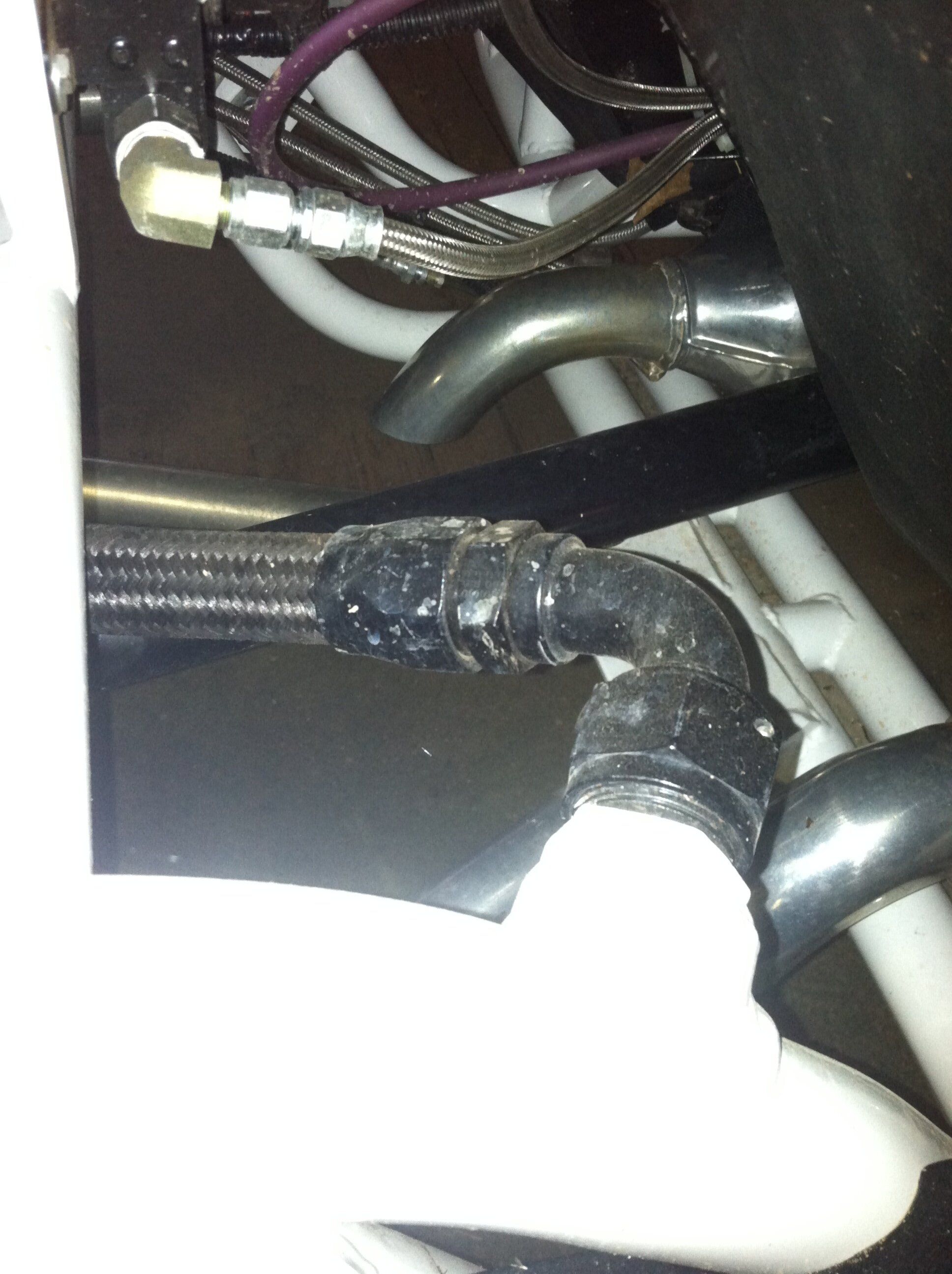

Here's mine with AN fittings. Like Elliot said keep the hoses short and they won't flop around.

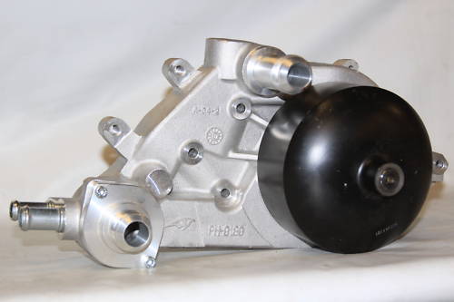

Mine has a weld in bung to 16an fitting w.o.d has them and jegs also has them I'll try to get u a part number

Here's the water pump connection. AN barbed fitting to a short section of radiator hose.

Looking at the pics, you would think that AN16 size fittings and hose would choke down the coolant flow too much. But ive seen alot of them out there . Any cooling problems?
It will cool a lot more horsepower than my stock 6.0 puts out. No problems with mine.
