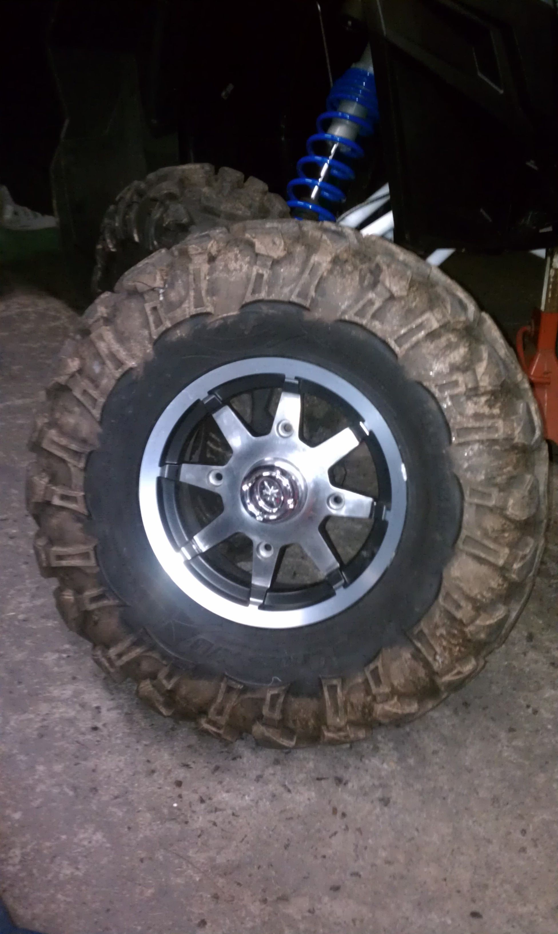

took factory wheels an gave a face lift

Sanded powdercoat off with a gasket giter then took 400 grit sanded by hand then hit wit 600 an went over again with 1000 and polished with mothers
Looks great. How about a close up of them? Did you leave the rim part black?
I did they turned out pretty good alot of werk tho .got bout six hrs in um

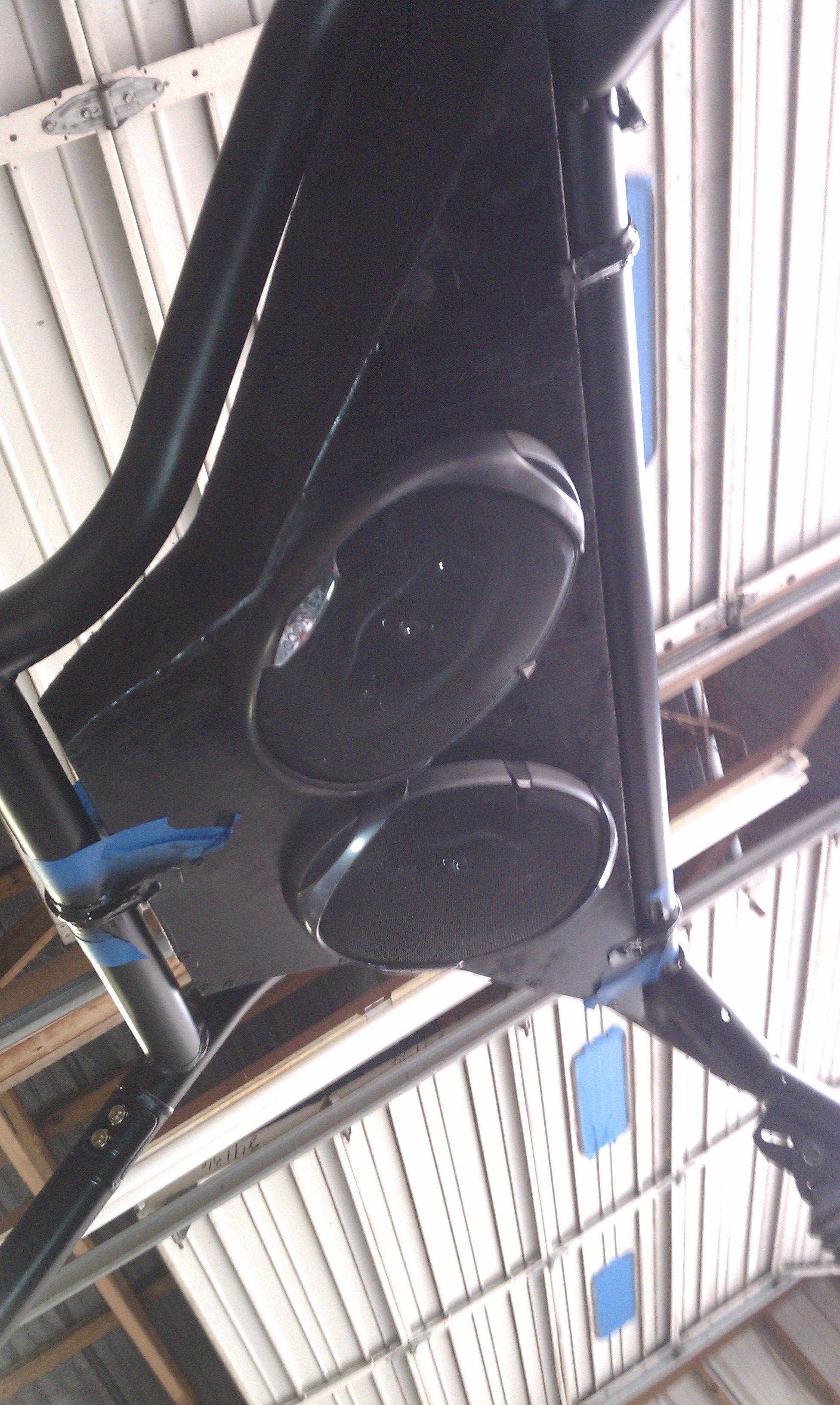

Also built a custom box with 6x9 which sounds awsome was very pleased with how it turnd out

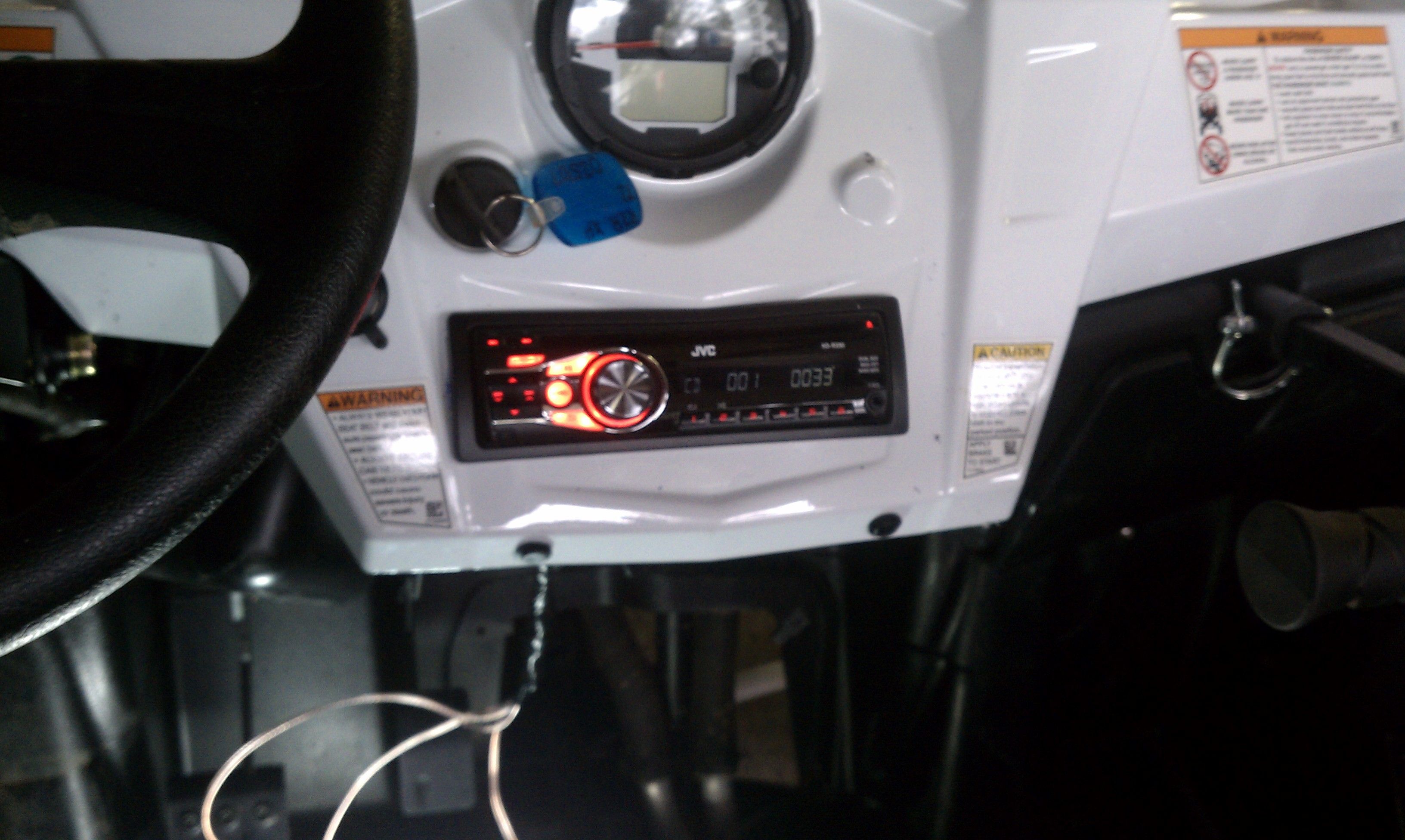

Put stero in dash
