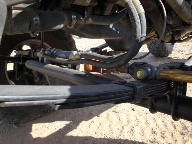

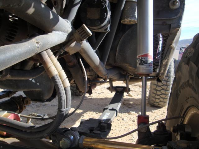

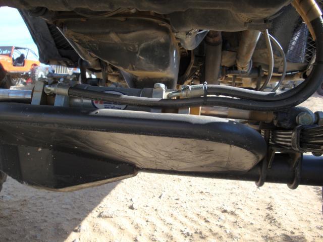

Took this it koh..Take a real close look at everything going on here..full tube chassis with a toy body on it. Granted its a fab'd housing w/d44? knuckles but you get the idea

when i mounted my hydro assist ram on the top of my toy housing on my 85 pu, it would bash into my oil pan at full flex/stuff, when i remount mine i plan on mounting it to the front of the axle and then bending a hoop like the one in the picture above this to protect the ram
thats what i was thinking
He had his pan custom dented to clear. This was the cleanest exectuion ive ever seen so i snapped a few..leaf springs sure do make it hard to do..
i am sure that his motor is somehow lifted up higher than say one in the stock location, i would hope so anyway, if you are going to go through all the trouble to make a tube chassis and keep it leaf sprung.
not only did my pan dent but my transfer tube was dented aswell,

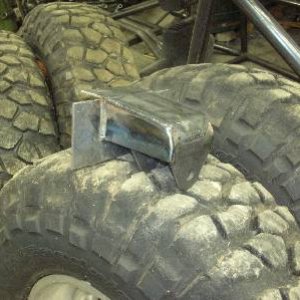

Im running a 350 and all pro springs, I used to have mine mounted like trail gears directions and did not like it. things bound up and hit and I also dented the oil pan twice. So now I have this mount and it works a lot better, I also moved my motor back a ways so that helps to, anyways heres a pic of my mount. Kinda like the first one above
well i got my box moved 2" foward, what a pain in the ass!!! have to rebuild my body/core support mount now.:booo:
hell yea looks great:cool:, but like everyone else said why the spacers under your springs.. kinda defeats the purpose of bein low to some extent...
