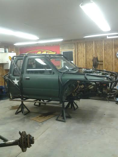

So i im finally getting to tons have a few goodies
85 ford with dodge outters yukon chromos 4.10 gears
14 bolt shaved 4.10s
dana 300 32 spline outputs jb 4.1 gears fliped
screamin... 4.3l with th350 with all goodies i had this drive train with toy axles
43 sx's 8 bolt hummer wheels

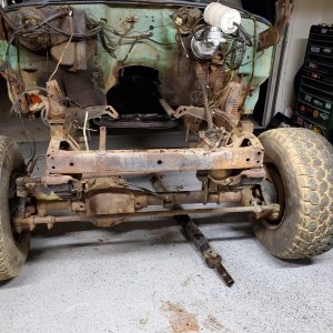

before pic

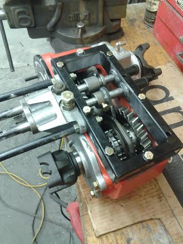

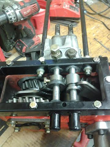

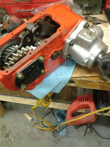

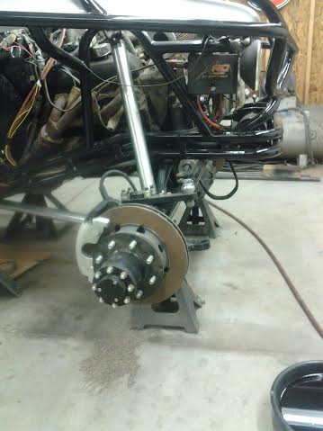

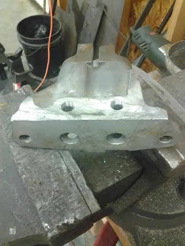

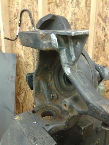

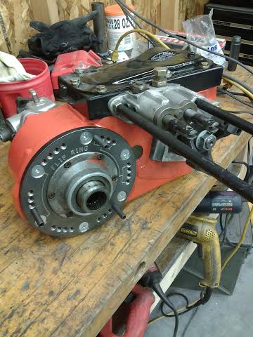

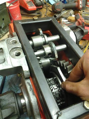

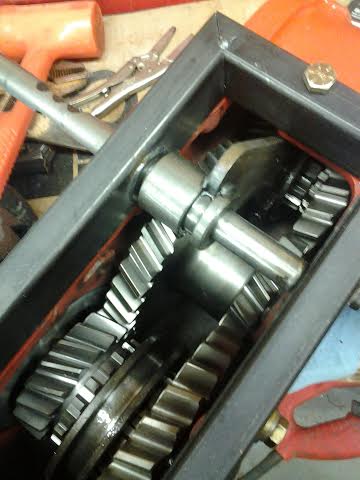

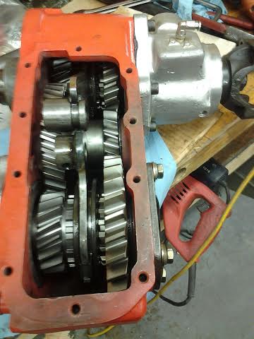

flipping the dana 300 was a hole lot of trial and error i bulit the frame out of 1.75 x .75 x .125 wall i drilled one hole and sleeved the hole with 5/8 pipe but i had to do alot of grinds the i.d. of the pipe out for shift rail to slide smooth then did second had to lenghten the front fork

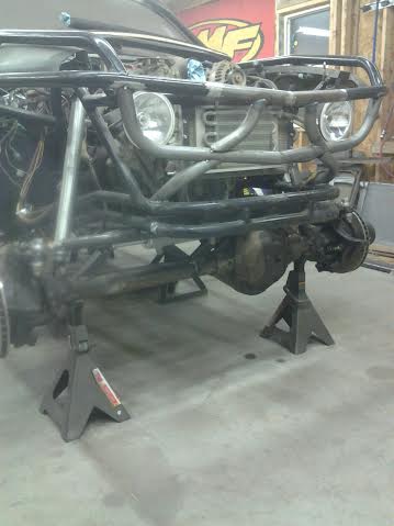

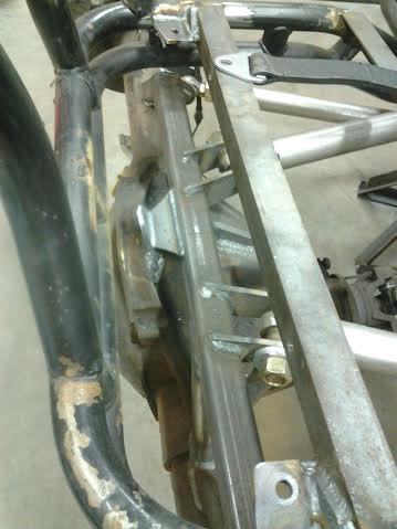

all tore a part ready for tons i did have to remount all of my drive train becuase it was cocked becuase i was runnin a carrier bearing before to help drive shaft angles

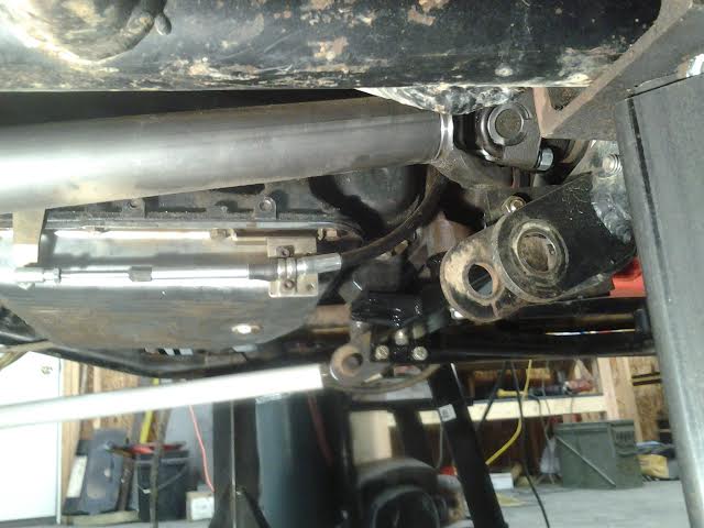

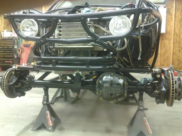

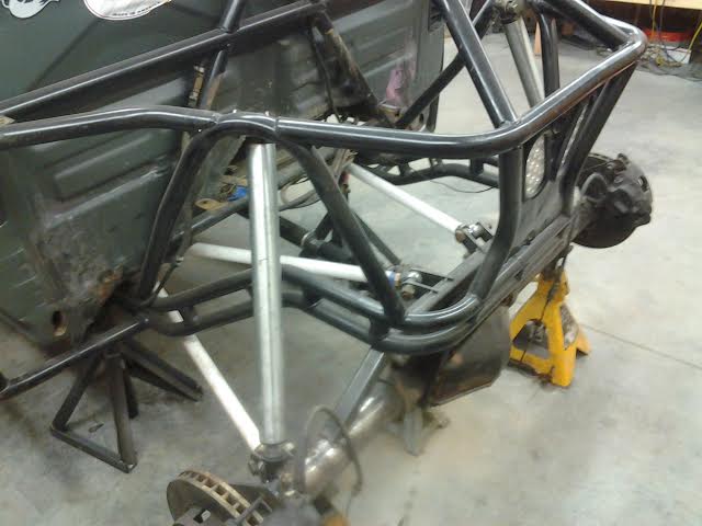

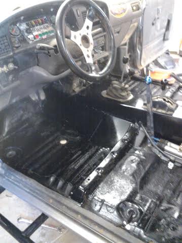

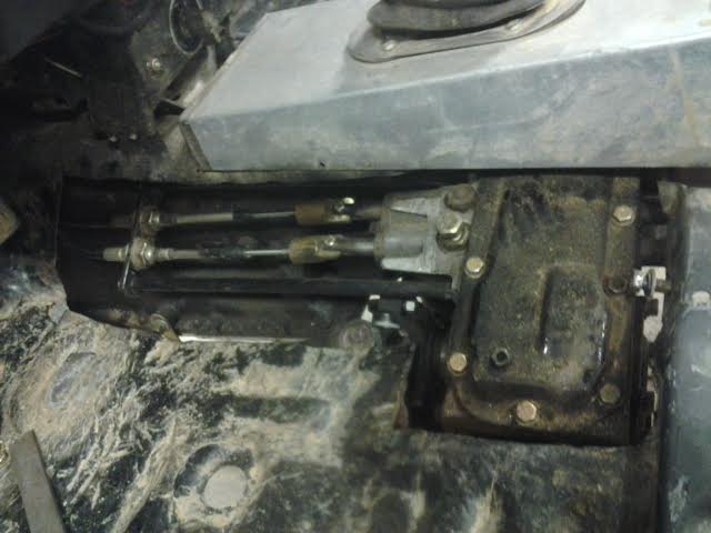

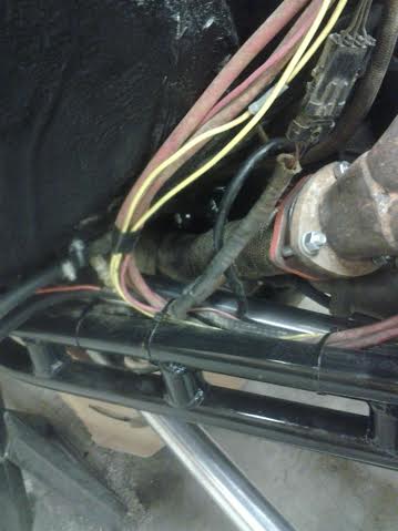

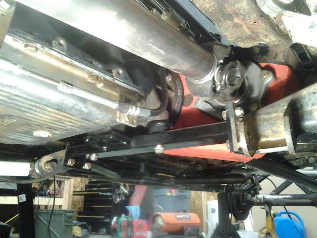

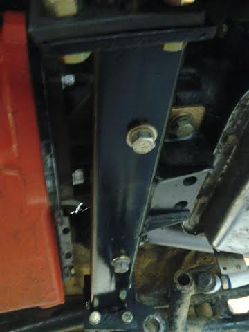

i tacked front driveshaft up first to make sure was goin to clear upper link with out move upper link mount. got tranny shifter routed over top case its tight but shifts smooth i have 6ft cable it think that helped alot

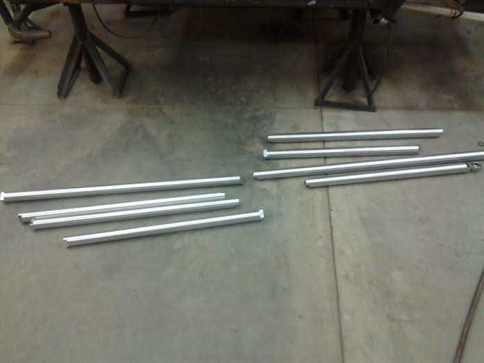

all 1 3/4 7075 links

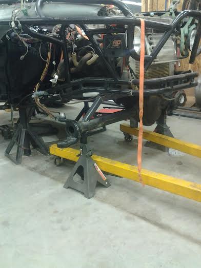

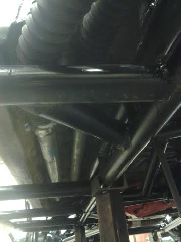

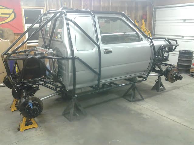

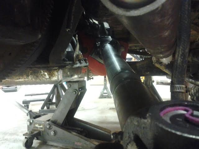

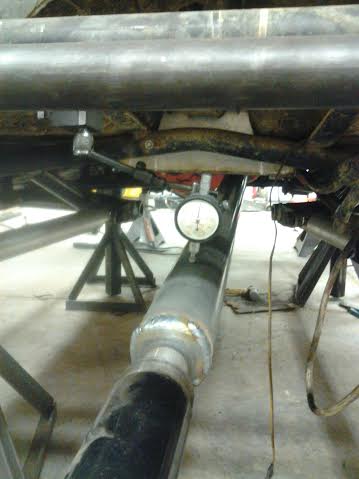

little driveshaft tec i put dial indicator on shaft as i tacked and welded it with it bolted in place i was able to get the rear within 3 thousands. and i redid some of the cage

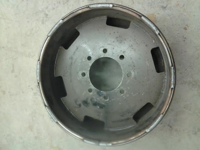

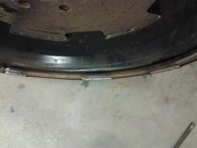

i added 1/2'' cold rolled round stock to inner bead

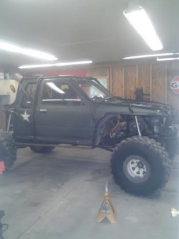

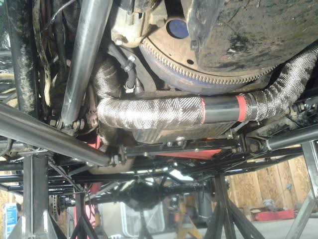

exhaust was tight but worked out pretty good

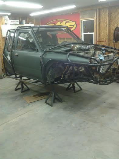

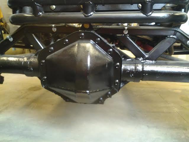

paint

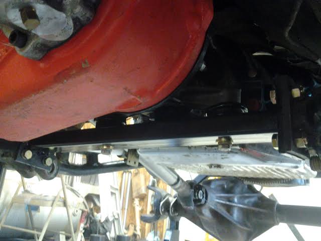

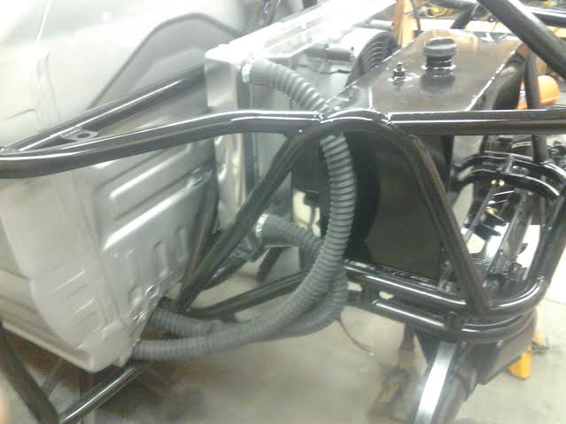

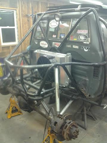

rad. lines and fuel cell

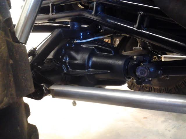

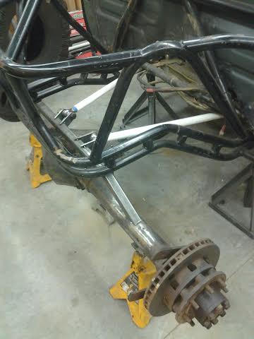

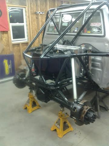

axle pics
