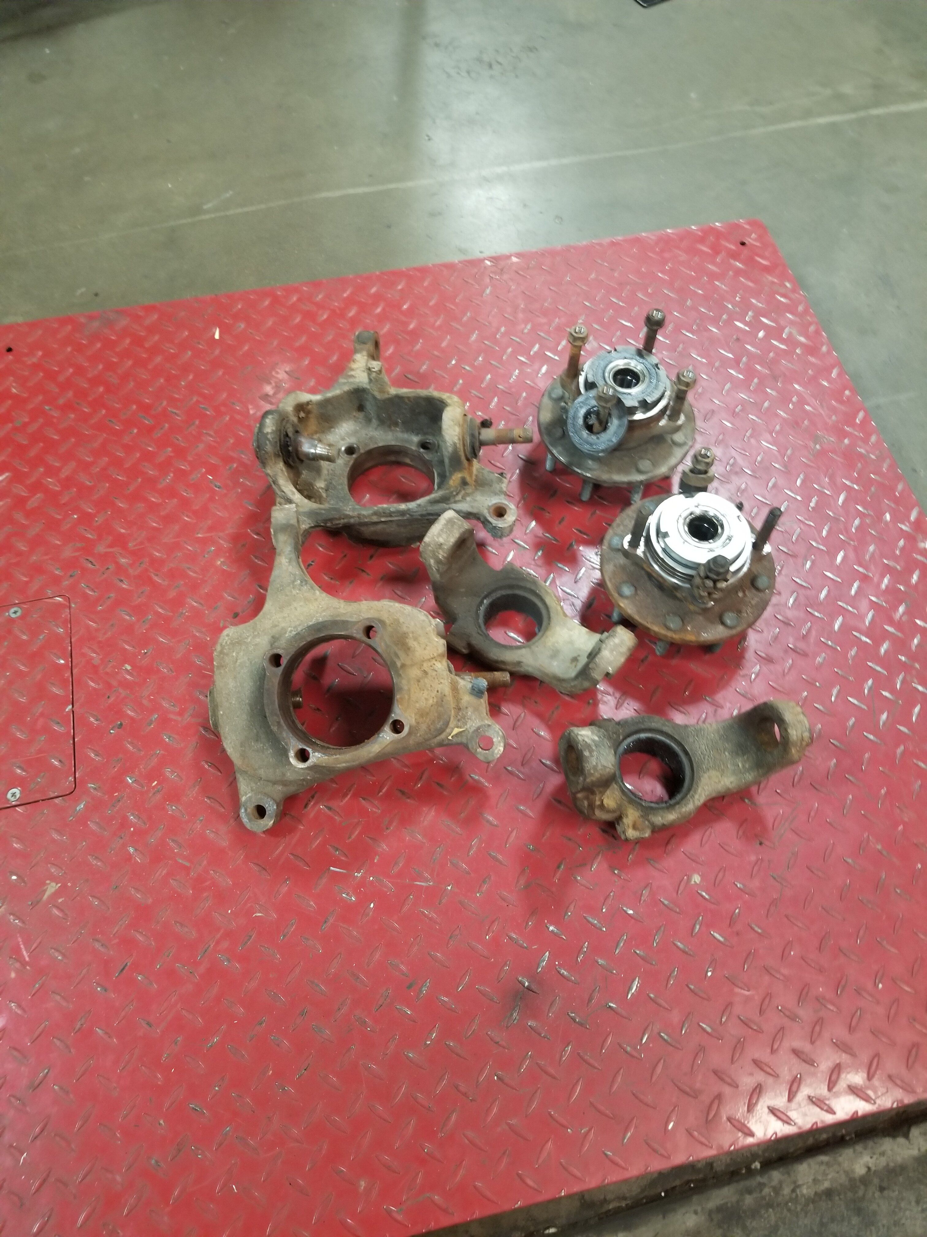

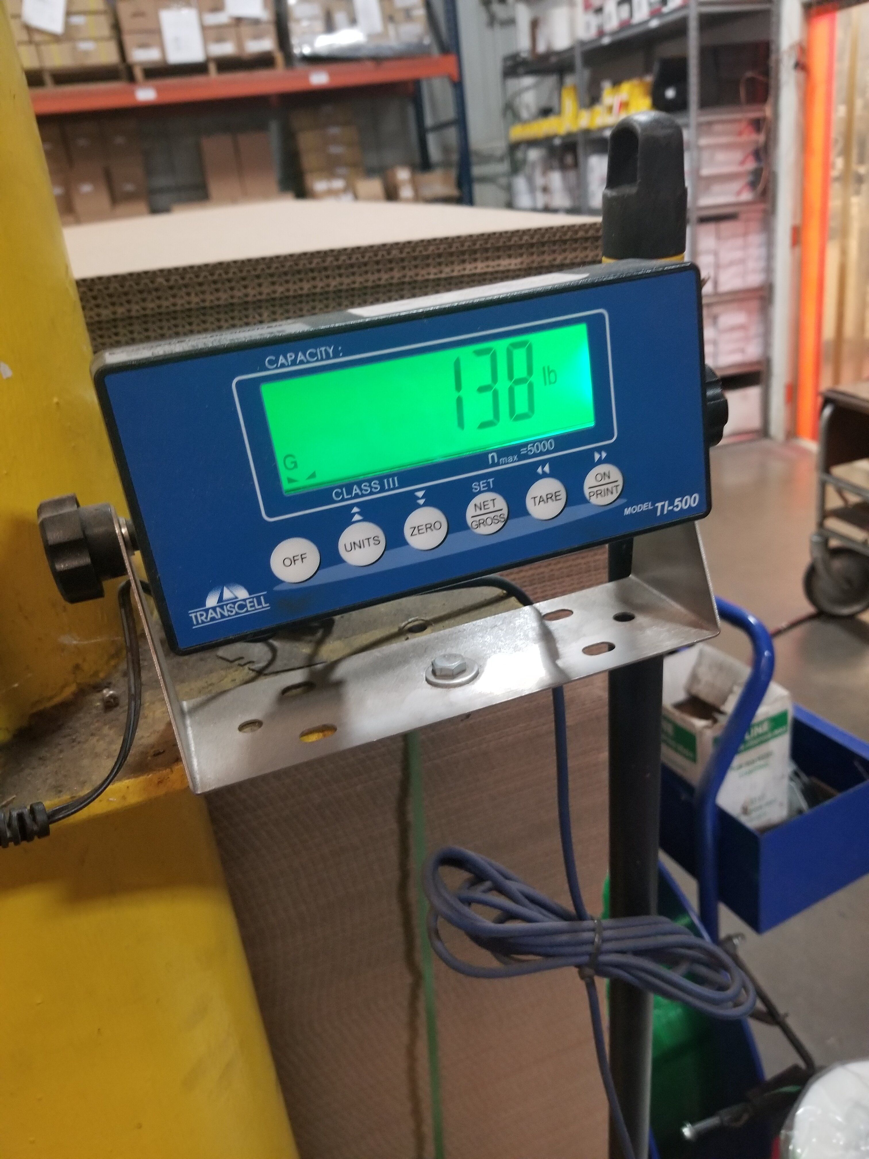

Just weighted my 99 to 04 stuff.138lbs Cs,knuckles and UBs with hardware and ball joints

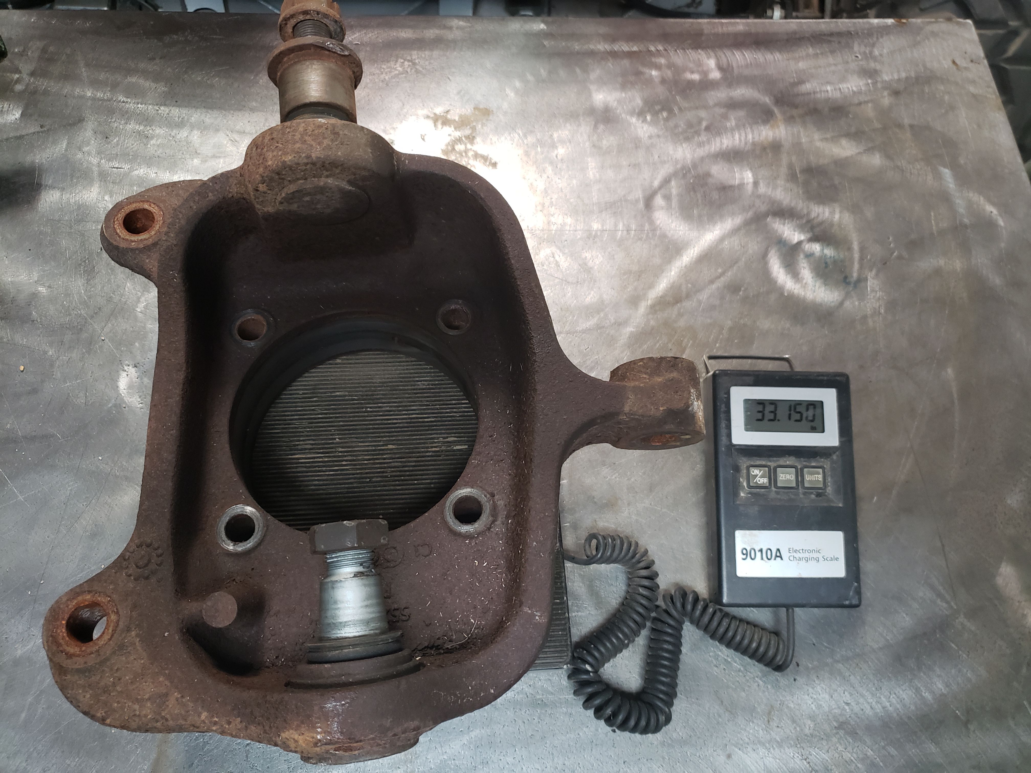

05 knuckle w/ball joints. 33.15 lbs

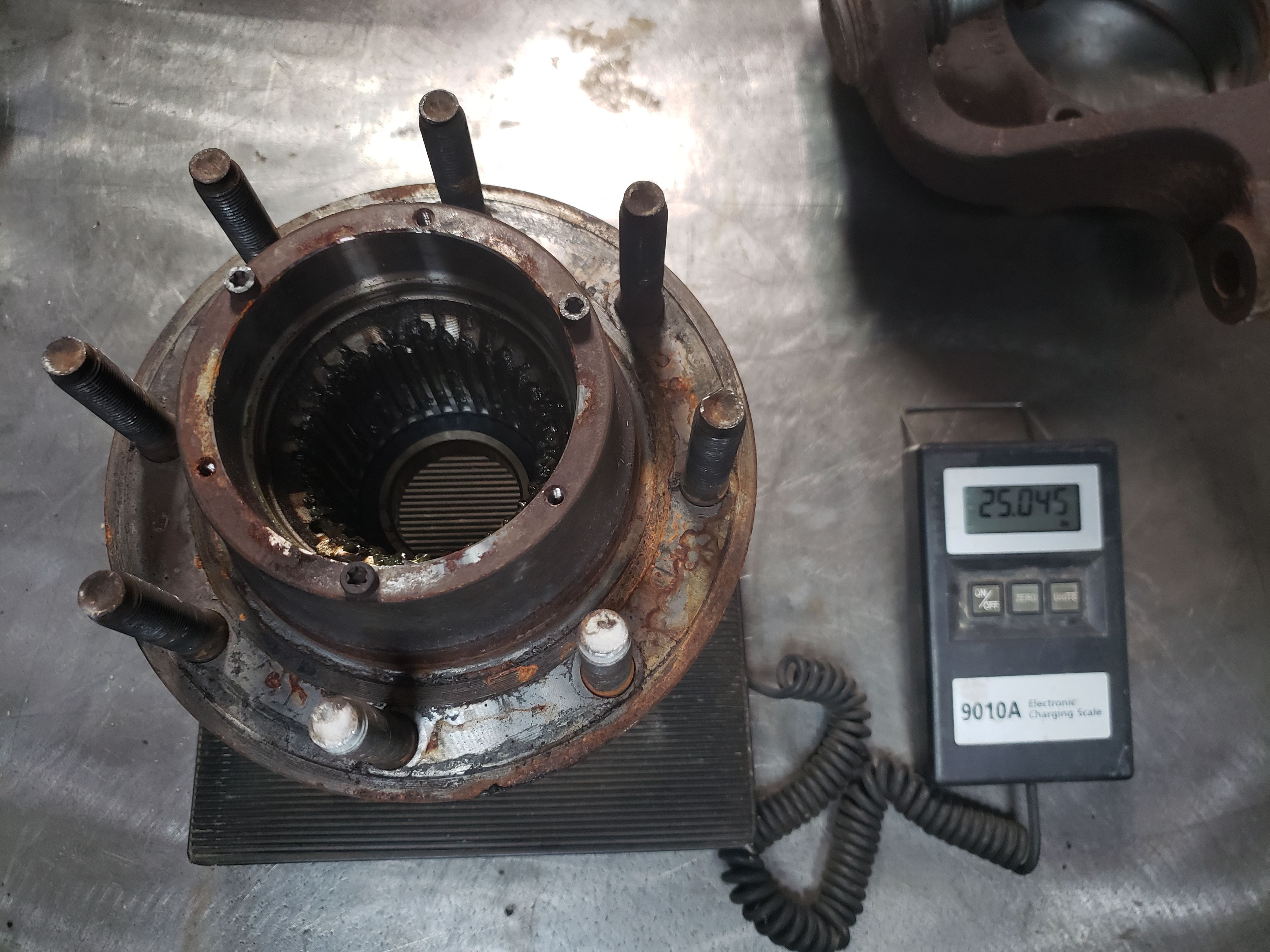

05 unit bearing w/ studs. 25.04 lbs

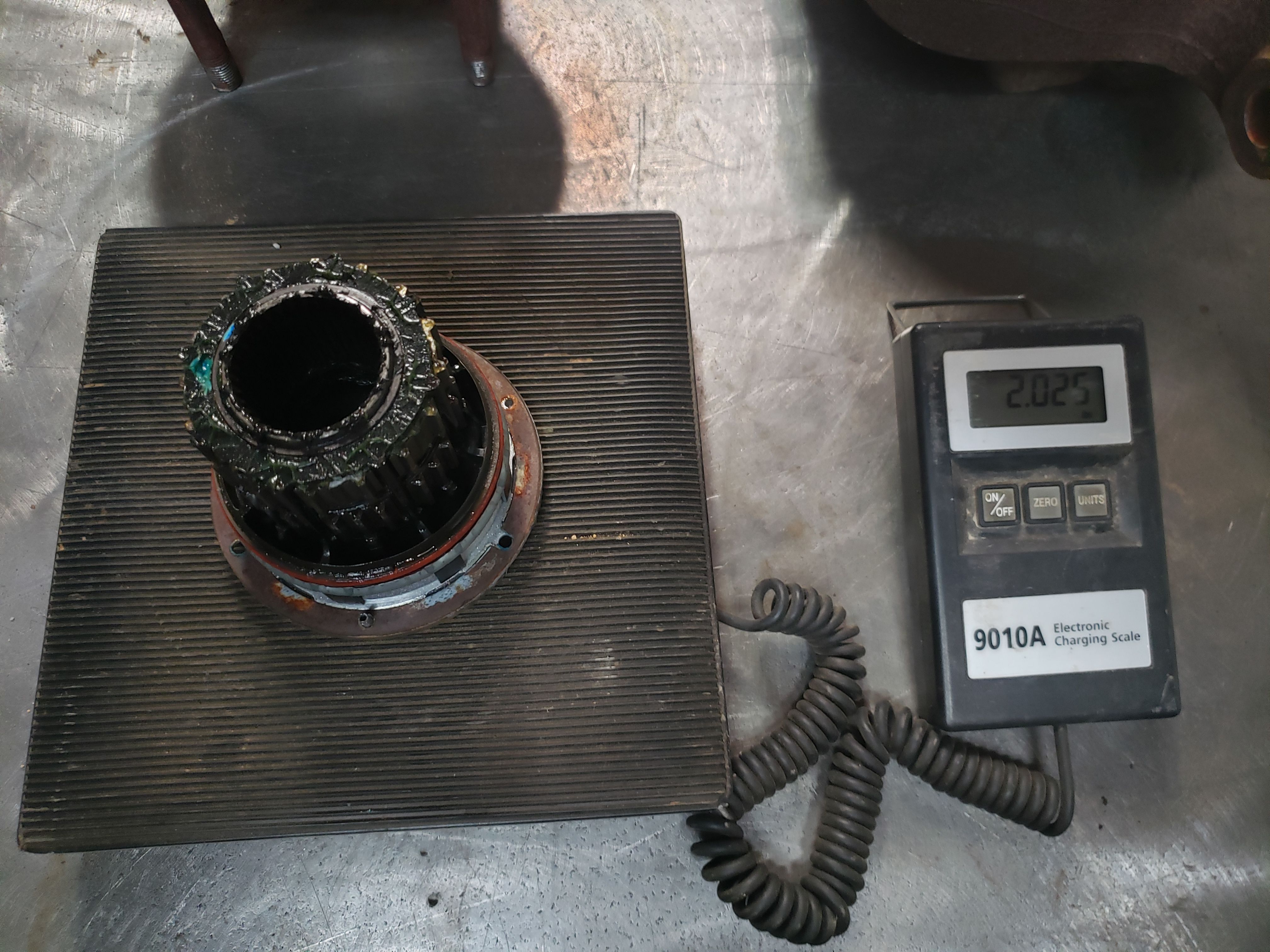

05 oem lockout 2.02 lbs

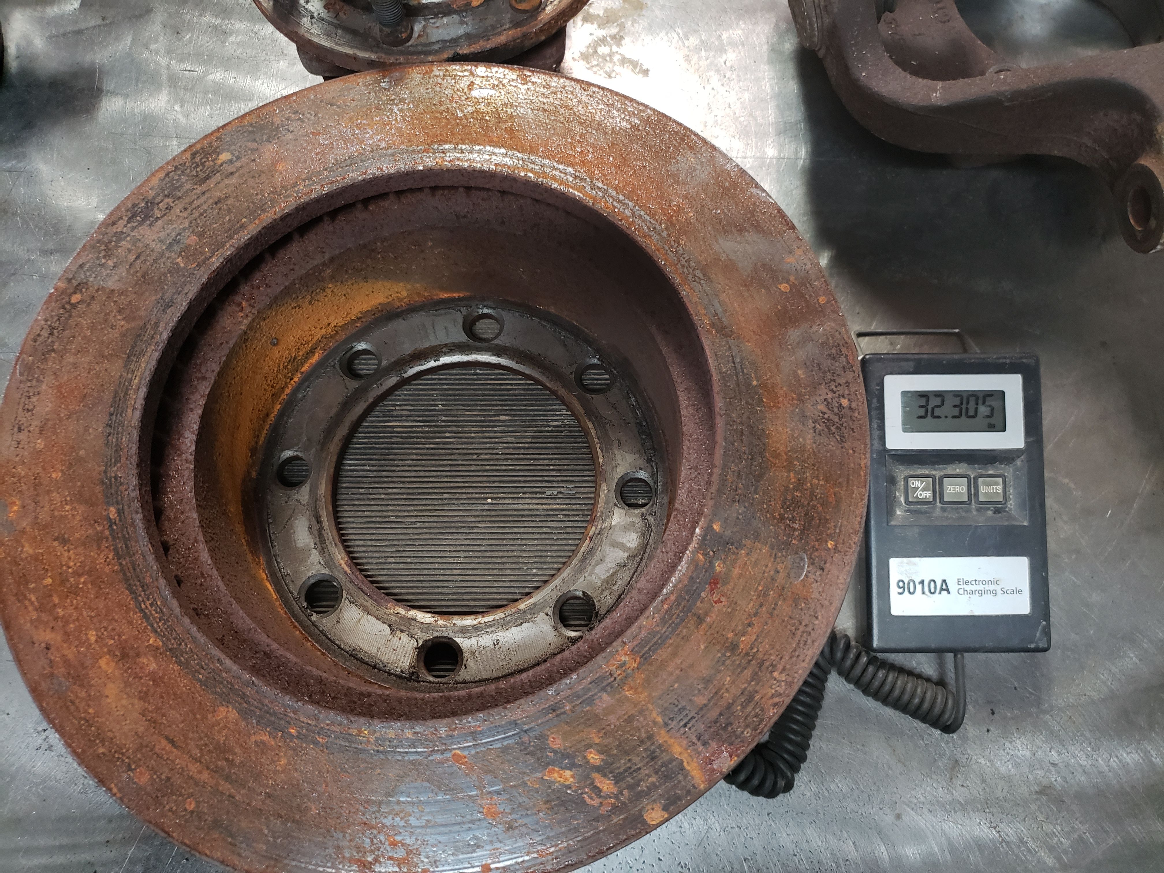

05 front rotor 32.30 lbs

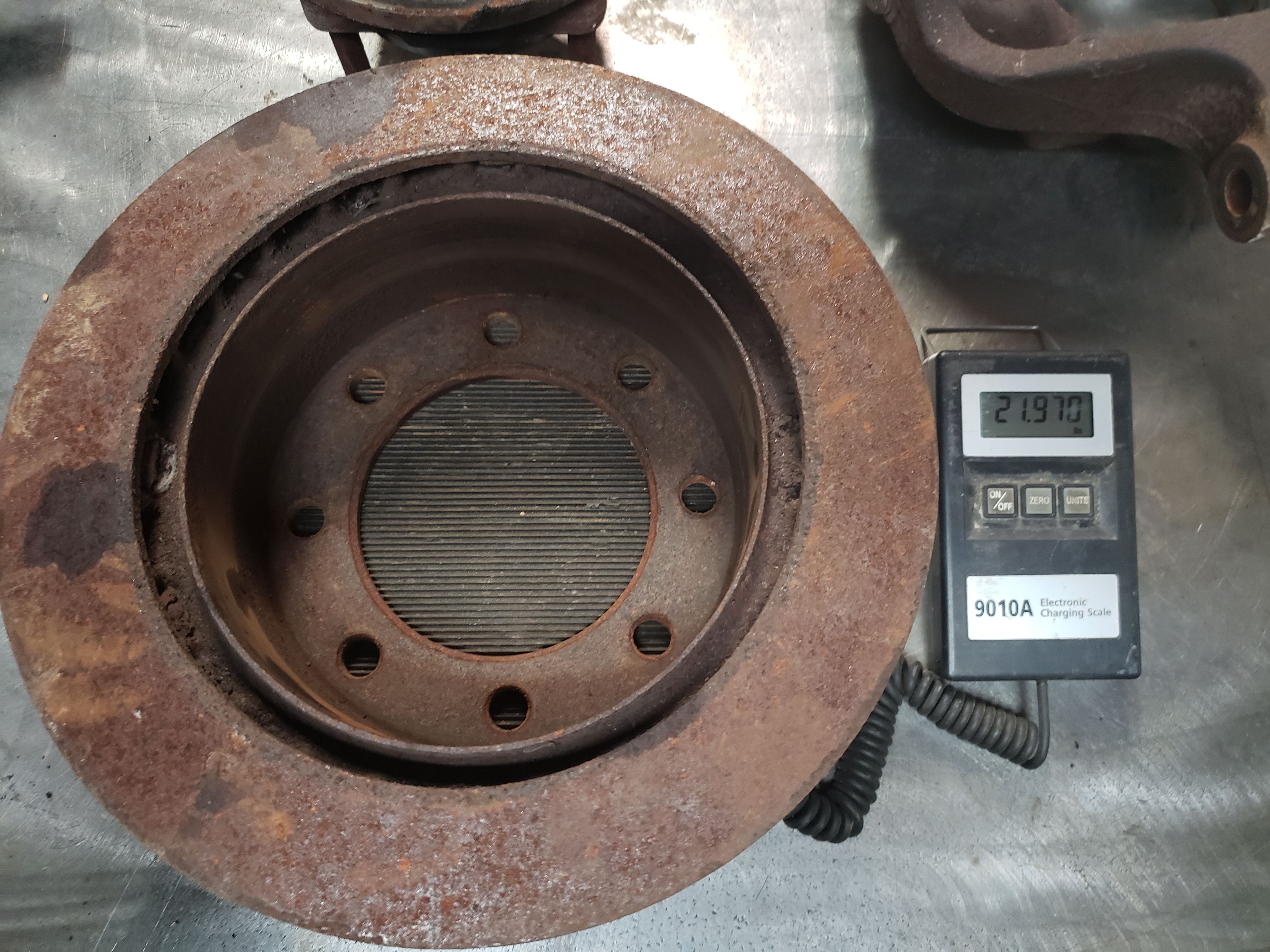

99-04 rear rotor 21.97 lbs
99-04 rear rotor has same pilot i.d. as the 05 front. It fits the unit bearing without issue. Now just to find a caliper that fits well. I am hoping a 99-04 rear caliper will fit.

05 front rotor then 99 rear rotor then 05 outer with 99 rear rotor.

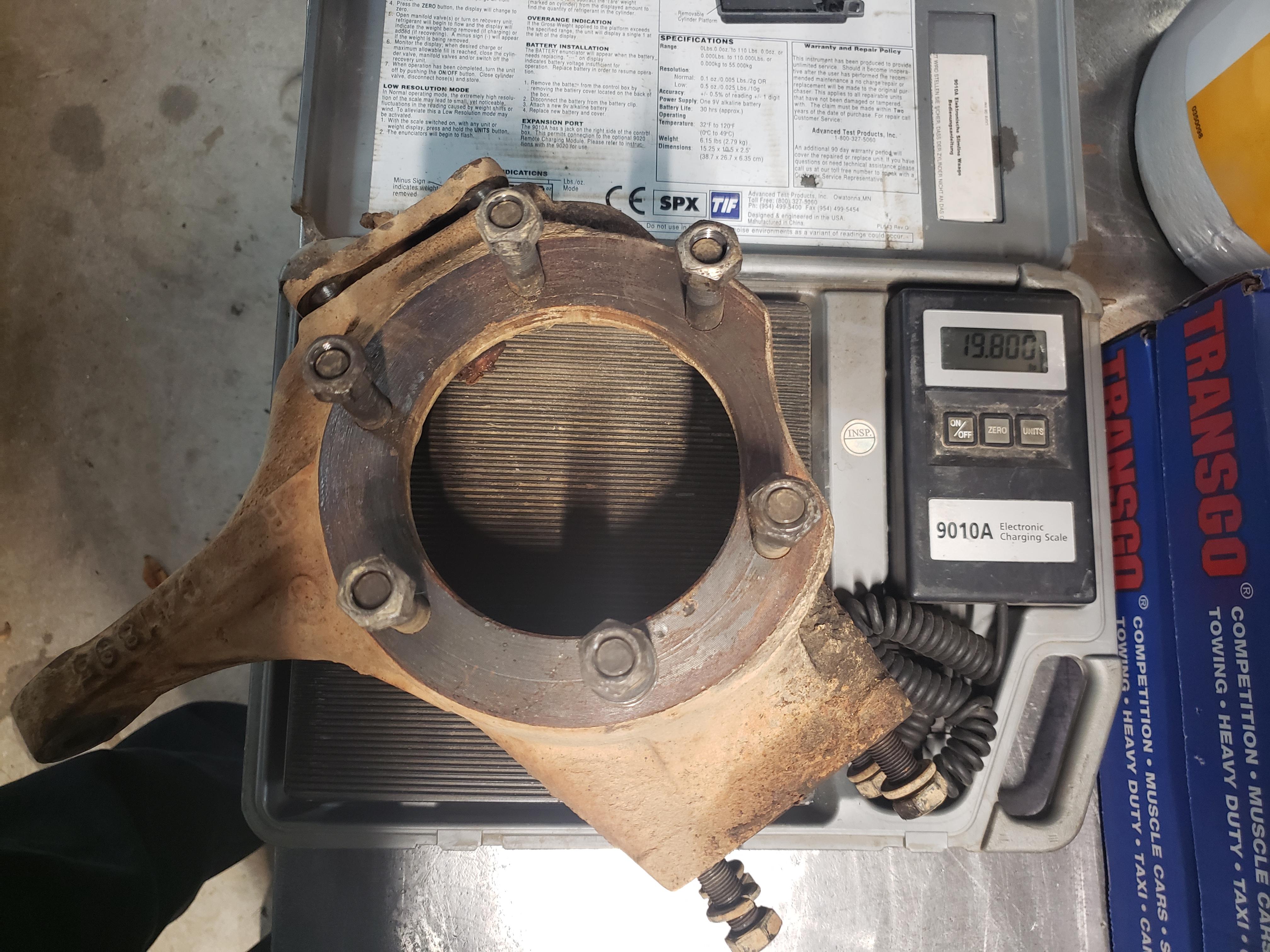

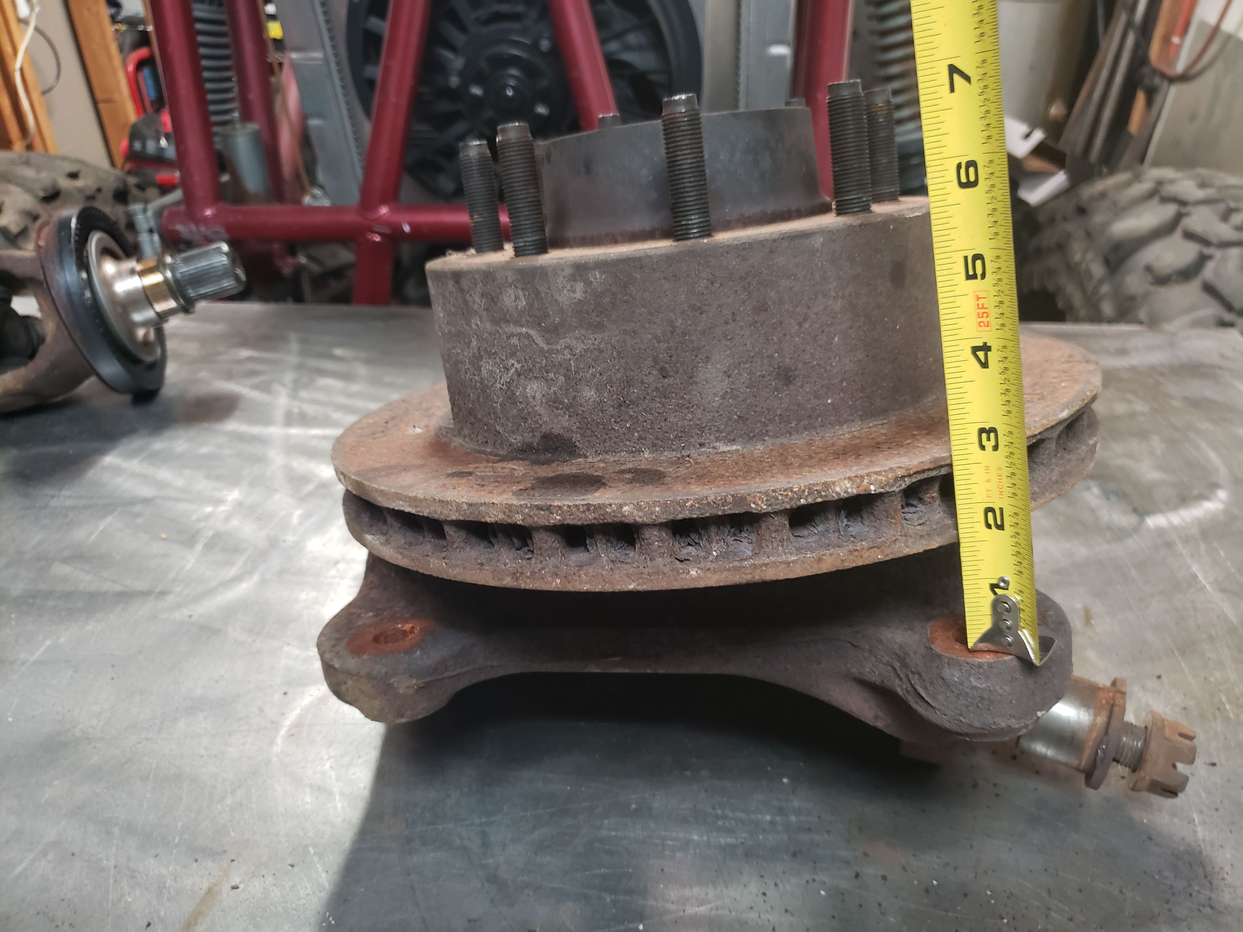

I was able to weight GM kingpin outers (thanks Brad).
Knuckle with lower kingpin = 19.8 lbs.

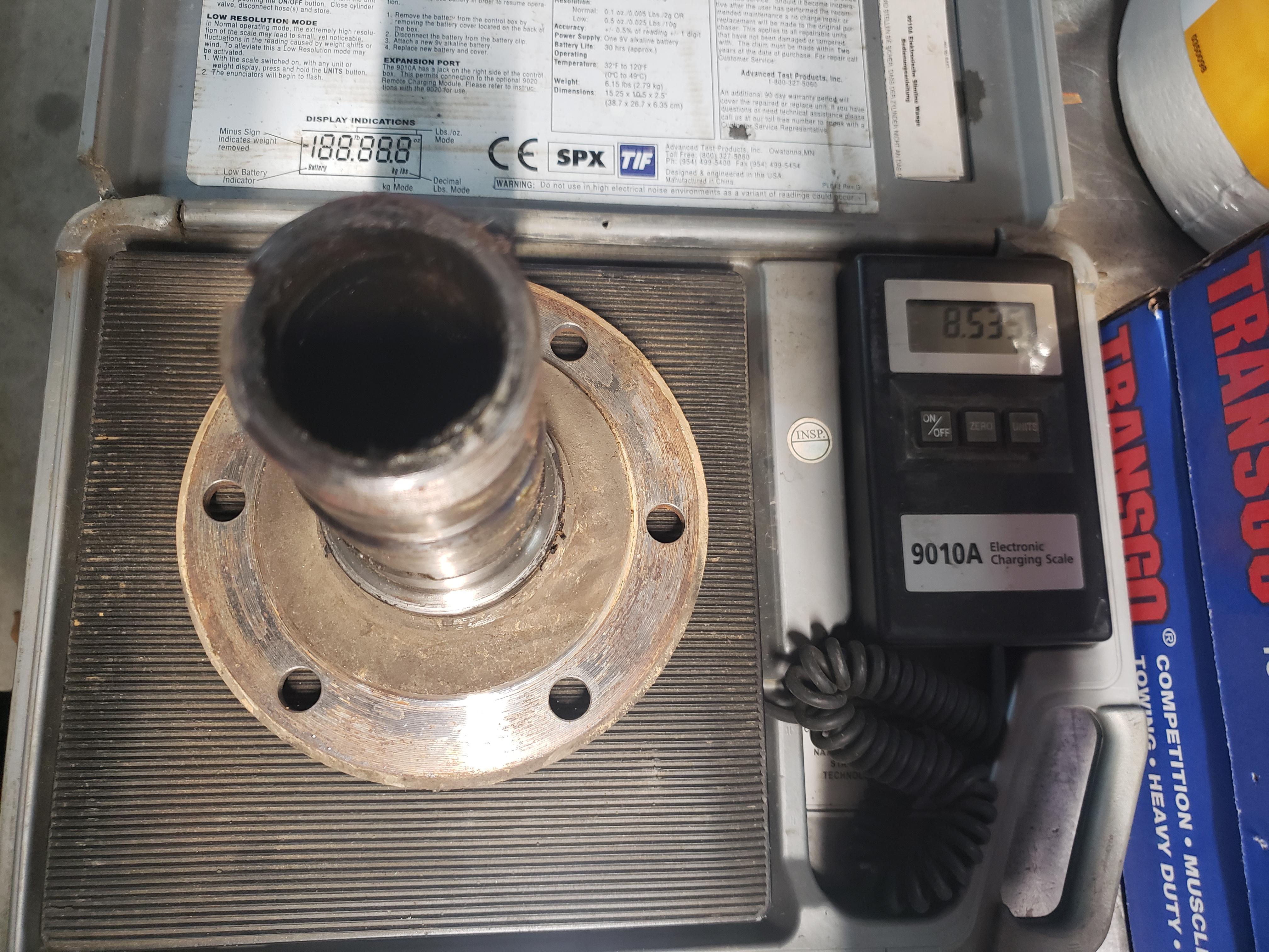

Spindle = 8.5 lbs

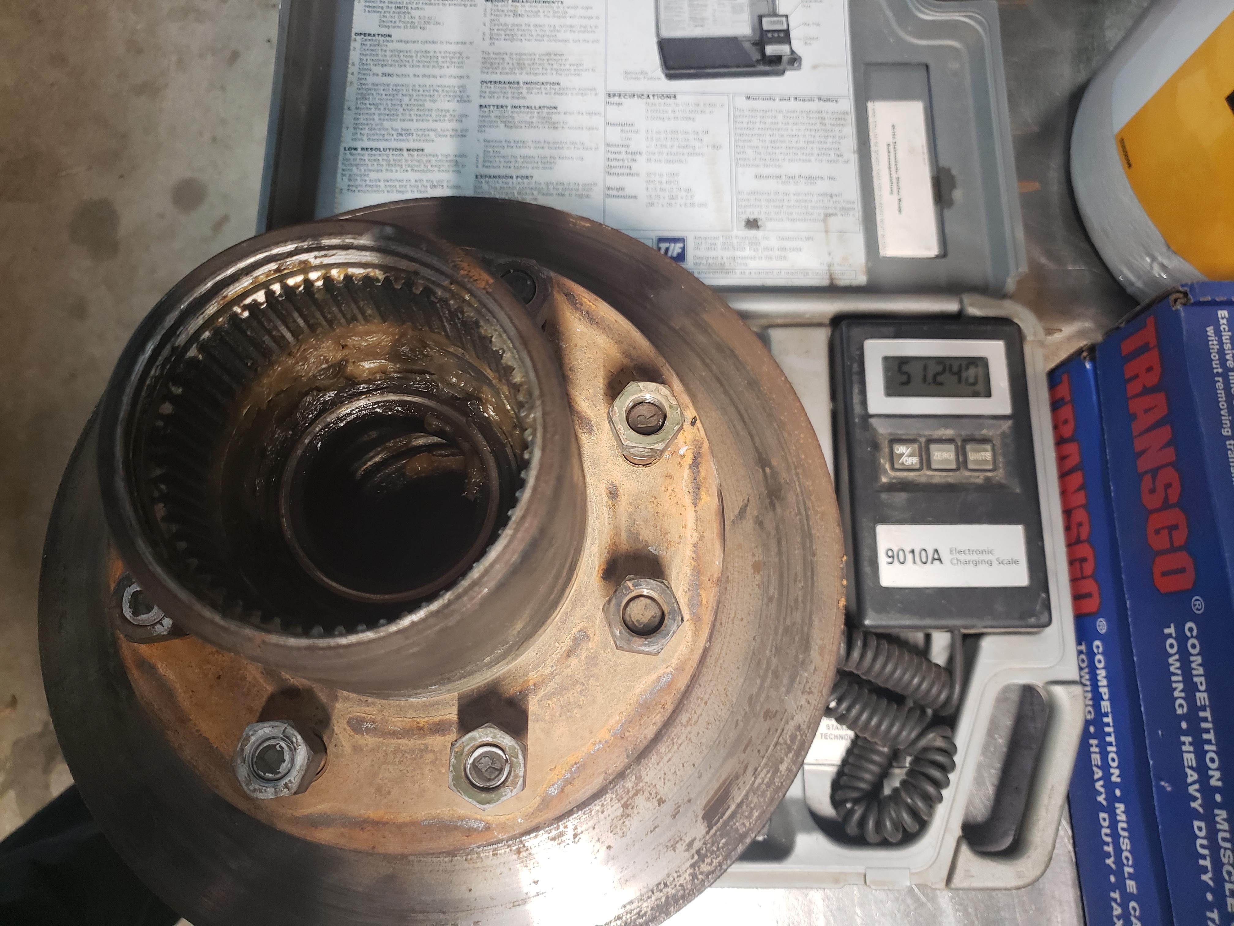

Hub, bearings, 1 ton rotor
= 51 lbs.
Eastcoastgearsupply lists a bare hub at 25 lbs plus 5lbs of bearings = roughly 30 lbs. 20191108_163355.jpg20191108_163422.jpg20191108_163451.jpg
After being able to weight both OEM 05 up Ford and GM kingpin 60 outers. I have to say I am surprised that they weight almost the exact same. There is miscellaneous hardware not included so keep that on mind.
Totals per side minus brakes and inner c's.
05 up Ford = 58.19 lbs
GM kingpin = 58.5 lbs
Never would have imagined it would be this close.
