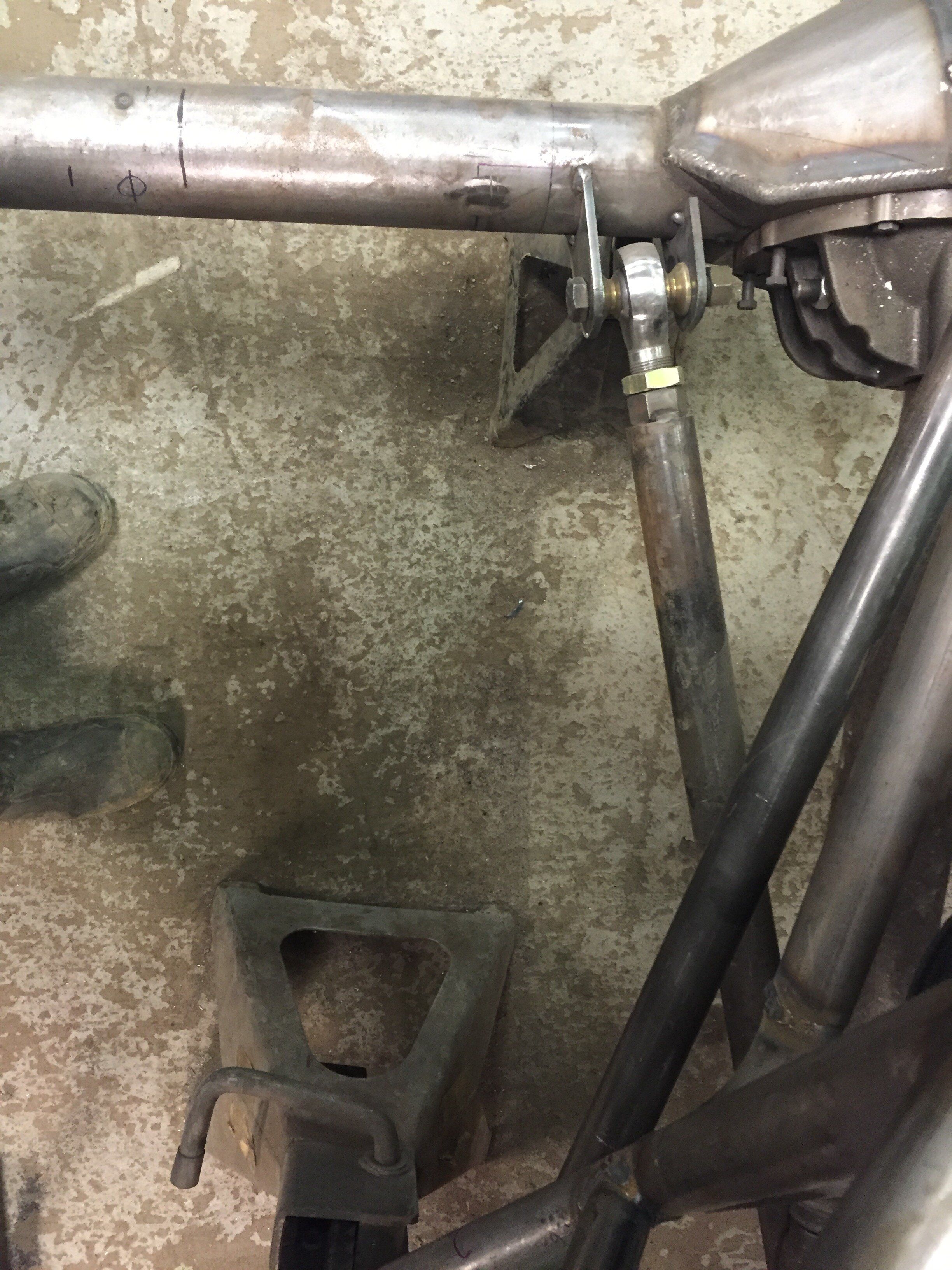

Won't more scrub radius throw the tire more towards the center of the vehicle when the wheel is turned all the way? It is in a buggy and the lower link is all that it would ever rub on, they are angled wider on the axle and narrower on the chassis. My over all goal is to keep the width as narrow as possible, while still main ting as much steering angle as possible.
This is looking from the top down, where the top and bottom links are the skinniest side to side is 17" back from the center of the axle housing and 27-1/2" between the two points side to side. I am going to run one of 2 tires at this point, either a set of 42 Boggers or a set of 40" Treps.

Links are already done and mounted, just trying to figure out where to cut the axle tubes to set the Wms and what back spacing wheels to get.
