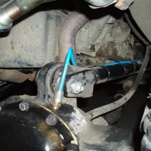

Biggest thing will the stroke of the ram work for your application. Toyota is a 6" stroke, I'm not sure what a dana 35 or 44 is.
Re: Re: Will trail gear full hydro work on a cj7
They make 6, 8, &10.
44 is 6inch stroke. D60 is 8inch stroke rock wells are 10 inch. General rule of thumb
Re: Re: Re: Will trail gear full hydro work on a cj7
It's all according to how long your steering arms are from the knuckle pivot point.
This. I'm confident I could use an 8" ram on my Toyota front due to how long my hi steer arms are. But less turning, means less binding, even with birfs, and I'm too cheap to make the swap. molaugh
I've used 8" rams on the last 2 Toyotas I built. One had custom top/bottom double sheer steering arms and the other uses the stock low steer arm and another arm welded to the knuckle for double shear.

I've never used a Trail gear orbital, I've always used open center - non reactive Eaton-Charlynn or Sauer-Danfoss valves, but the trail gear ram and pump I used have been great for years.
My TG full hydro kit worked awesome on the toy axles and the TG pump turns my summit machine ram perfectly.
Does anyone have a link or part number for a orbital I need for a Toyota? I don't want a return to center. And do I need to go with a 8" ram with a Tacoma width rock assault housing with 6 shooters? Sorry for the thread jack.

How many turns lock to lock do you want?
easleycrawler said:
Umm, damn. Wasn't expecting that question. :dunno:
And what ram will you be using?
Email me at the email in my sig and I'll send you a handy excel spreadsheet that me and patoyee made up for hyd steering setup comparison
