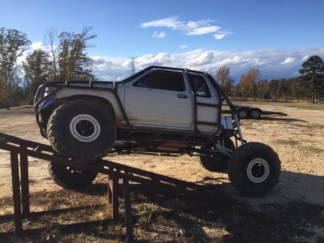

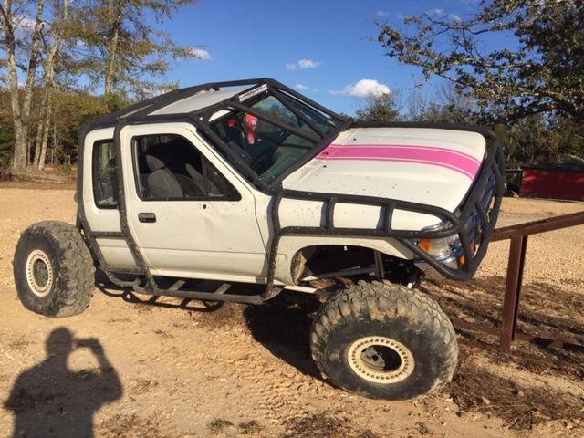

1990 Toyota extended cab & frame, full interior with bucket seats, 2" cam lock safety harness, monster tach, oil pressure and water temp gauges, grant steering wheel, factory tilt steering column, TCI Outlaw shifter, twin sticks, all four link front & rear, ¾" chromoly heims with bearings and Teflon injected, 16" travel Fox air shocks on rear & 14" King coil overs on front, full hydro steering with double end ram, steering cooler and fan. 2002 Chevy 4.3 V6, F.A.S.T. fuel injection, headers, 2 ½" exhaust, Flowmaster mufflers, aluminum radiator and thermostat controlled fan, all braided fuel line, full manual 350 turbo trans, TCI 10" convertor, trans cooler and fan, all braided trans lines, Toyota tcase with Marlin Crawlers 4.7:1 low gear & hardened input shaft, Toyota axels front and rear, 4.10 gears, welded both ends, Longfeild axels in front with 30 spline birfeilds & drive flanges. 38" TSL Swampers with Allied bead locks. Full tube cage (HREW tubing) LED light bar, LED headlights, LED tail & brake light, along with LED signal lights & LED rock lights, 200 watt Kenwood amp with ipod leads, Pioneer 4" dash speakers, Pioneer 6" x 9" rear speakers. Still tons of small things. I've got videos of it working & pictures of the build as I went. $13250. Text or leave voicemail @ 662-587-0034 North MS.
