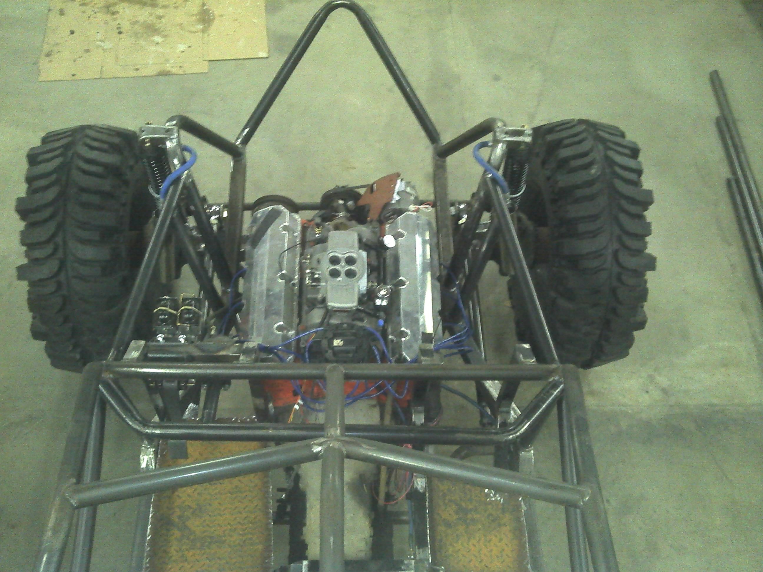

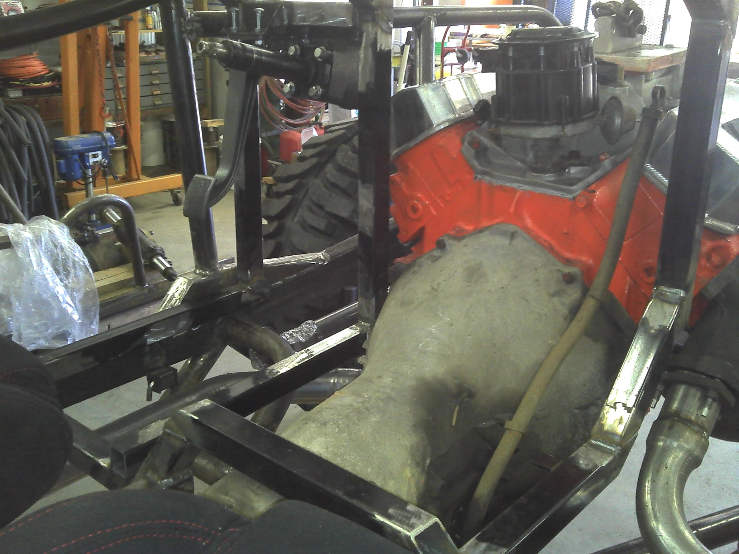

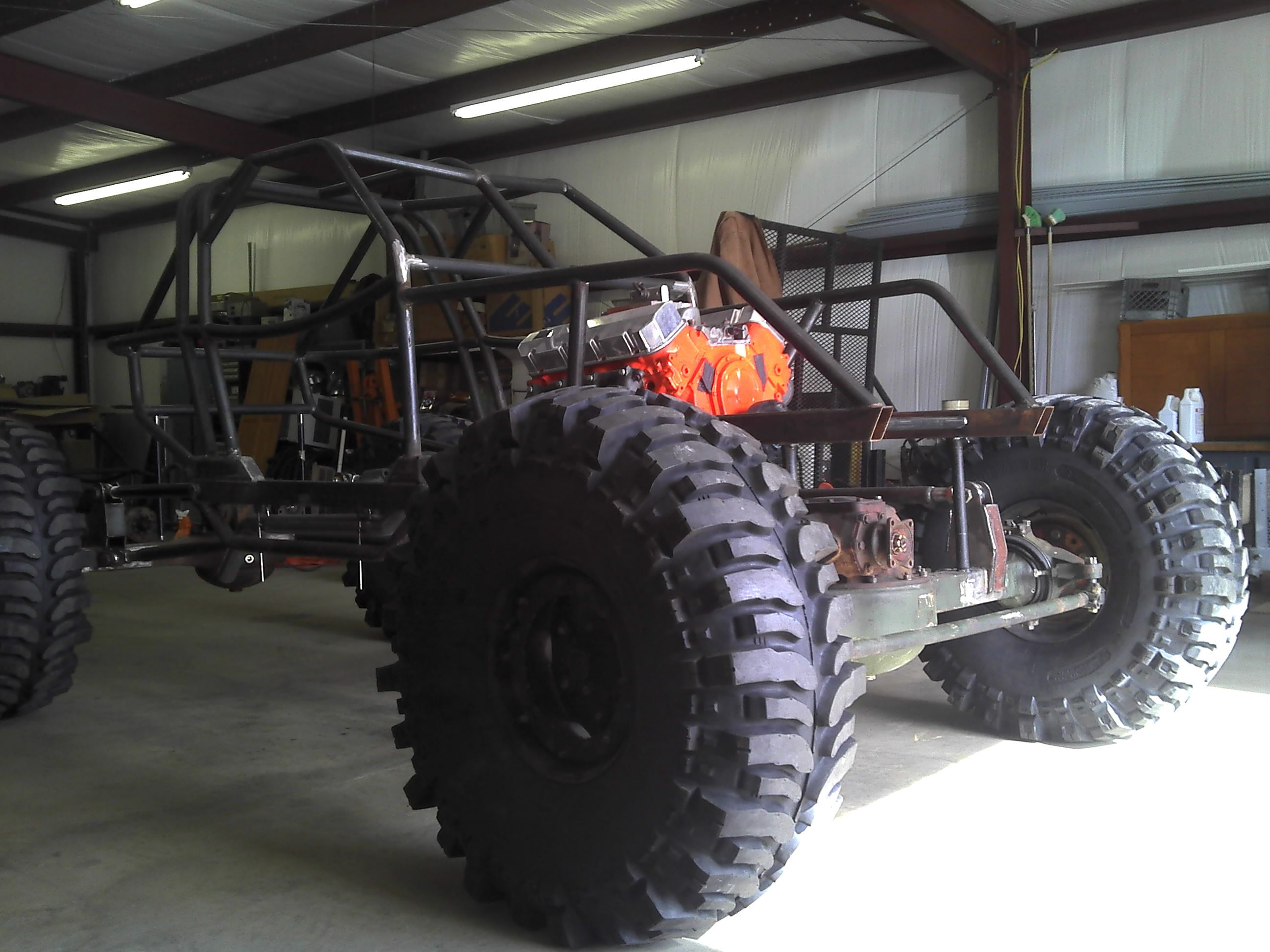

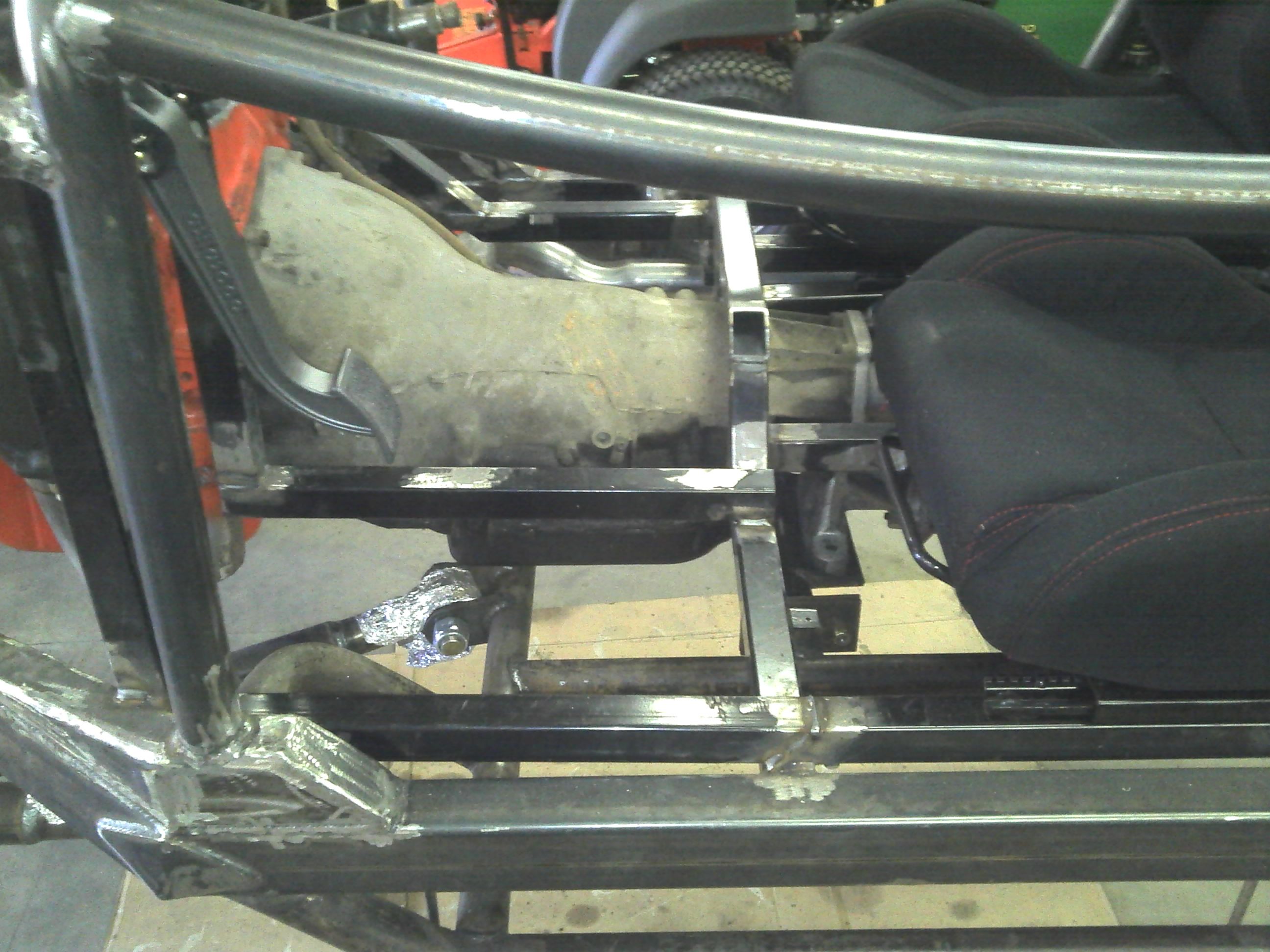

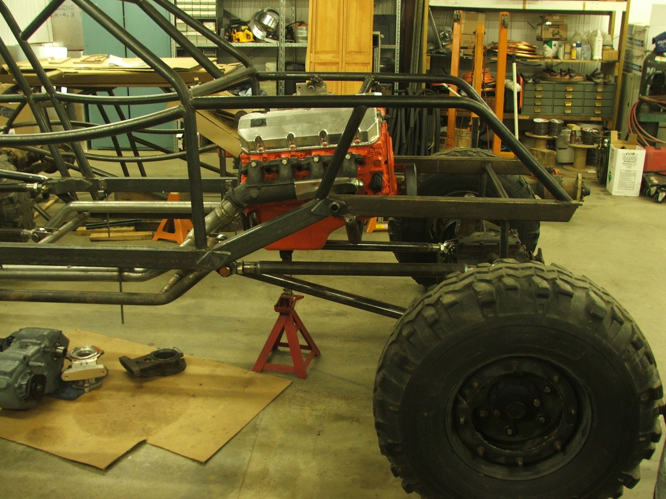

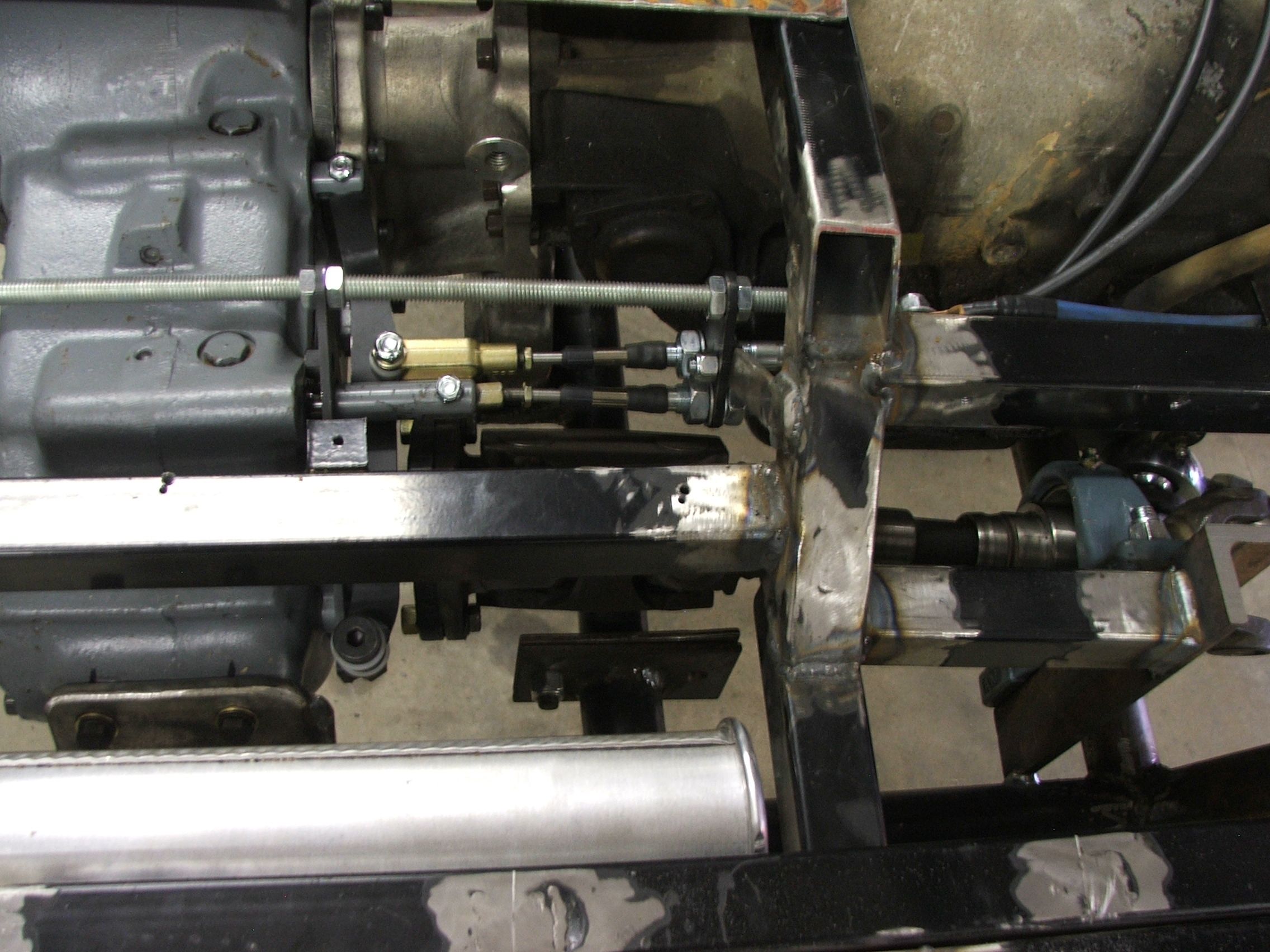

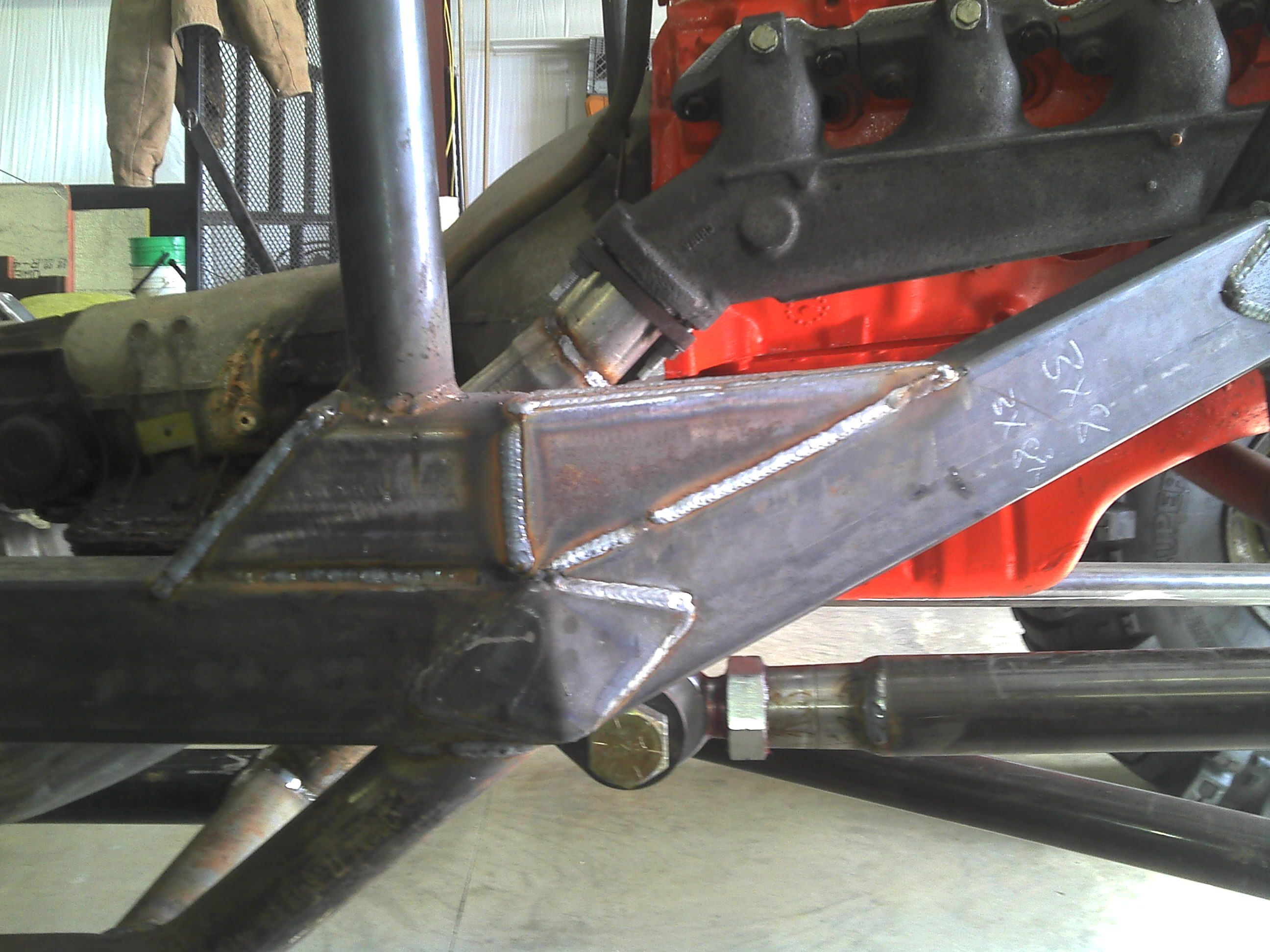

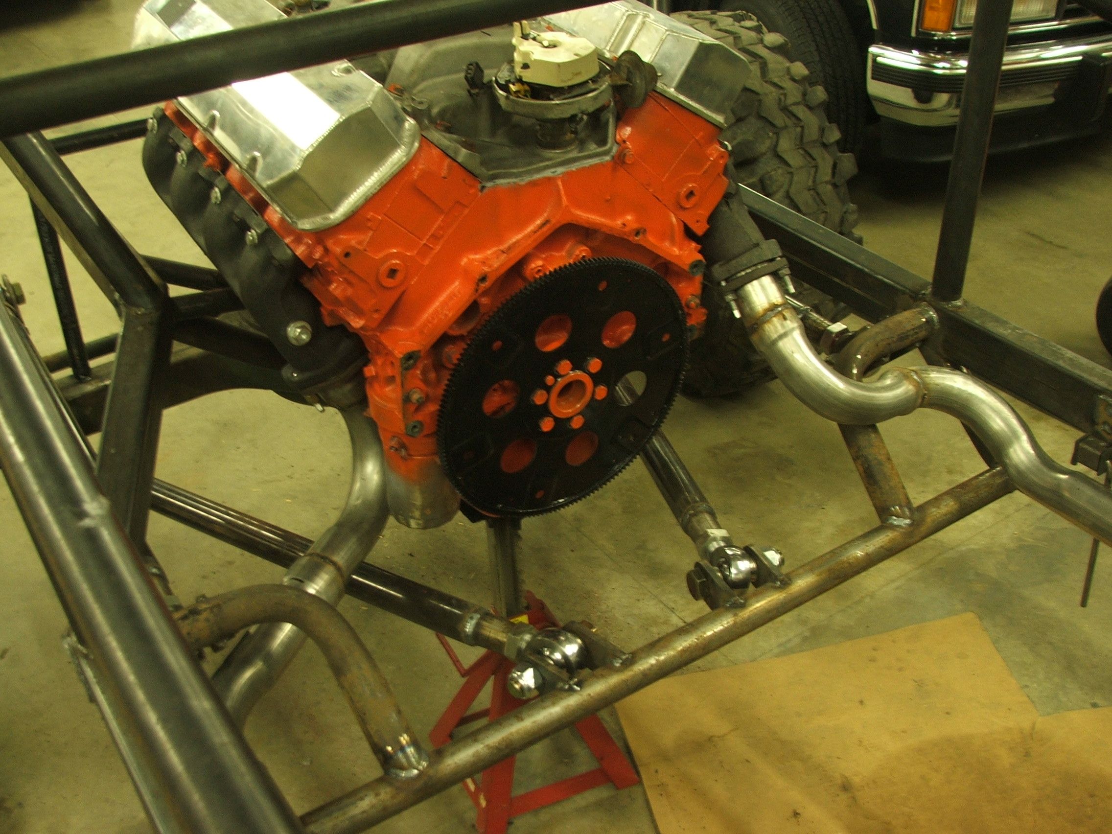

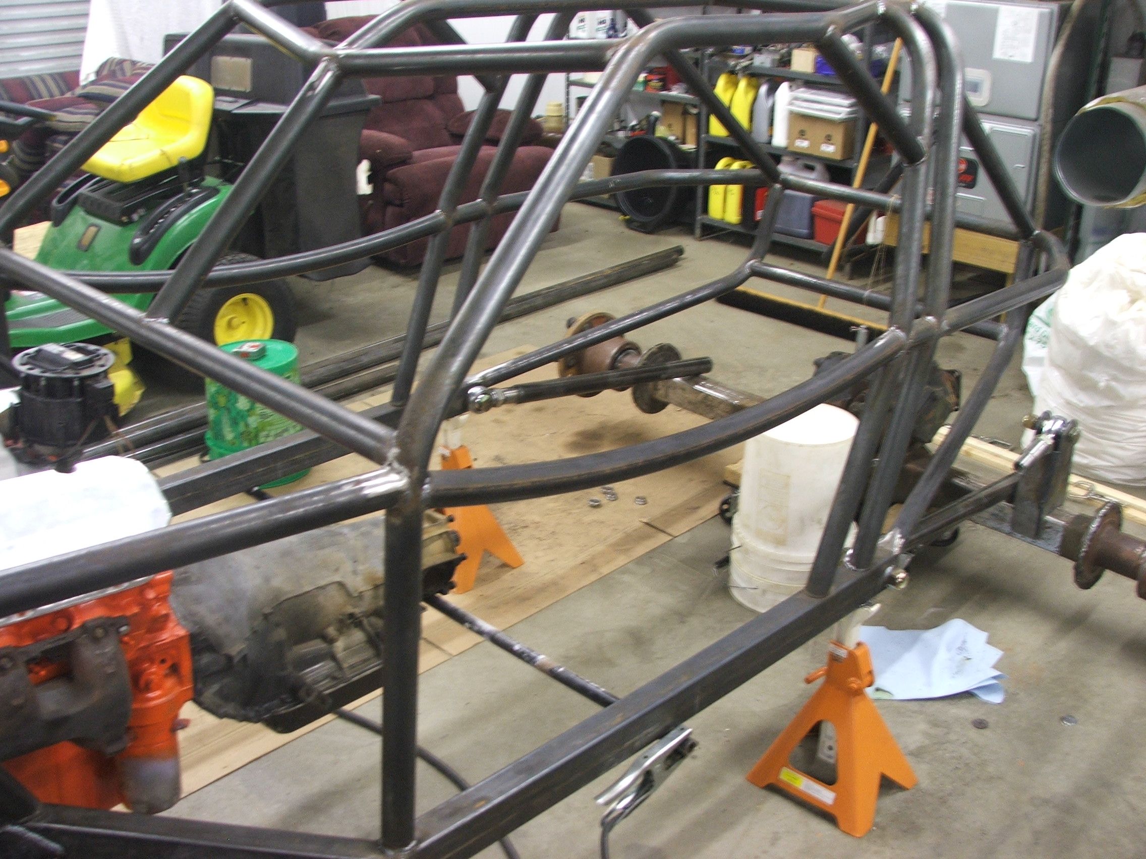

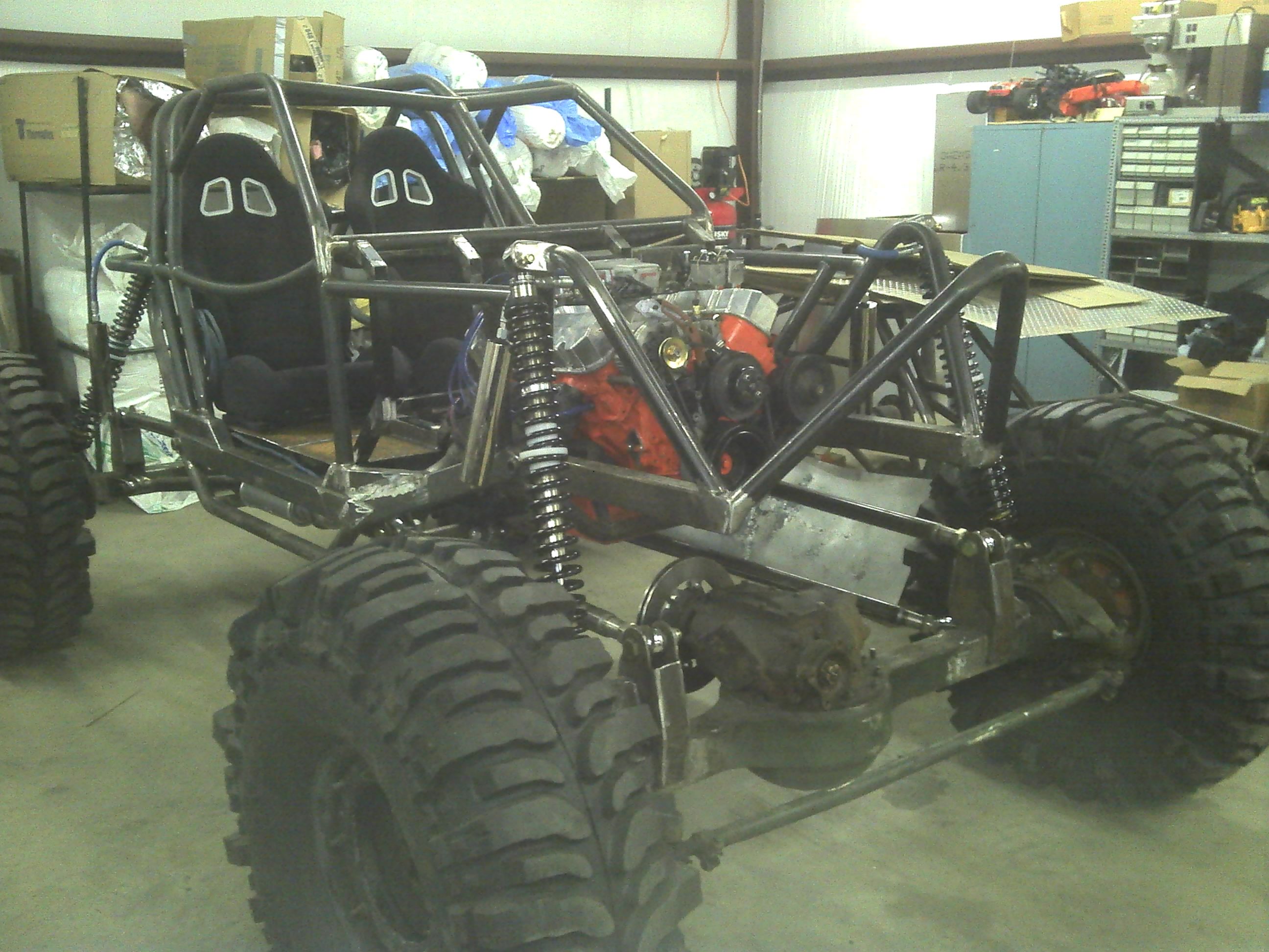

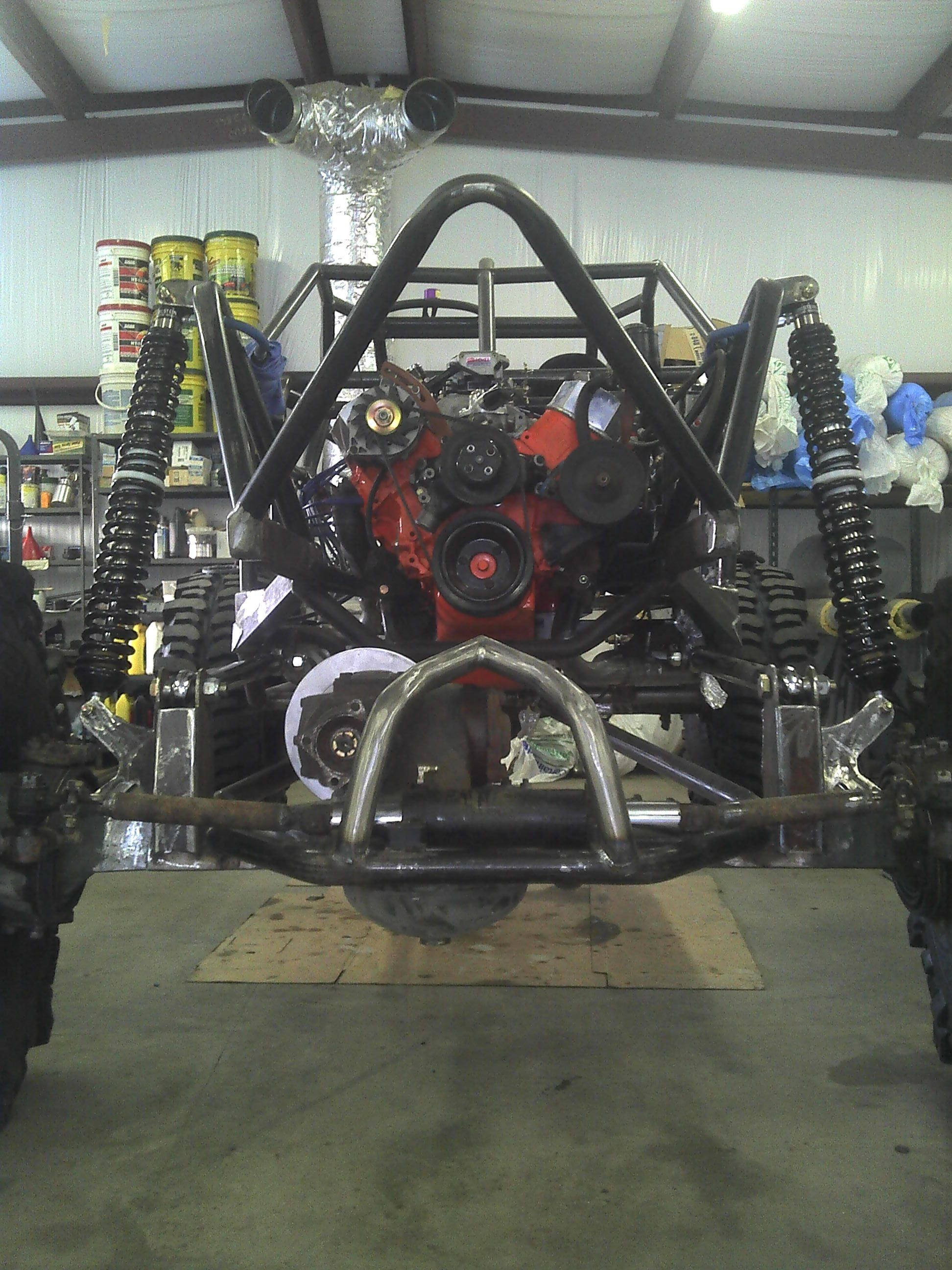

I am starting a thread on a build which is in progress. I will have to start uploading pics as soon as my dumb ass brings in my memory card.
EOR 321 Chassis (Jimmy Penner Special) :)
454 Big Block Chevy w/ Professional Products Pro-Jection
Th-400
NP-205 Twin Stickkkkked
Rockwells Detroit Locked Front, Lincoln Locked Rear
14 inch Bilstein Coilovers Front
16 inch Bilstein Coilovers Rear
Recentered H1 Rims w/ PVC inserts
All QA1 1 1/4 Heims with 1" Bolts (no small stuff here)
2" DOM .250 wall for link bars
44" Boogers ( yes I know they are actually "boggers" but i prefer boogers)
Some pics

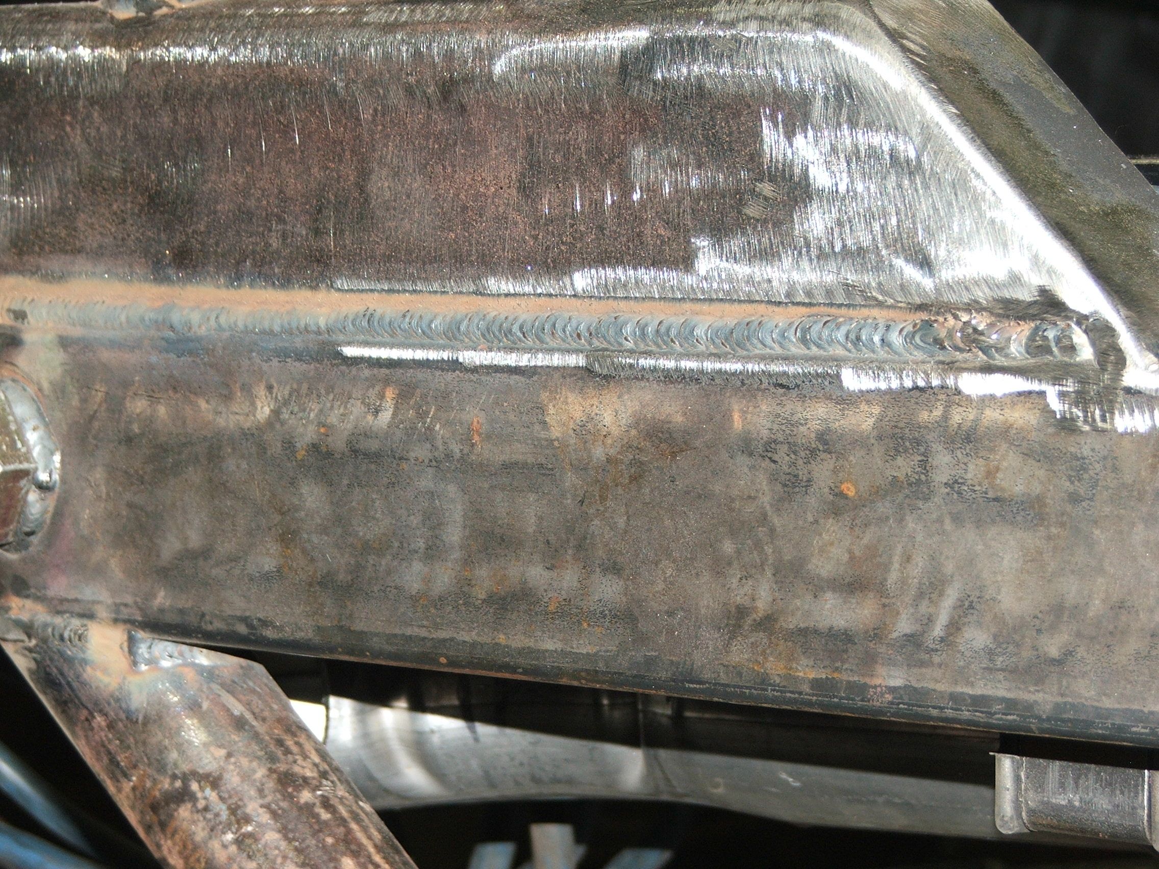

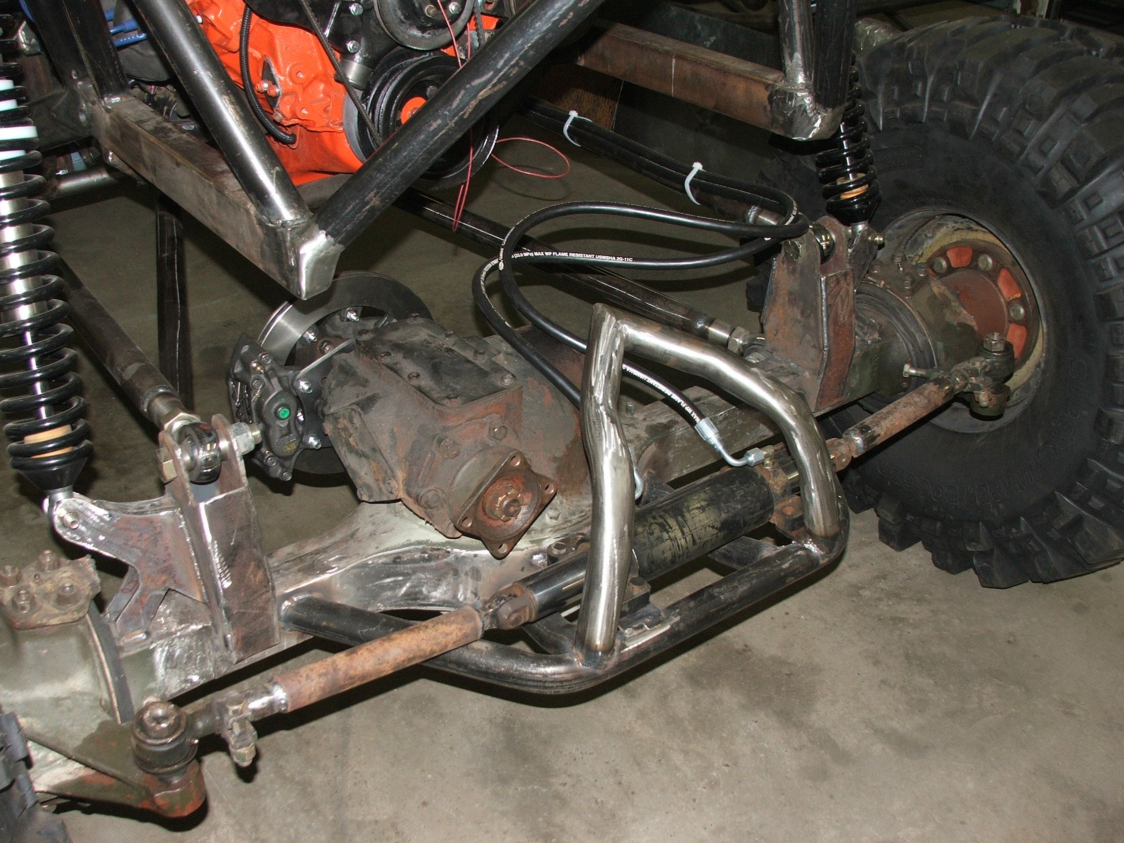

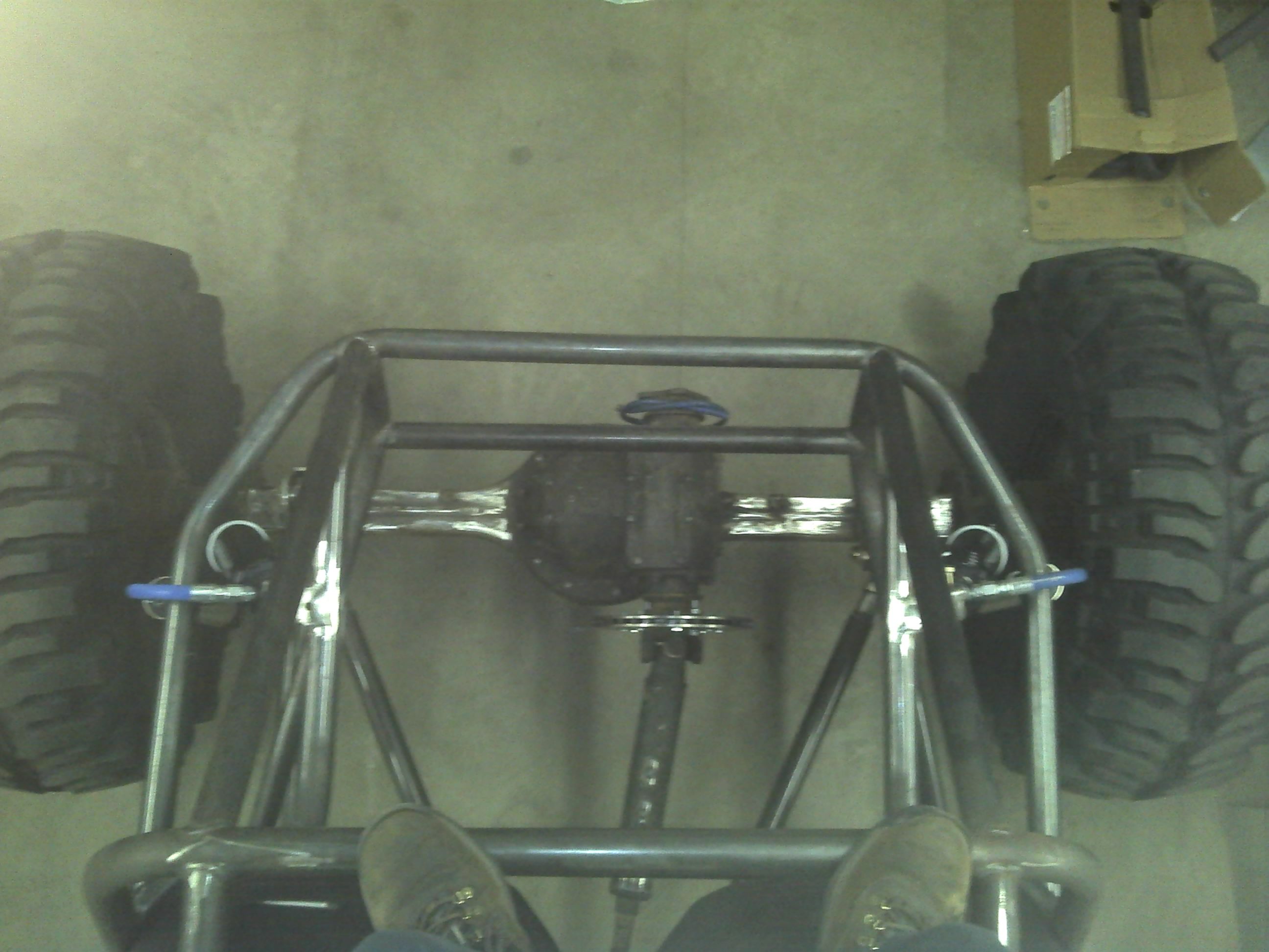

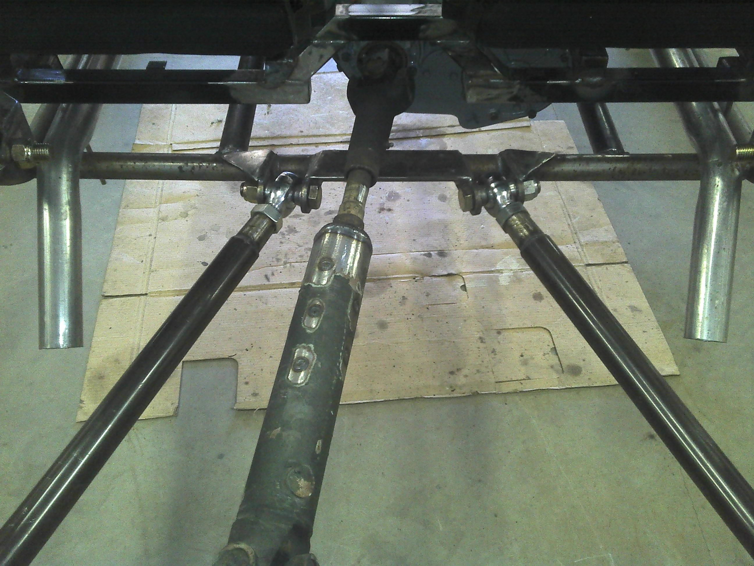

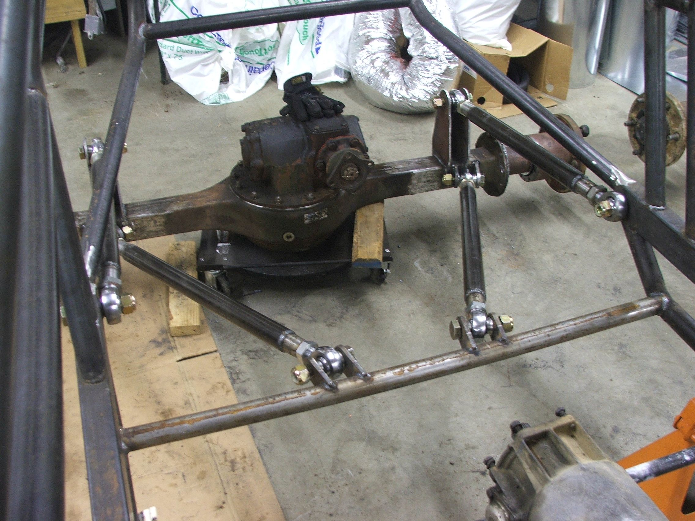

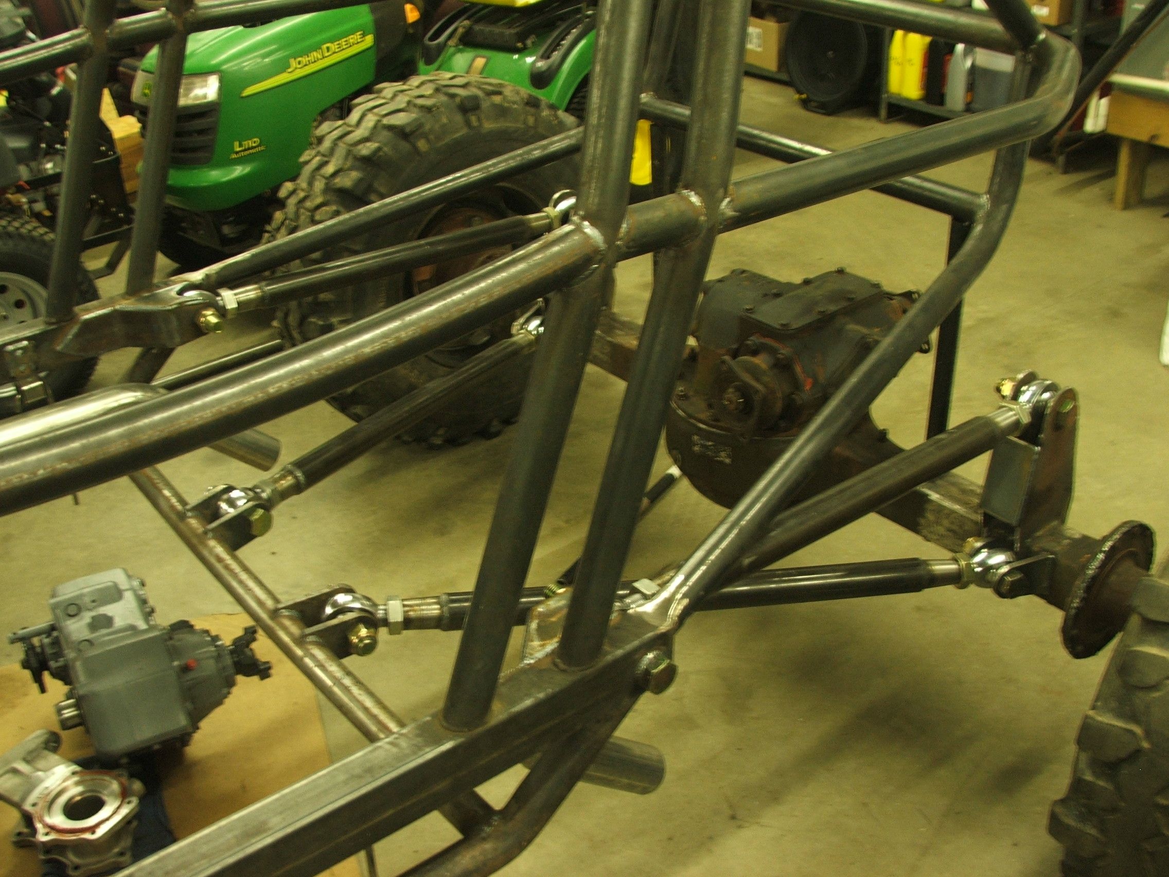

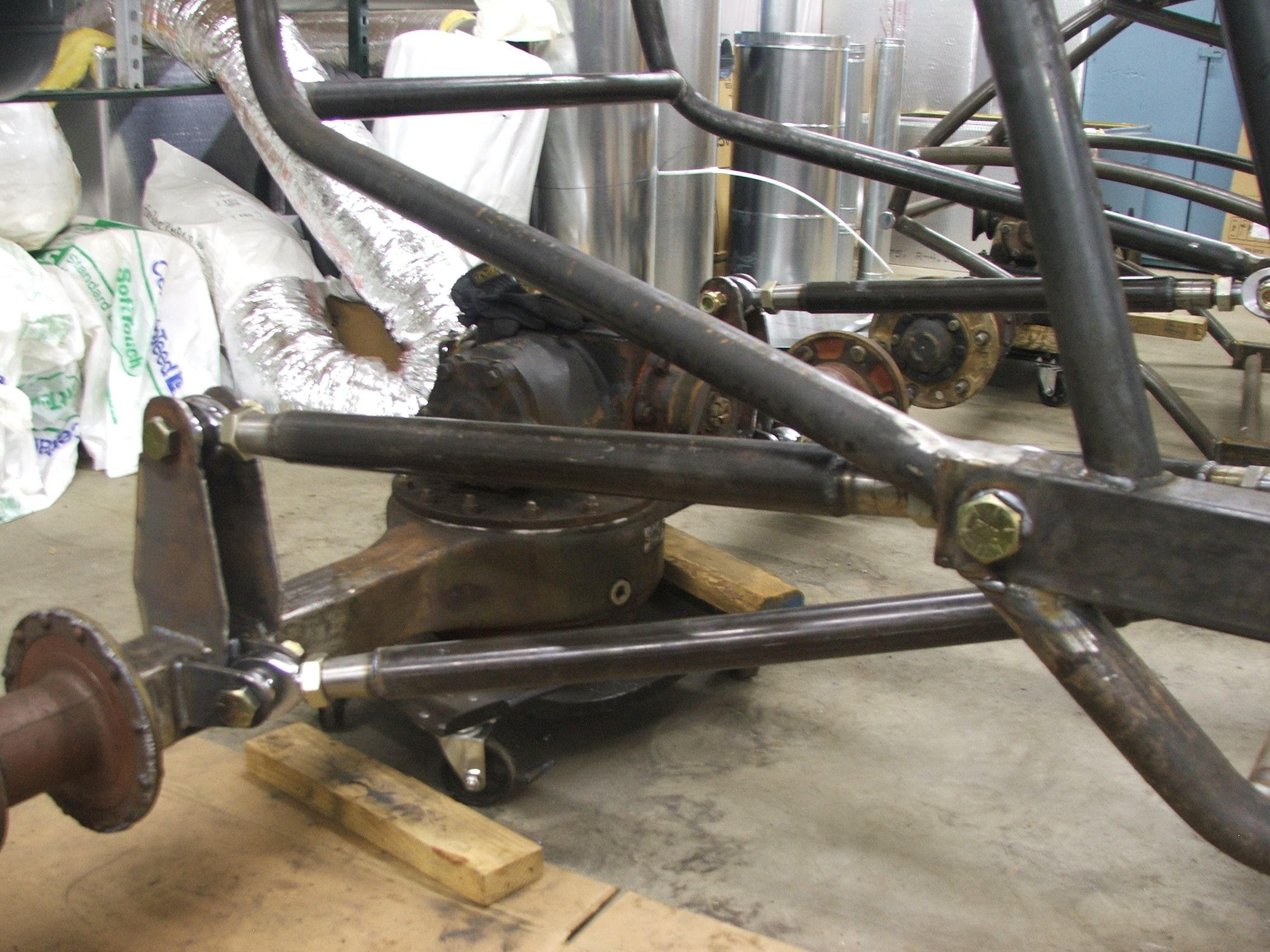

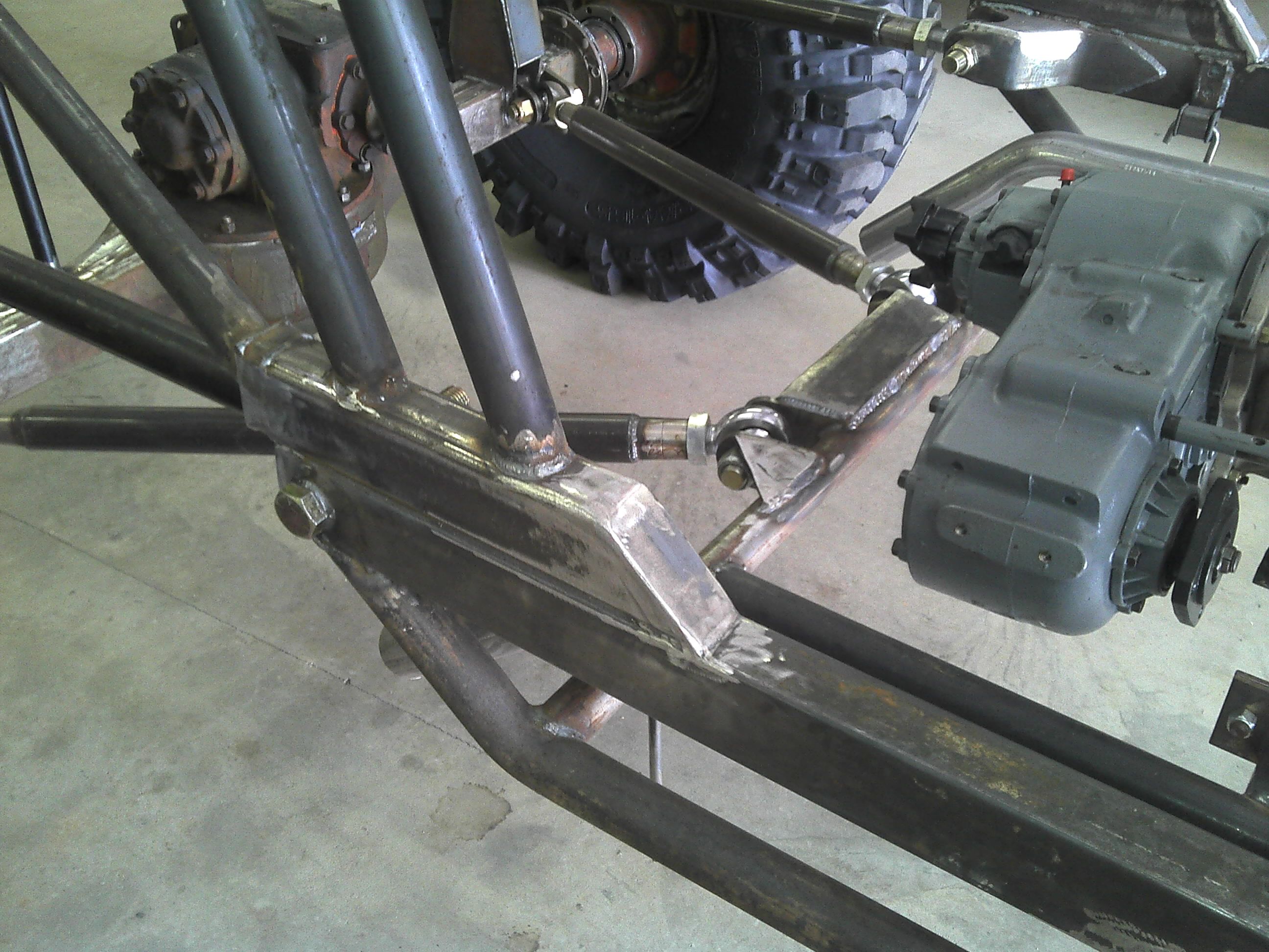

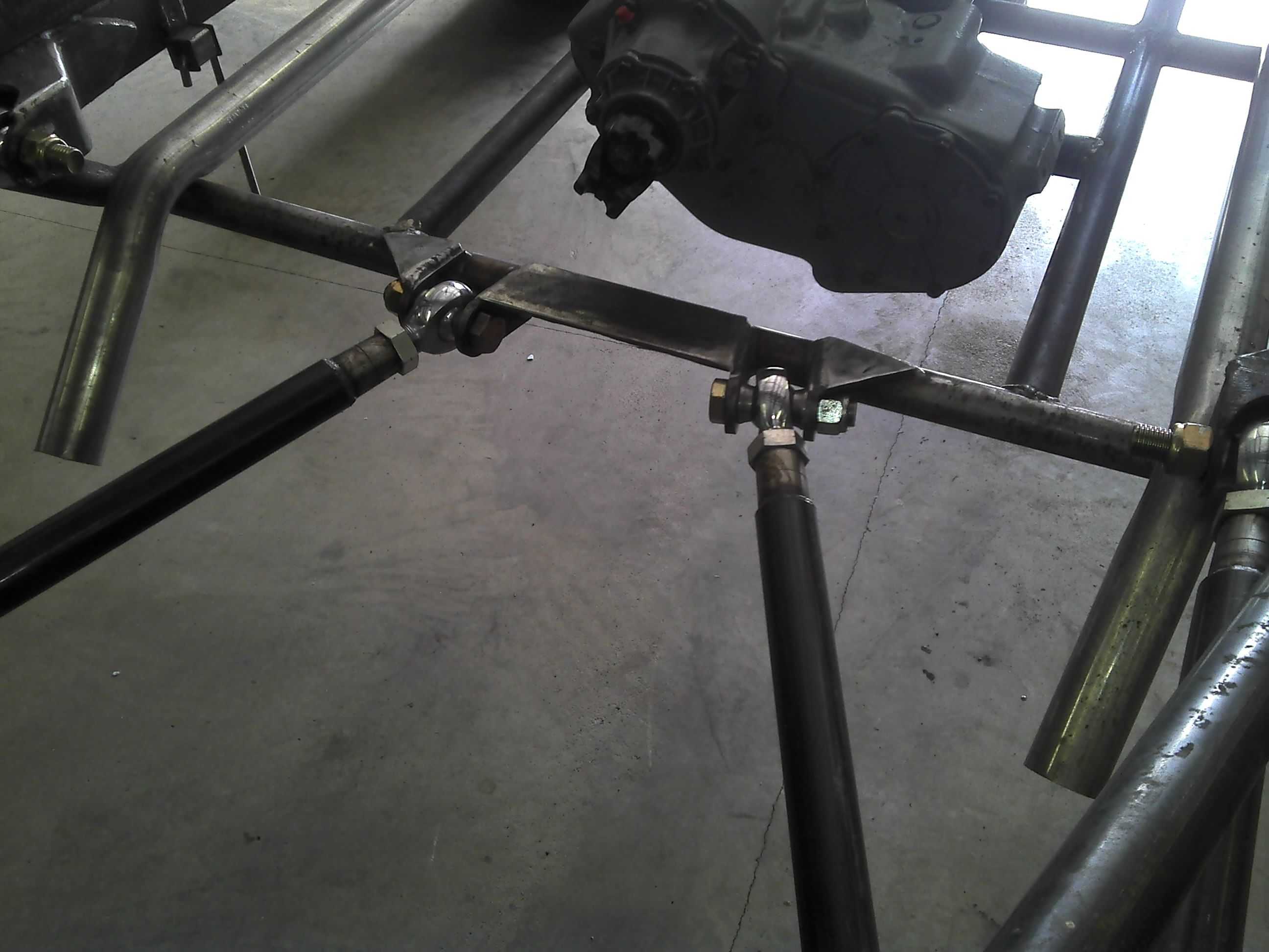

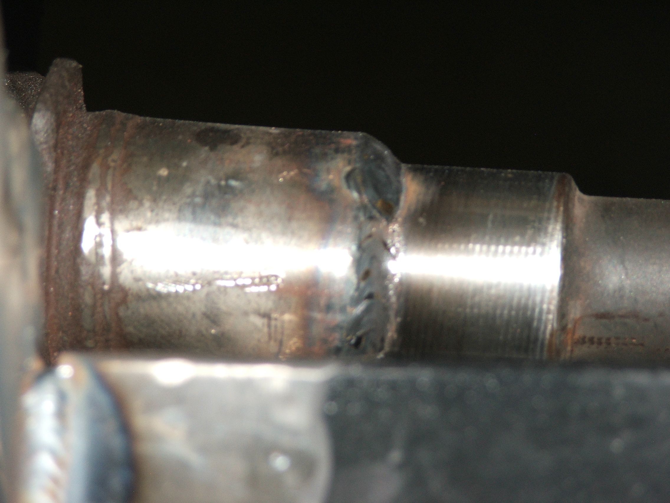

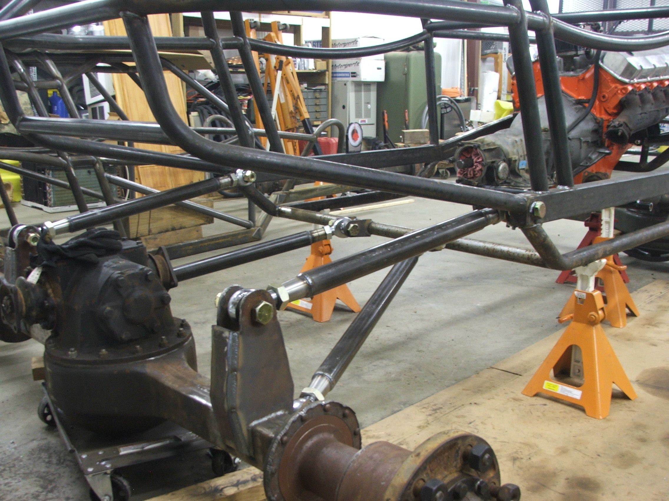

what link inserts are you using? They look a tad long after the link material.. i had to mod mine which looked similar
Man i was seriouly worried when i first saw your upper rear link mounts but then scrolled down and seen you did put them in a double shear. Looks good. thumb.gif
The link inserts are long but threaded all the way. They go into the pipe about 2". They save a little pipe due to the length. As far as the strength, these are the first that I have seen and we will put them to the test and tell about how they do. booyang
They look like the ones im using...
Although theyre threaded all the way they seemed a tad long
I turned mine up in my lathe...... and by lathe i mean vice and porta-band :dblthumb:
Sweet build by the way :dblthumb:
