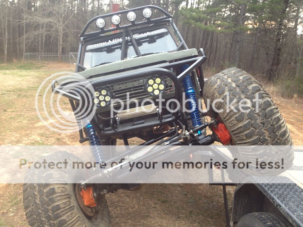

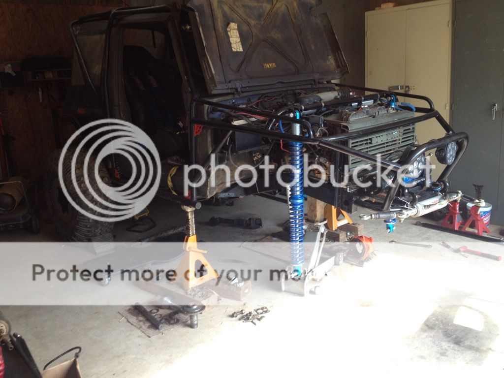

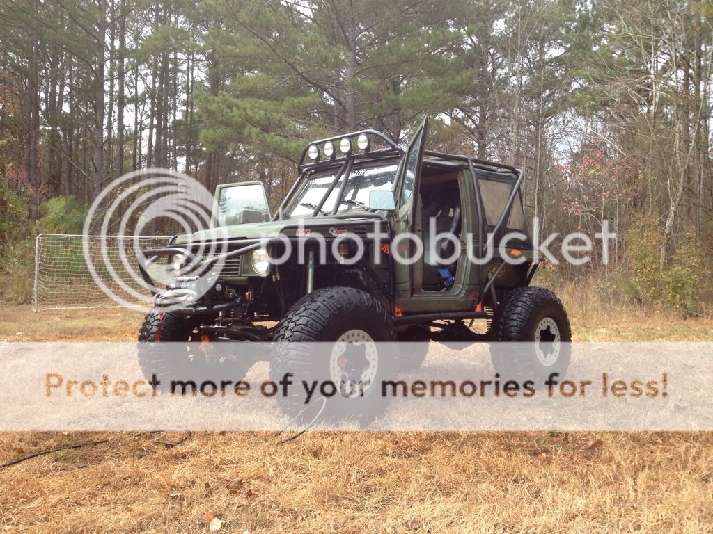

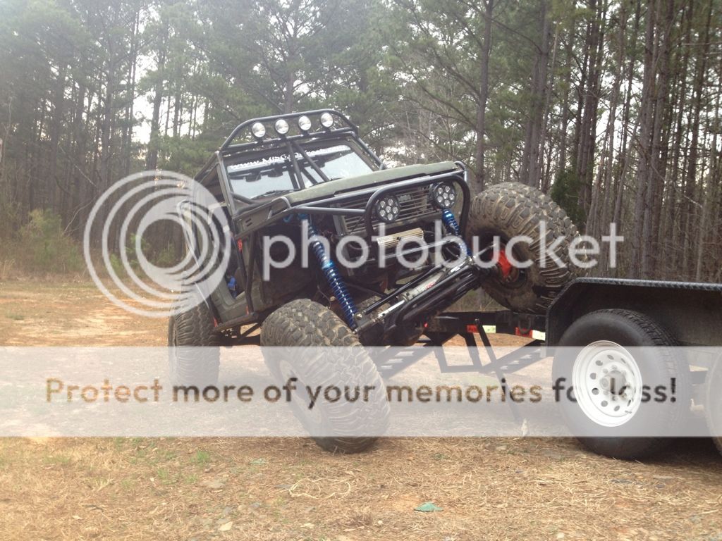

Long story short. Broke a radius arm on the front axle. So re-working the suspension to a true three link and going to coilovers. Wheelbase going to be around 106" also upgrading and changing some driveline gearing and mounting type. Gonna be hard to keep my 75% on the top link but will be within an inch or two. First time building a link set-up but most of the hard work is done, ask any questions comments or guidance or make fun of my bucket o **** samurai but i like it and it makes me happy. You wont offend me its okay, i'm not in the sport to make you happy :****:

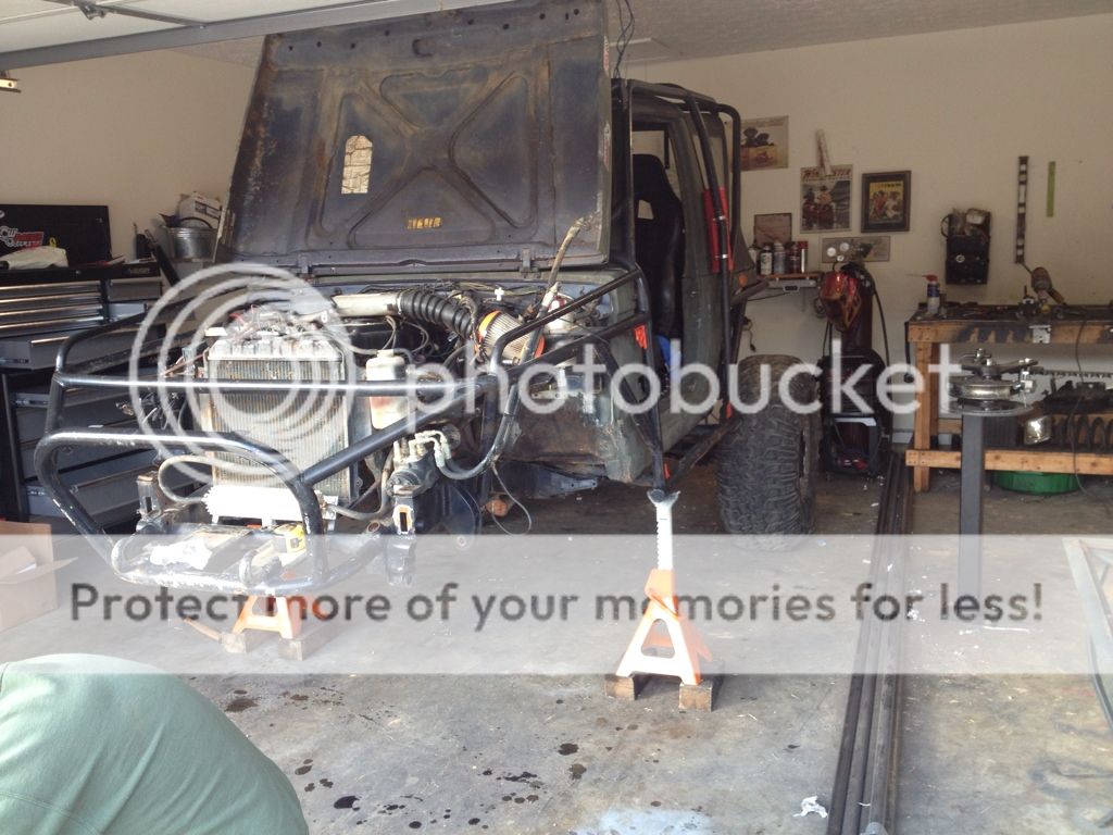

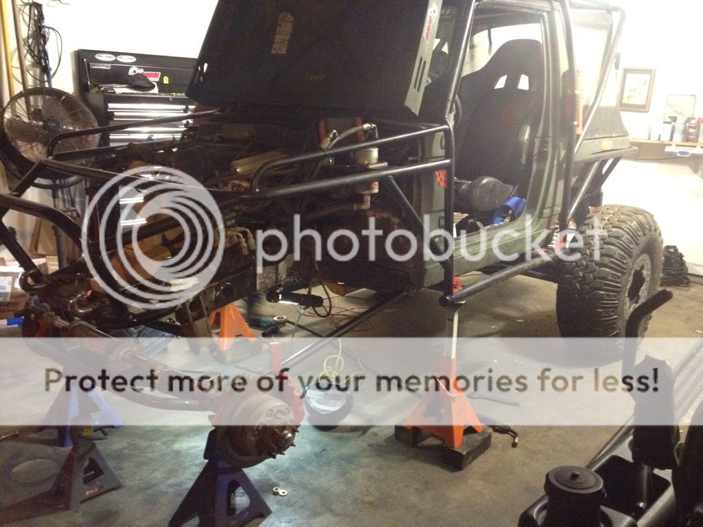

Anyhow lets get to the pics some of the first ones will be of it pre tear down and some of the new parts going on.

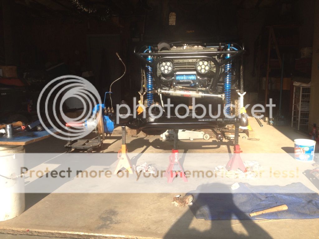

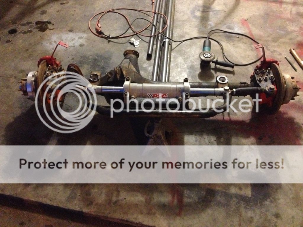

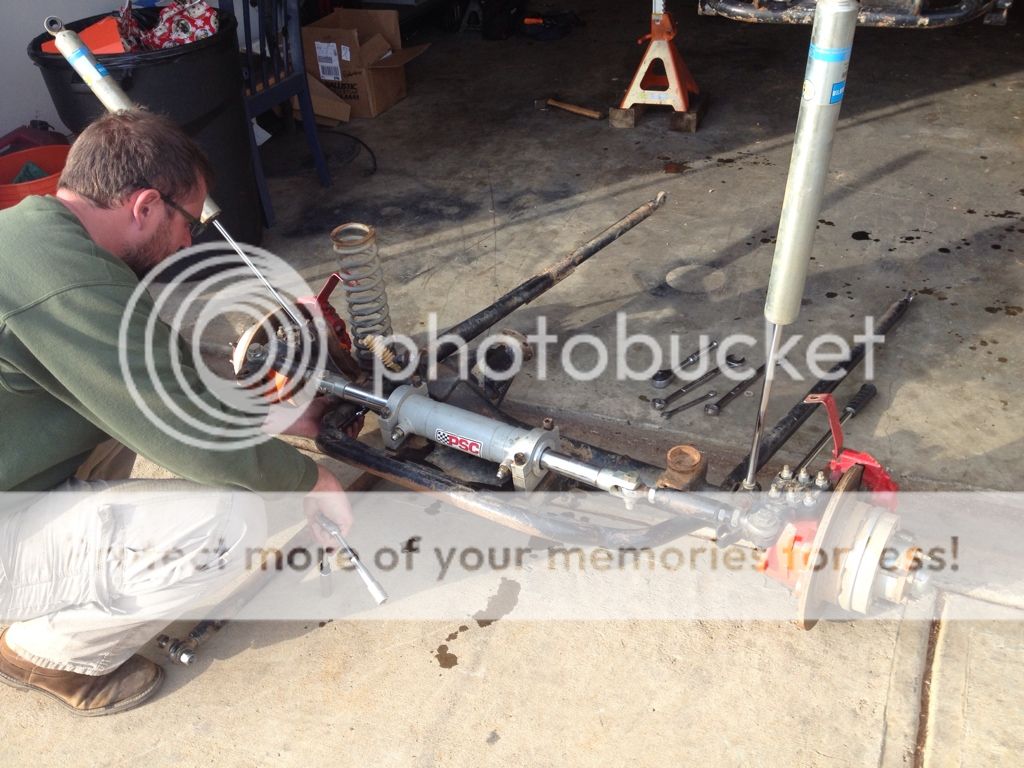

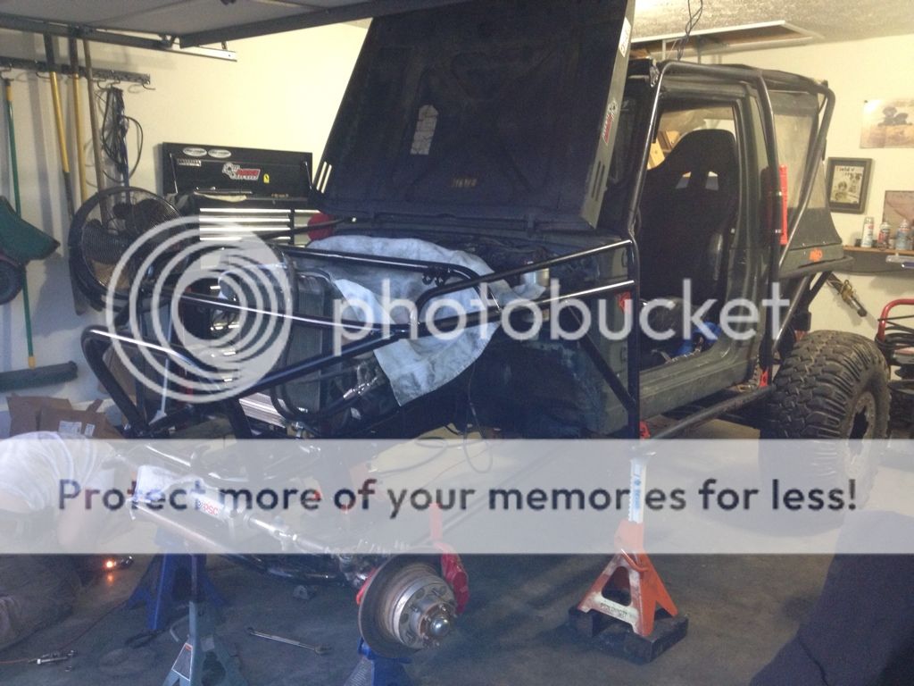

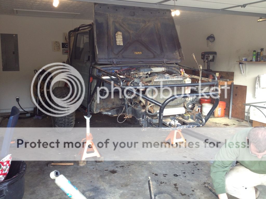

Ok now for tear down and build up

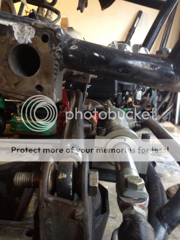

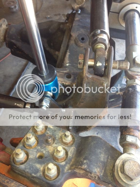

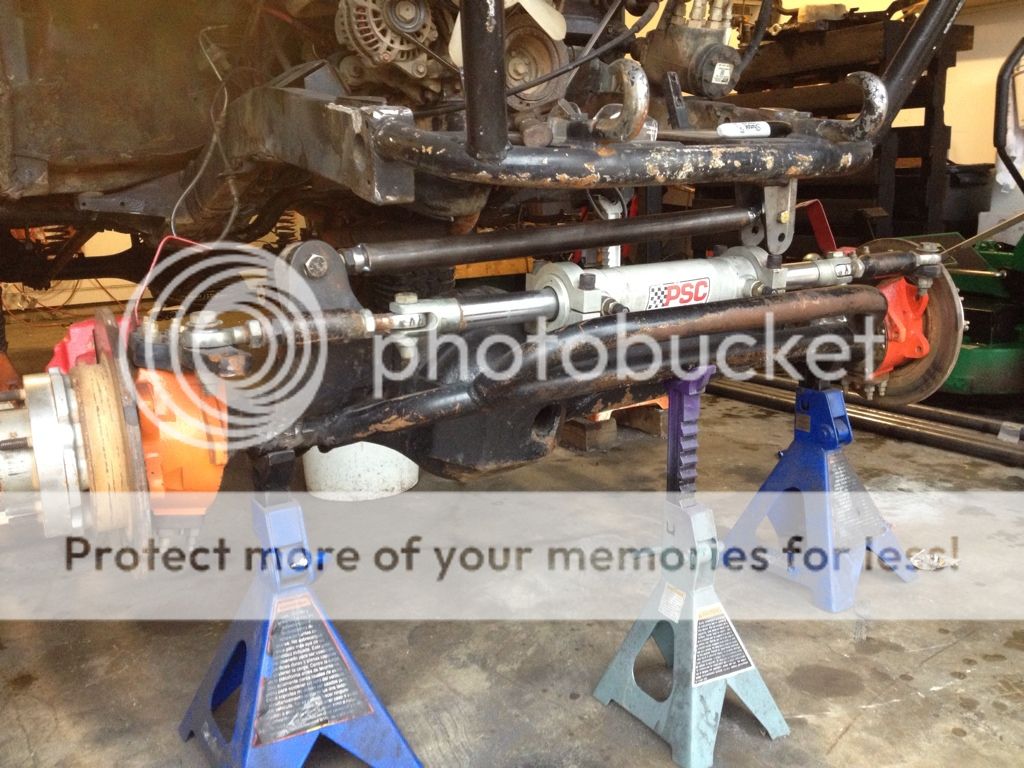

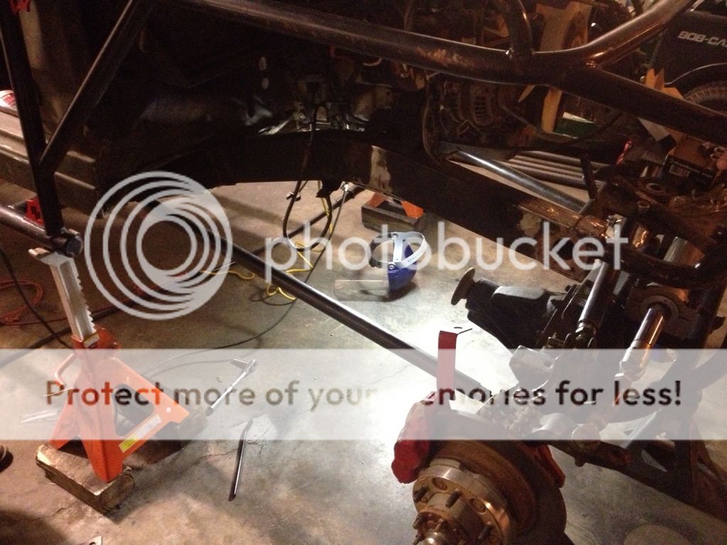

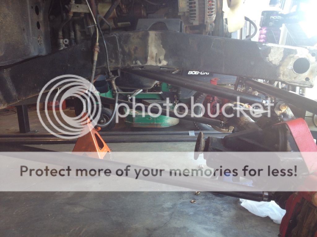

New panhard tac'd in. The last panhard hit the top link so we are changing tabs and will have a inch or so of clearance and it also hit the rear of the ram mount so we fixed that also. Will probably have to cut the frame diagonally and box it in for clearance. Bought some 1/4" plate. Will probably rotate ram to locate hoses on the backside of the axle to re-use instead of buying new lines. Will also help keep them out of the way.
May also have to raise the front tube work up. It is sitting at ride height in pictures and will have about 5 1/2 inches uptravel with it where it is now.
Thats why we used the top hole in panhard because its only about 3-4" from axle and we are going to chop it down for more travel.
