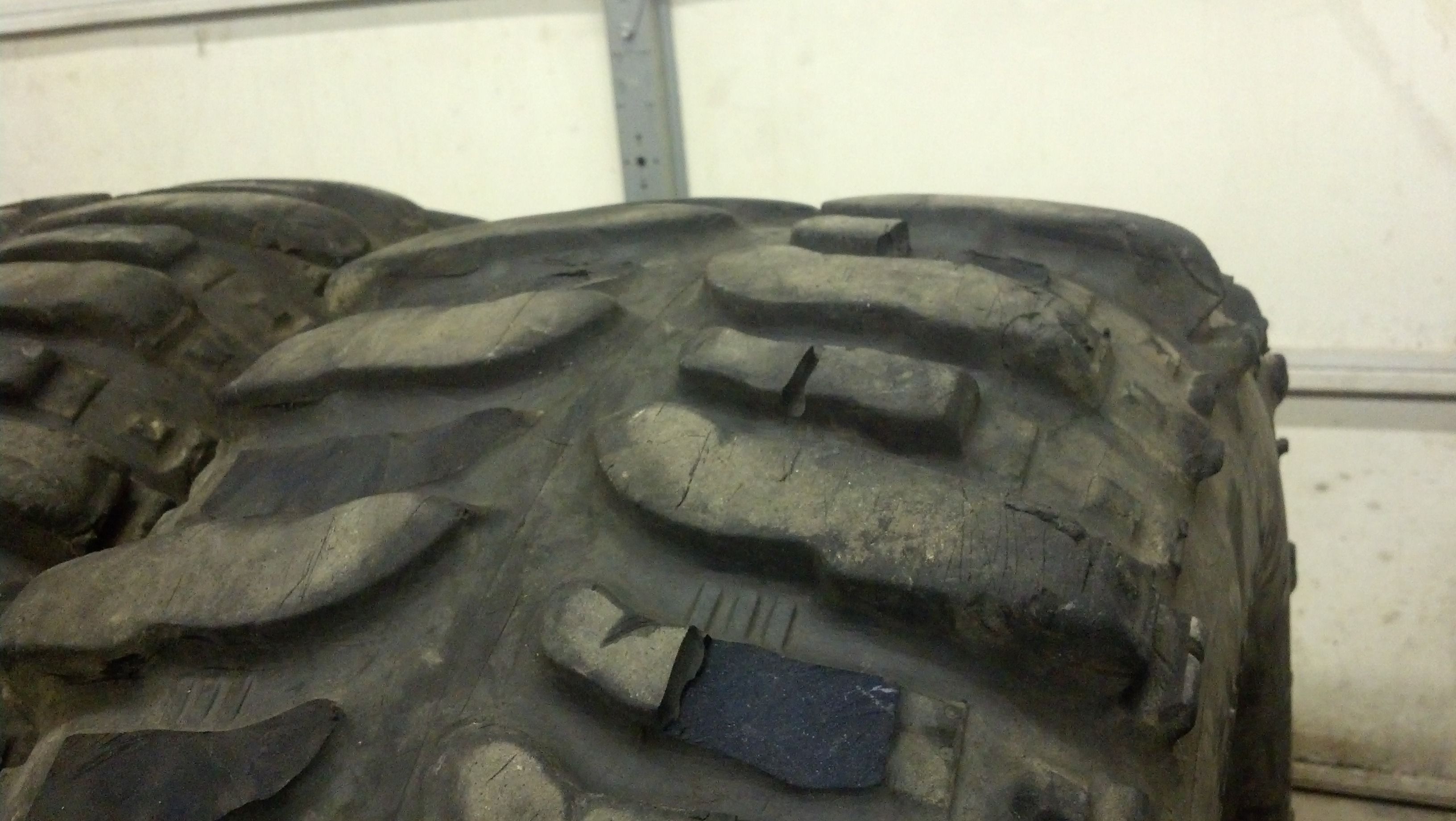

I cut these SX with a wood chisel and a bottle torch. Trick that that is getting your heat right so it cuts but doesn't burn/smoke. I found that I could normally cut 2-3 1/2 tread before re-heating.
I split the blocks first, then lopped the block off.
On the boggers I used the osciallating tool to cut tread
