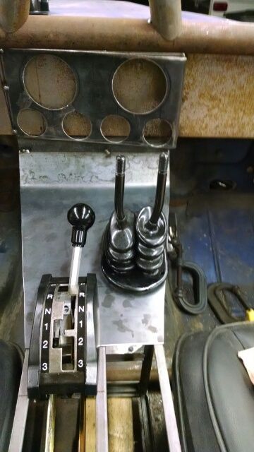

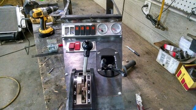

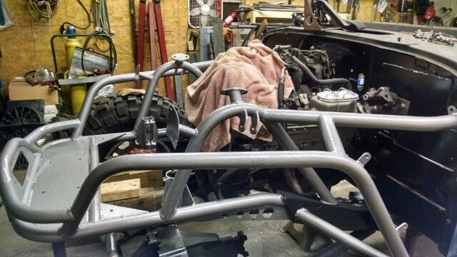

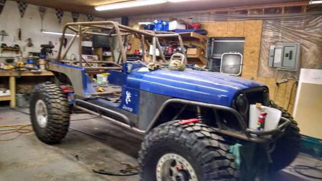

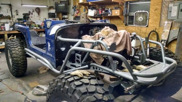

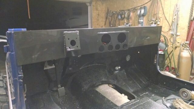

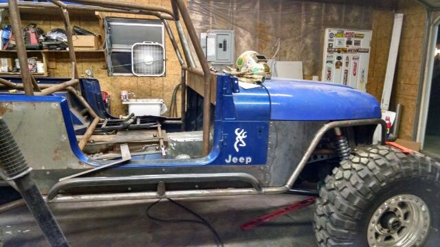

I bought this jeep as a project already started from Cubby on here and I changed a few things with the cage and frame. I wanted a rig that would be a little more family friendly than my buggy I had before. It startede as a YJ but I swaped it over to a CJ hood and grill. Specs- 6.0 LQ9, TH400, 3.0 Atlas with cable shifters, HP 60 front, 5.38 gears, lockrite, Yukon shafts and joints, solid knuckles and high steer arms, rear Dana 60, 35 spline Yukon shafts, ARB, 5.38 gears, Hydroboost brakes, Full hydro steering with DE ram, 14 inch away a way remote res. Coilovers, air bumps front and rear, trail ready beadlocks and 39 inch Reds. This is where I'm at so far and I hope to be finished by RBD. Pics are kinda ****ty because I dont have a lot of room in my shop.
