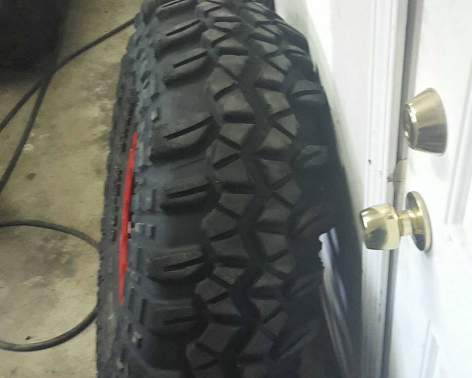

I'm looking to groove my 44" tsl's. I'm going to get an ideal groover with probably #6 or #8 blades. I'm not wanting to go full blown dig tars (atena or tn). I'm wondering of the two styles shown is it worth the added time to do triangles vs straight across. Also if I do straight across I can always do tn cut later on.

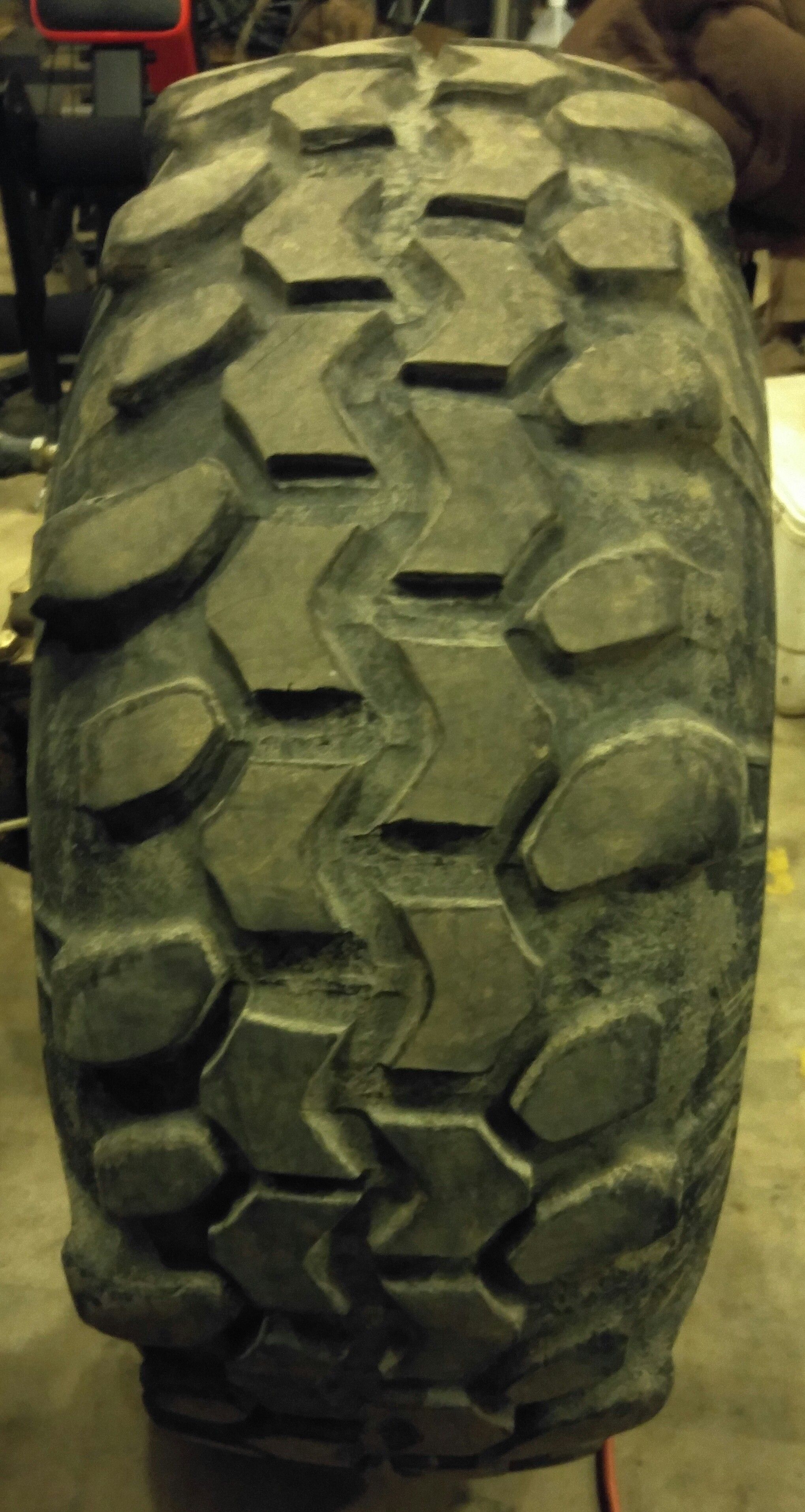

I actually prefer taking the material off the front and rear of the tread blocks rather than splitting them in half
That's how mine are cut. You can start with maybe a 1/2" cut on front and back, then as they wear, you can take 1/4 to 1/2 more out of the front. You can get quiet a bit of life out of them and keep a good leading edge.

I did both on my ol wore out Iroks. Cut the front and back of the lug off square to "sharpen" it (Iroks have that stupid little interlocking center tread pattern) and hit another groove between the treads because mine were so bald.
On some SXs and TSLs I've cut, basically I just cut the front of the lug back to a square block and removed the little raised sections that are in between the center tread (wear bars I guess).
Hell on a buddy's 36 TSLs, we cut them 3 times over the years "sharpening" them back up, till the center tread looked like they were TN cut and all the outer lugs were the same length molaugh

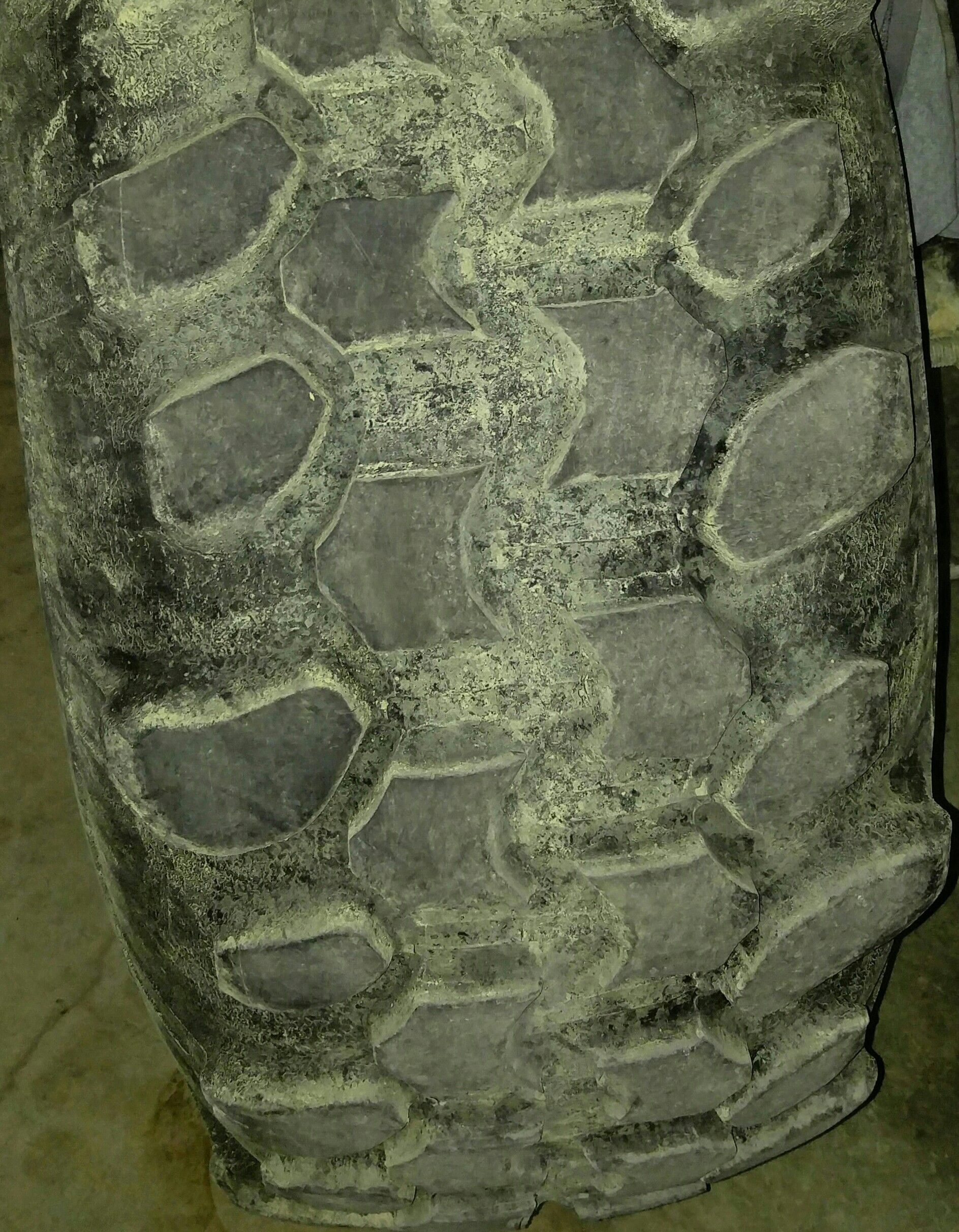

Thanks for the pics and suggestions. My tires are a older set and looking to loosen them up a bit and add more biting edges. The regular tsl just seems like the center packs up more easily than my old irocks.
Front hasn't been cut as much as the back.

I did my sx's like this. It definitely made a big difference. I think other grove patterns may make the tires flex better but this has made a huge difference in forward traction. Not that it matters but My opinion is that your first choice would give better forward traction and your second choice would help the tire flex better and be a balance between forward and lateral traction.
