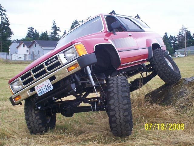

I traded my 14s for 12s, and shortened the hoops, it was the same TG kit. The shocks and brakelines are not maxed in this pic.
