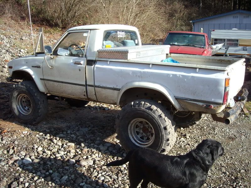

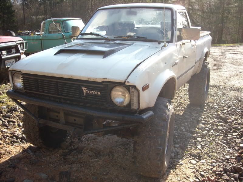

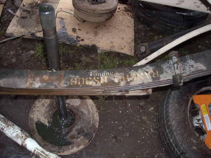

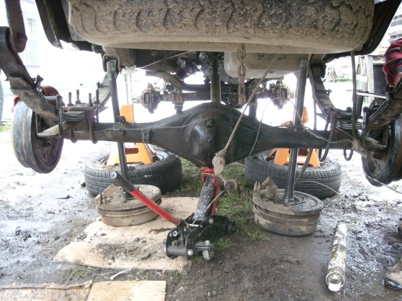

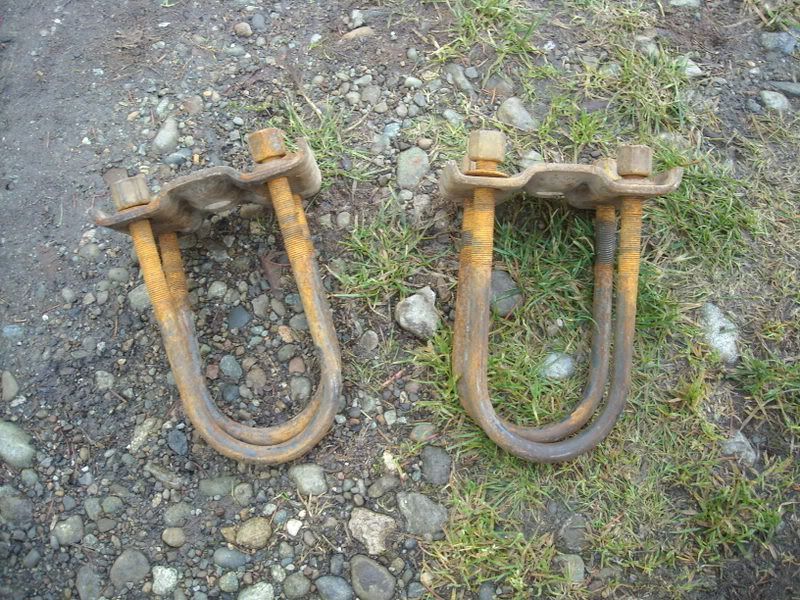

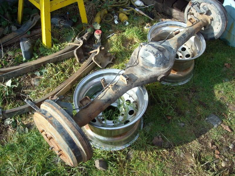

i bought this truck four years ago all stock with absolutely no mods, i put a back window and a fuel pump in it and drove it home, it has evolved slightly to a welded ifs rear with u-bolt flip on 3in springs and 1 1/2 shackles, 3in front springs and 2in shackles on 36in tls's header and weber on its fourth 20r with a fourspeed
