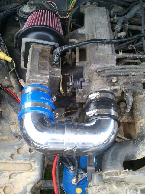

The stock EFI doesnt really have that many actual sensors, mainly the Air Flow Meter that is the the top of the airbox, of course you can remount it and put a cone filter on it if you want
Then you've got a knock sensor, temp sensor, throttle position sensor, O2 sensor, plus the computer controlled ignition/distributor, injectors, and the EFI fuel pump. The toyota efi system is really simple when you strip it down, and usually very easy to diagnose if there is a problem (which is not common)...
