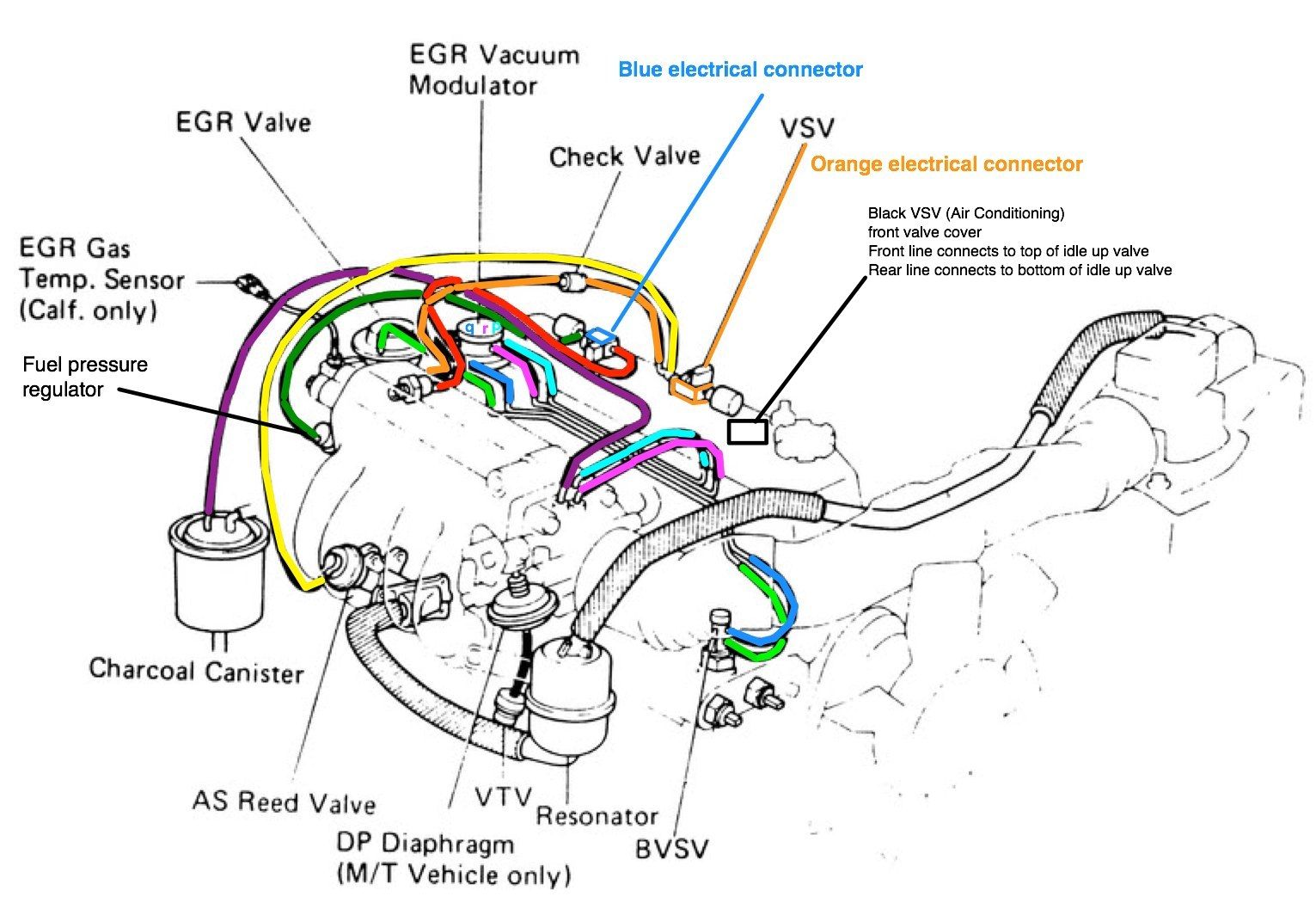

The only vac lines on the gremlin motor are fpr and charcoal canister purge.
This may or may not be the setup thats on your truck. You can find most vaccum diagrams on google images.
I found that one. Although, it was helpful, the three I had left over were on the backside of the motor. Couldnt really tell where they went. Ive got it all now though. Just waiting on the last couple parts to come in.
