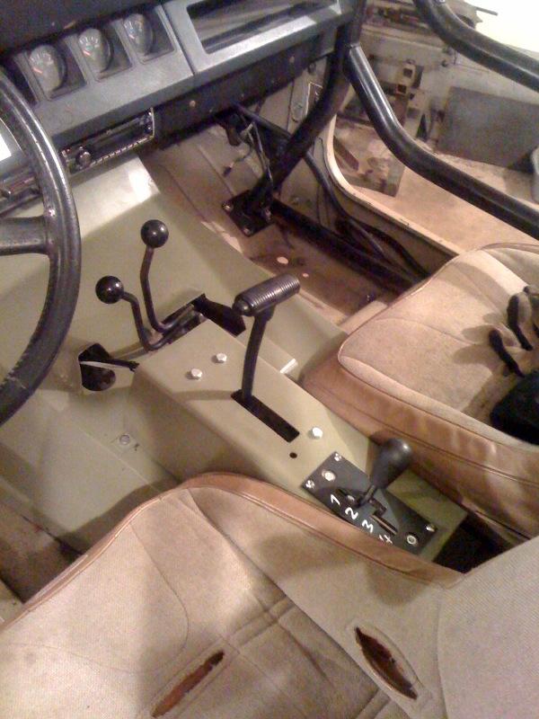

Console

This is the art carr/winters shifter with Rad Design switches to control the AW4.
I didn't want a separate shifter to shift from park to drive/reverse and a separate for 1-3. This fixes both
