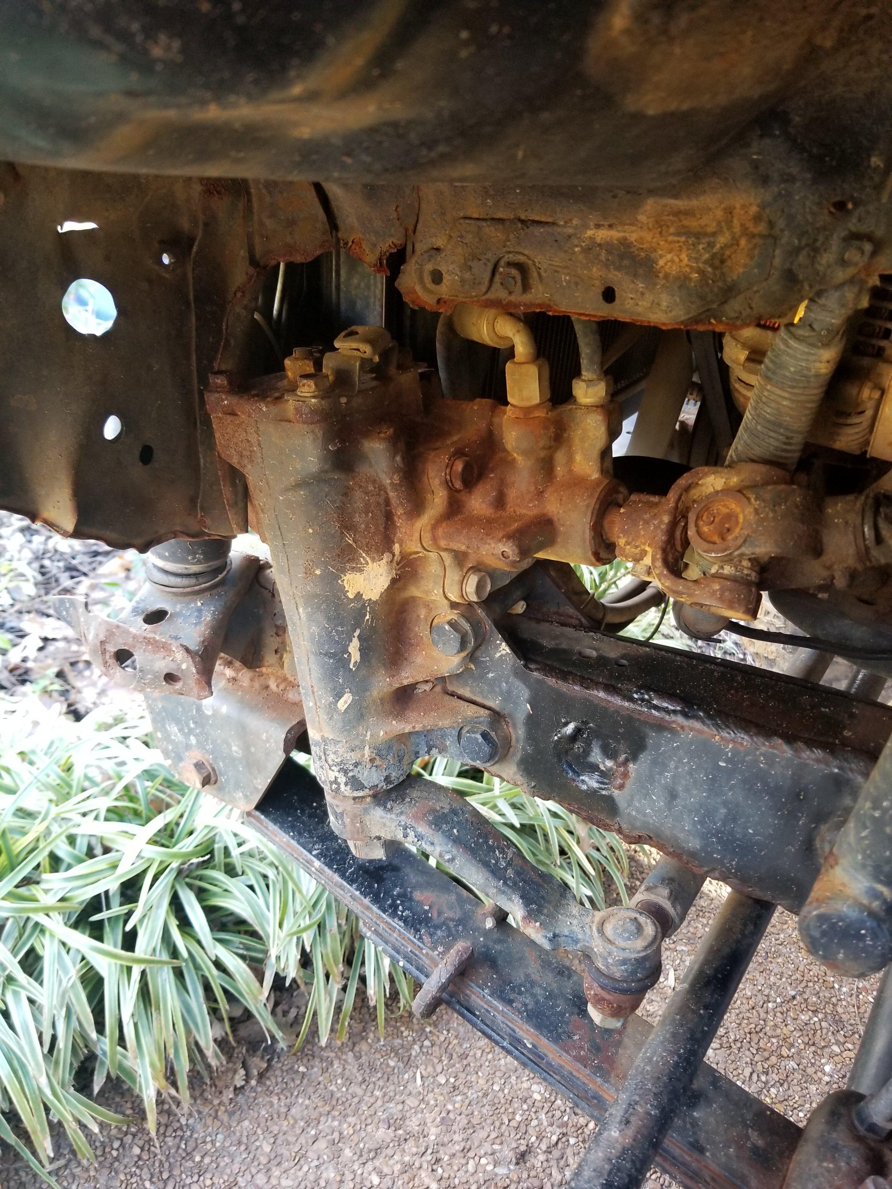

No plans yet. Everything is stock other than the axles. 97 taco with a dana 44 up front at the moment. Will run whatever I need to make it correct. If it's a little sluggish that will be ok, it's just going to be a trail ride with heat and ac but if I can make it faster by buying better parts I will. Want to keep it as simple as possible though.
does it have the standard ifs toyota steering box? (it obviously doesn't have stock tacoma steering if it's already got a d44 up front...)
That's what it has. Also new to the tacoma world.
yeah that's a regular ifs steering box (like 86-95 model).
