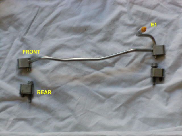

Crappy pic but....
Mine was like this. I hooked on to E1 in the pic then it all dumps into water pump

Ethann said:
I think this is the route ill go.
This won't actually work for me I don't think, due to the intake being lower on the LS1s down under, i guess this is more aimed at truck engines?
Danngit.
