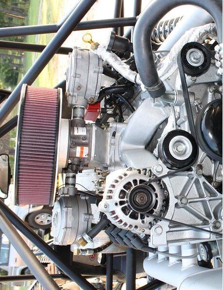

What about going with a 5.3 on propane? Use the Edelbrock #7118 manifold kit with MSD ignition and the propane setup is the same as a 350 engine. It works well and the only wiring on the engine is for the ignition system. The engine in the photo is a 6.0 with dual mixers but a single mixer will work well on a 5.3 until you get into some serious power.
