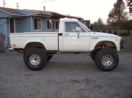

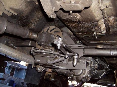

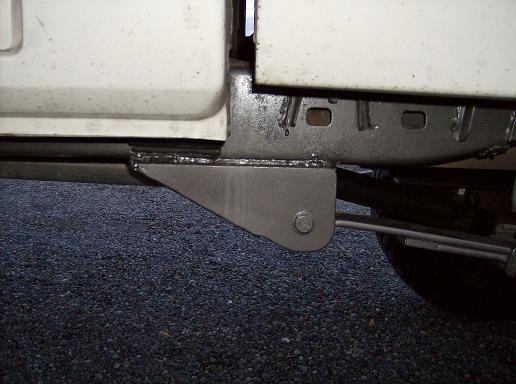

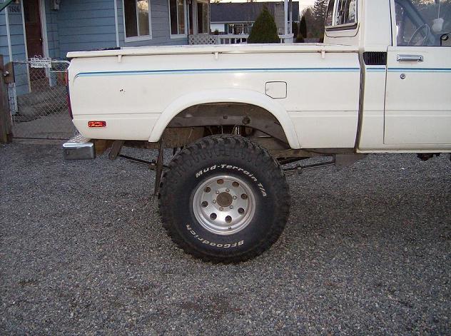

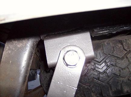

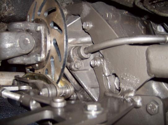

Heres a truck that I just finished up for a buddy . Put 5 inch allpro springs up front with 2 inch shackles and 63 chevies in the rear with 2 inch shackle lift. Total of 7 inches all the way around on 35 bfg mt. Built a high clearance transfercase mount connected to an allpro driveline e brake system.

Not sure. I moved the rear axle back 1 1/2 inches so it was centered in the wheel well and the allpro springs moved the front axle forward 1 1/2 inches. What ever stock is plus 3.
i have an 82 that i have 4 inch allpro springs for.. can you take some pics of the front spring hangers and that bad ass crossmember u used??
if you could and wouldnt mind throwing me a few pointers on the xmember build it would be greatly appreciated

Stock spring hangers in the front. The transfer case mount isnt really that easy to build. I had to build the mount into the allpro ebrake system. Really no pointers on how to do it. Sorry
