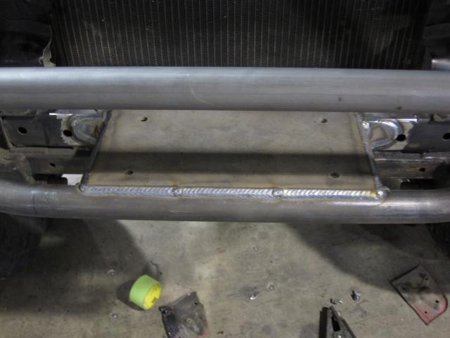

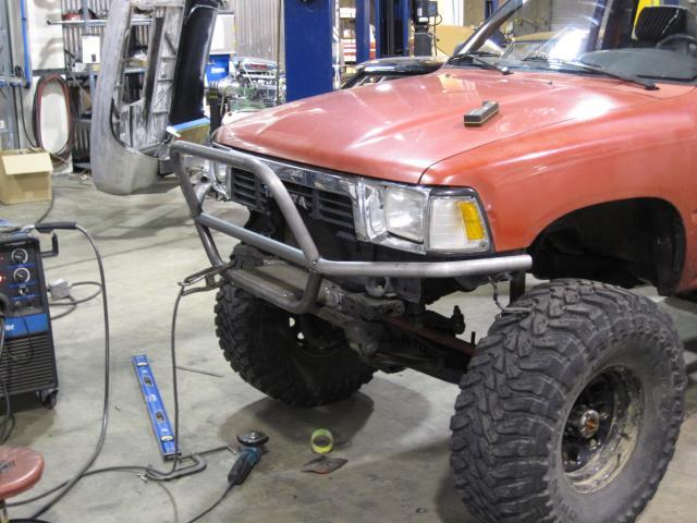

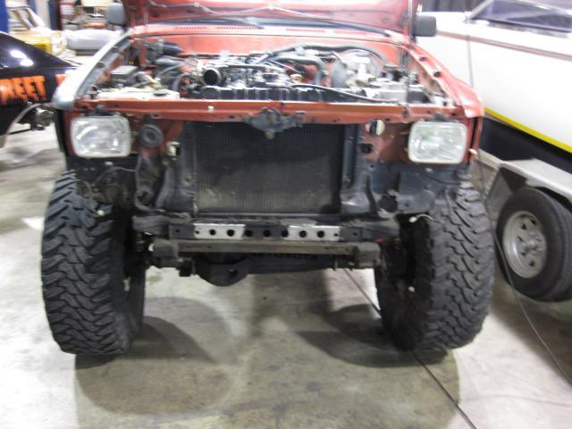

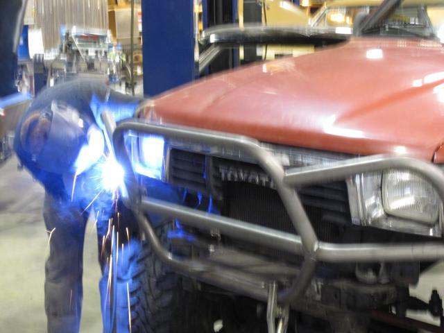

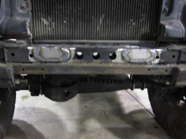

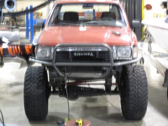

So I built this truck about two years ago and haven't done much with it since. It needs a new housing and I have one ready to go in. I have slider's built for it and I just built the front bumper for it today with the help of skinny pedal. Will probably work on a rear bumper in the near future.

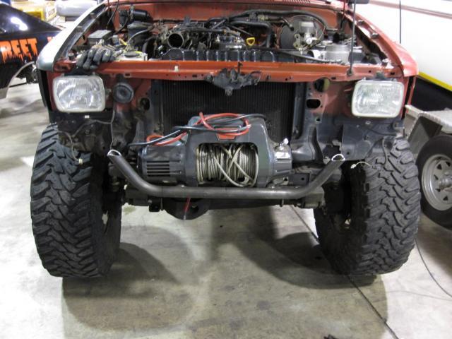

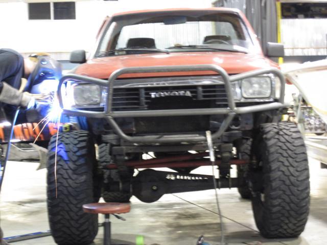

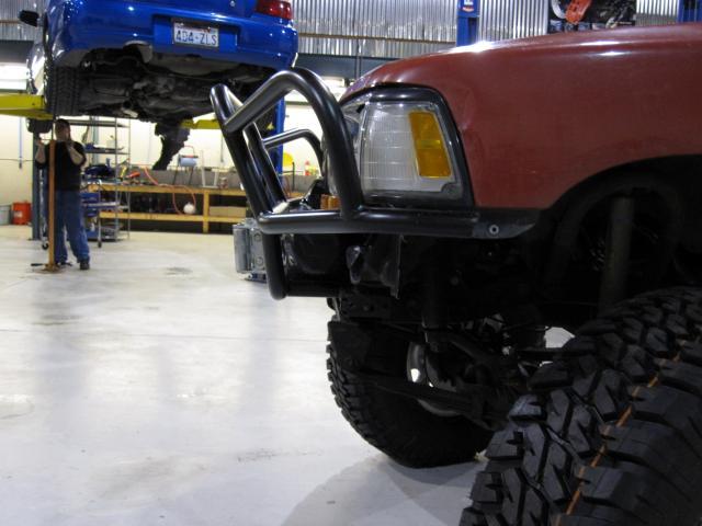

I'm going to finish up some bracing on the bumper tomorrow and make the mount for my fairlead then do some bracing on the core support as I cut a lot of it out to get the winch tucked in. I'll probably also add some small amber LED's for turn signals.

Is all your tubework only being supported by the front of the winch plate or are you adding in some more to atleast support the ends out by your fenders?
Right now it is but I am going to support it out at the fenders. I want to leave the area in front of the tires as open as possible so I'll probably do it out of 1" and bend it to keep it up tight. I also need to add some gussets to put some small led's in for blinkers.
Wait a minute... Is this the truck that replaced your gray 1st Gen? I got some parts off your old truck! And your old frame/cab ended up parked at my house for a while!

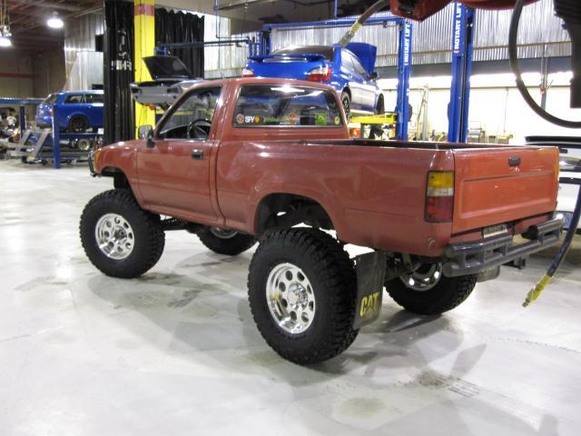

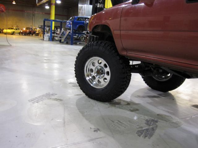

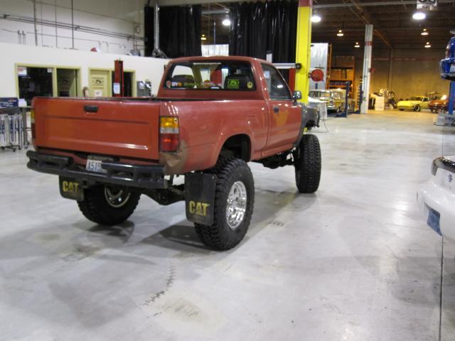

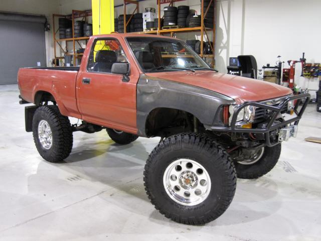

Pulled it in the shop and mounted up my new wheels and tires! 37x12.5x17 MT/R's on 17x8.5" MB wheels.
