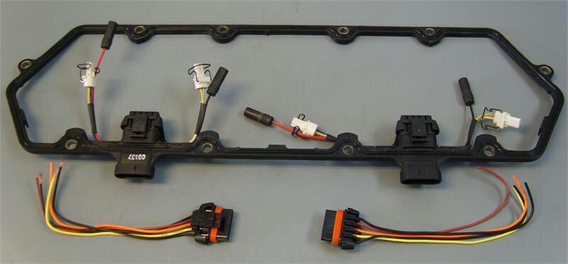

If you do need to swap out the glow plugs, at the time Rock Auto had very good prices on Motorcraft glow plugs, they were around the same price or cheaper than aftermarket ones, so you may want to check them out. Riff Raff down in Oregon is a good place to check too, I got my replacement valve cover gasket/harness from them since they were one of the cheapest places and they were close by (didn't realize I needed them until I tore into the engine).
Yeah, the "gasket" is made out of hard plastic. That is where the wiring harness for the glow plugs/injectors plug into.
