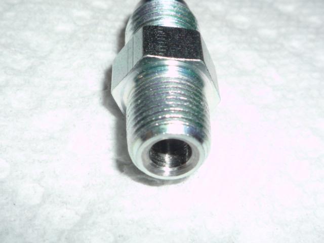

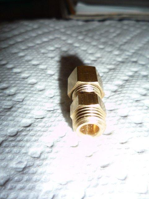

the fitting.

1st one looks like a compression to bsp and the 2nd looks like an npt to jic
second one is correct with the addition of the compression fitting ID on it.:redneck:
which will replace the cheesy first one/ i still need to tap the bulkhead fitting for the 1/8 NPT.
what thread is the bulkhead? i might have an adapter for that straight to jic
i dont want an adapter i want to get rid of the weak assed brass compression fitting for a more sturdy steel with twice the meat at the threads.
the brass fitting has a stresser built right into it and ive seen a lot of them crak or fail somehow. just trying to beef it up a little with a minimum of fittings.
so it dont break on the trail EVER. it came out great, most bulletproof setup ive seen with my eyes. :flipoff:this setup will eliminate the little brass fitting above the other three.
