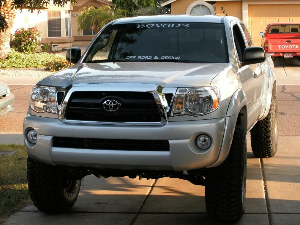

a buddy of mine went and bought a '08 taco 4x4, extended cab TRD

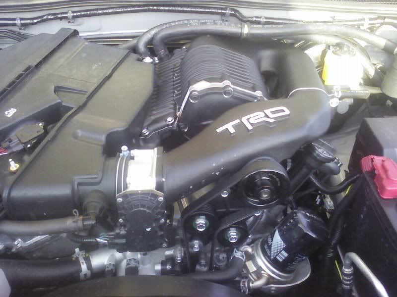

had dealer install trd blower w/ inter cooler
then he brought over a bunch of parts.
35's

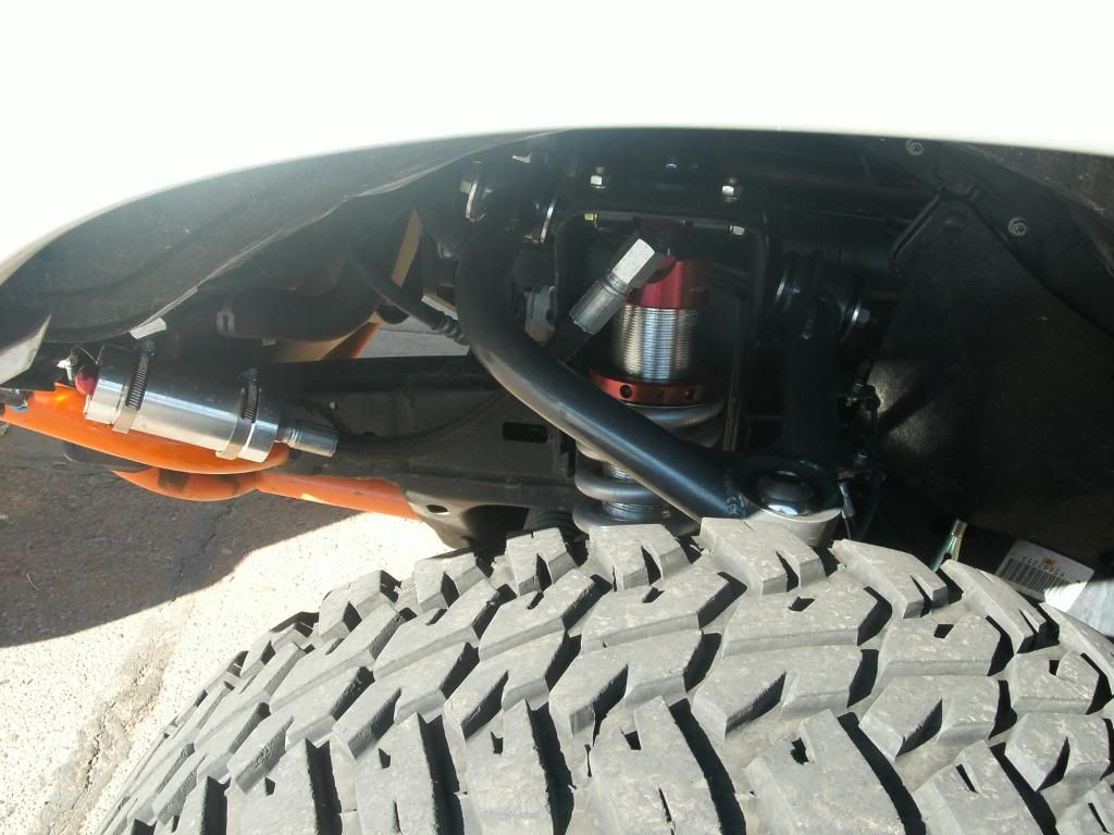

oem springs, burg upper arms

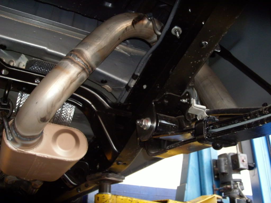

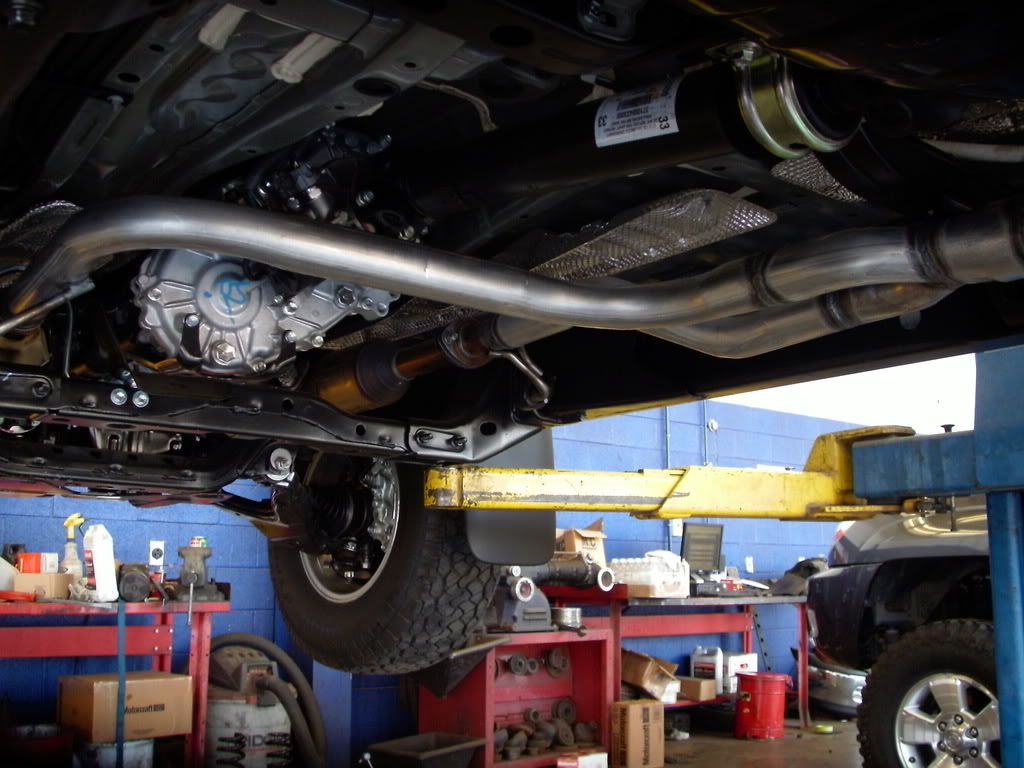

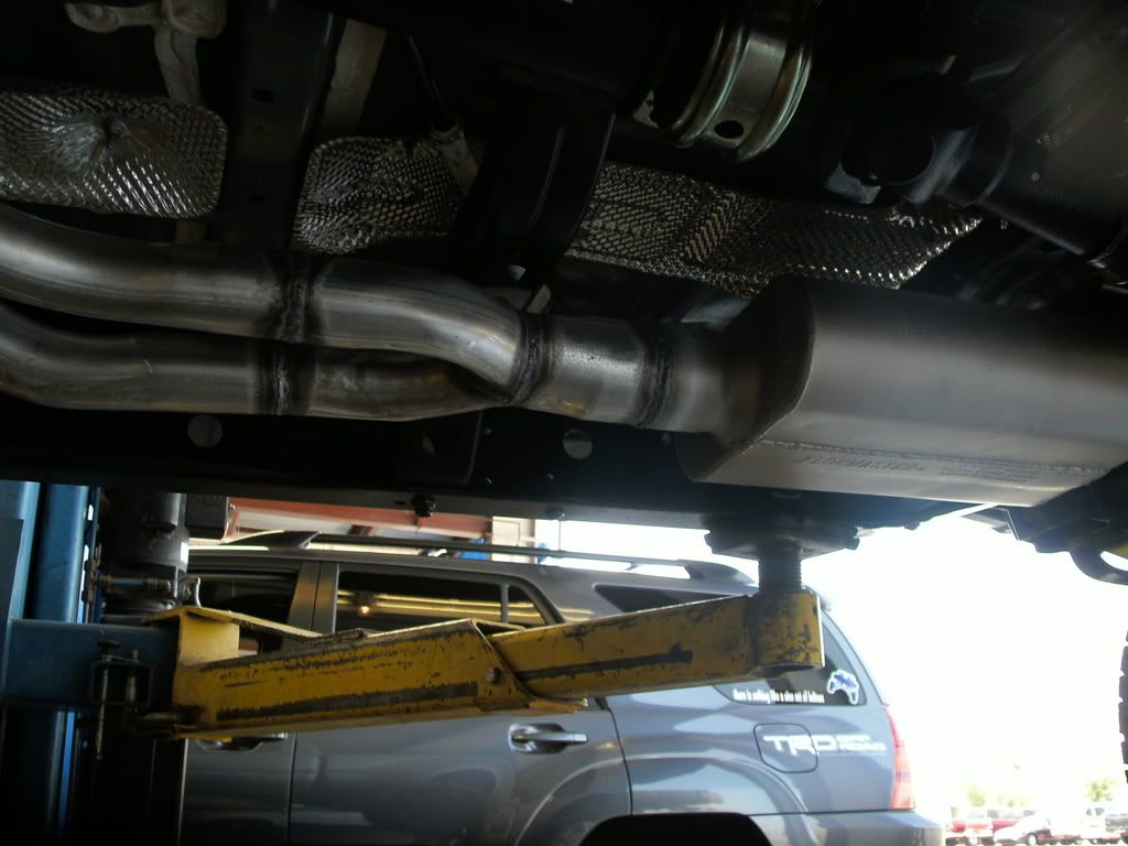

then i took it down to my exhaust guy and had him work his magic

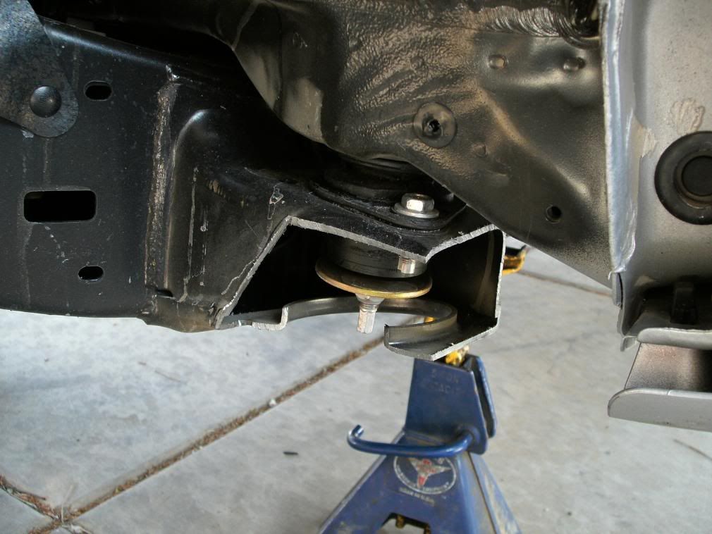

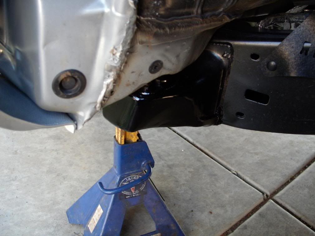

well the 35's hit the front cab mount so i trimmed and boxed that

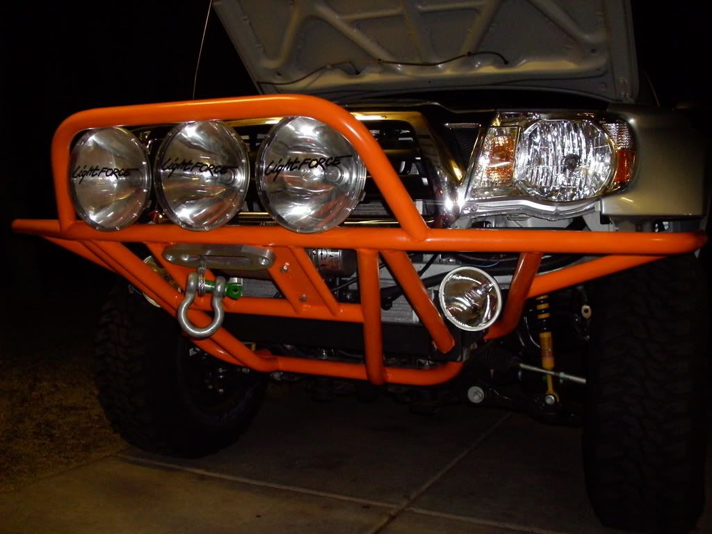

well then he wanted a bumper, not just any bumper, he wanted a big "PRERUNNER" type bumper, that held some lights and a winch

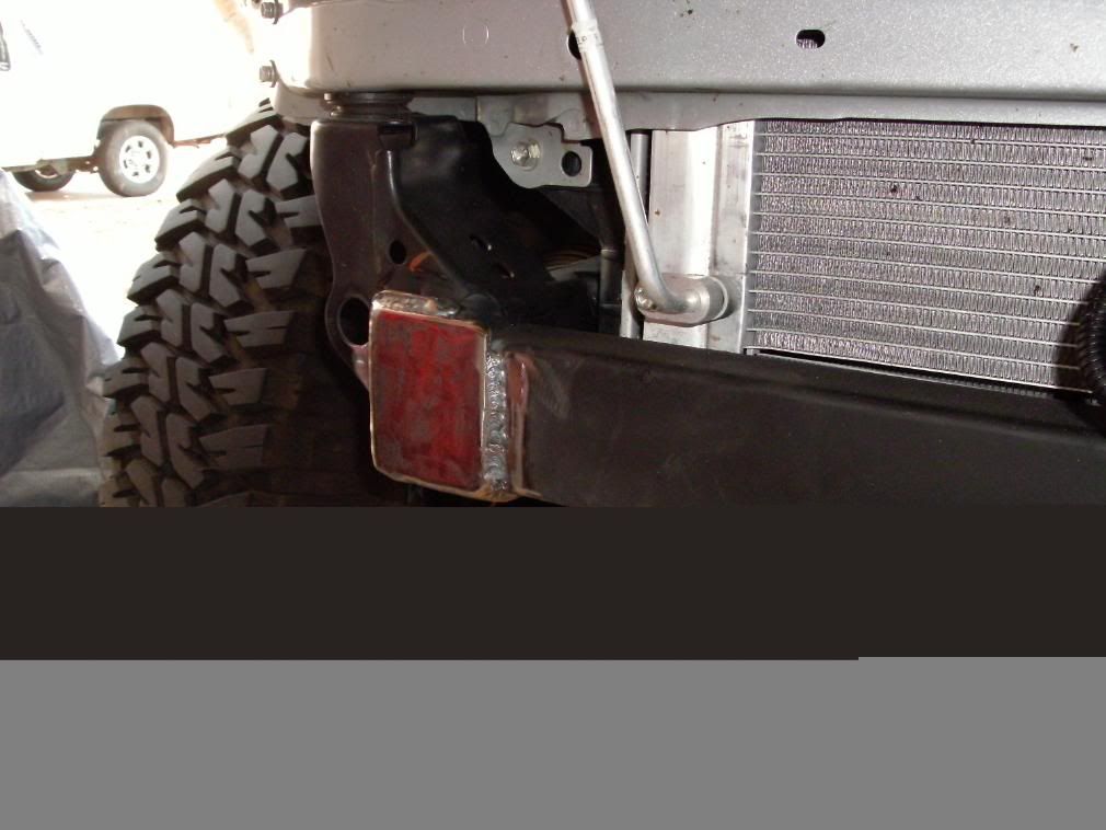

so i cut about 3" out of front frame horns, boxed them and put a 2x3 rectangle boxed peice back in for support
then started tube work
yeah its huge, but thats what he wanted, and wanted it that color to match his KTM

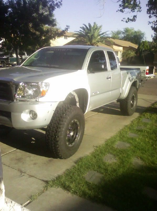

well that lasted a few days, then came the front glass fenders

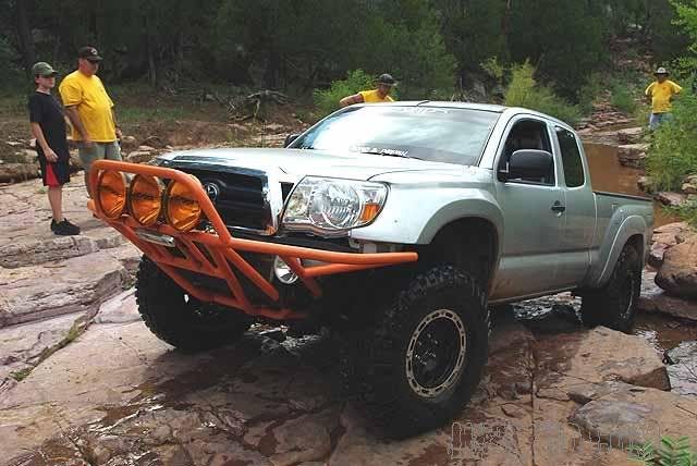

first and only wheeling trip so far

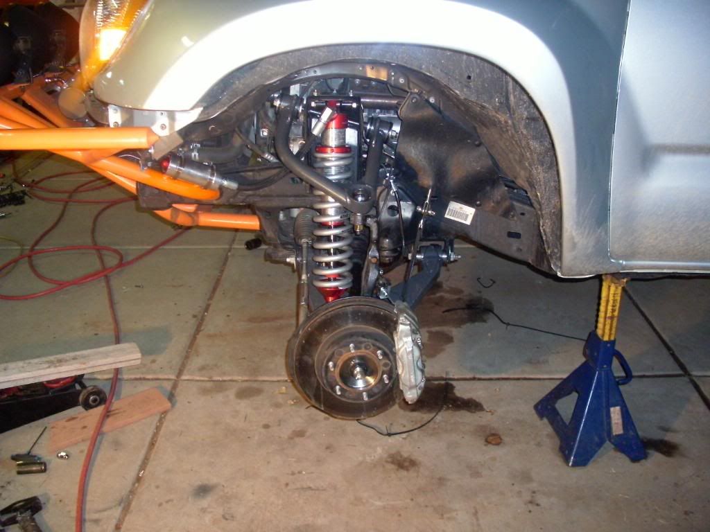

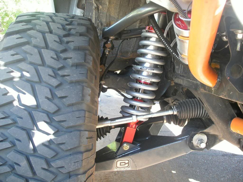

well after that trip he definitly wanted to do CAMBURGS new long travel front end

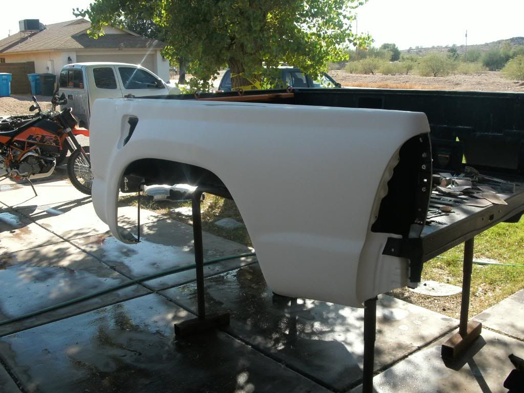

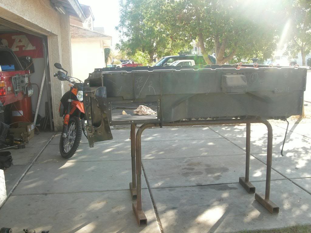

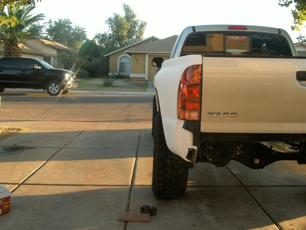

then came the bedsides
started with this
ended with this
now bedsides are going to paint and rear suspesion starts.
started with this
ended with this
