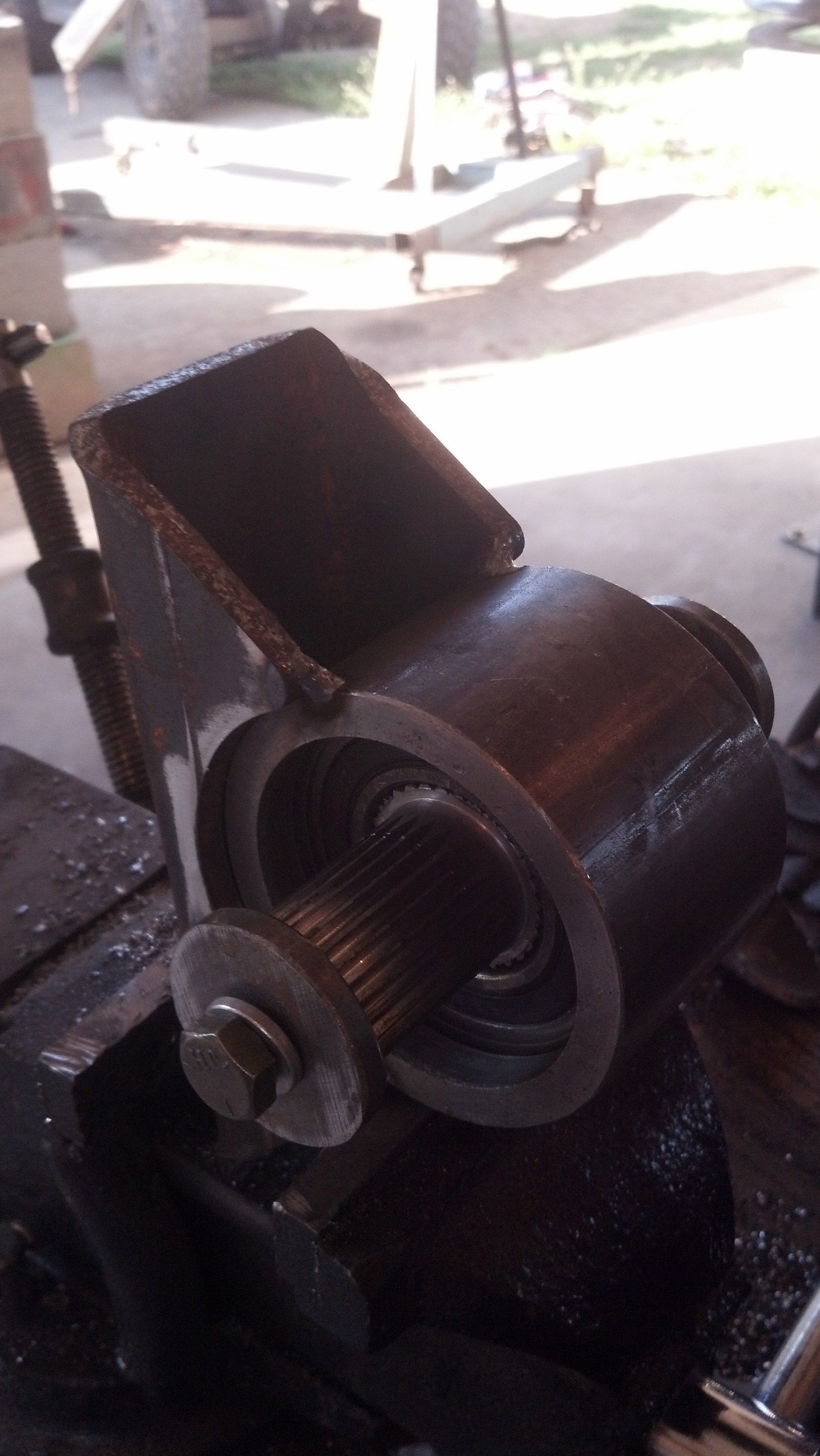

Ryan at He-man machine built mine. Its the same as wide open design sales but he milled the shaft down a lil smaller. Top notch work..

look at my pic. on my profile. mine is a 2 piece toyota that might work for what you want but your intermediate shaft have to be made
I used a toyota intermediate with a pillow block bearing that had the right diam. to fit perfect. over the shaft then the factory flange bolted on the end.
this would work for you 205 flange on one end and toyota carrier end on the other thru pillow block breaing and toyota flange to your front toyota to toyota d shaft
If you want a pic give me a text number I will give you a rough idea pic. cost is not bad it can all be done by any machine shop I have broke u joints but use the TG it should take a v-8 ! the drive shaft end ears are the next weak link not a lot of meat there. hope it helps!
