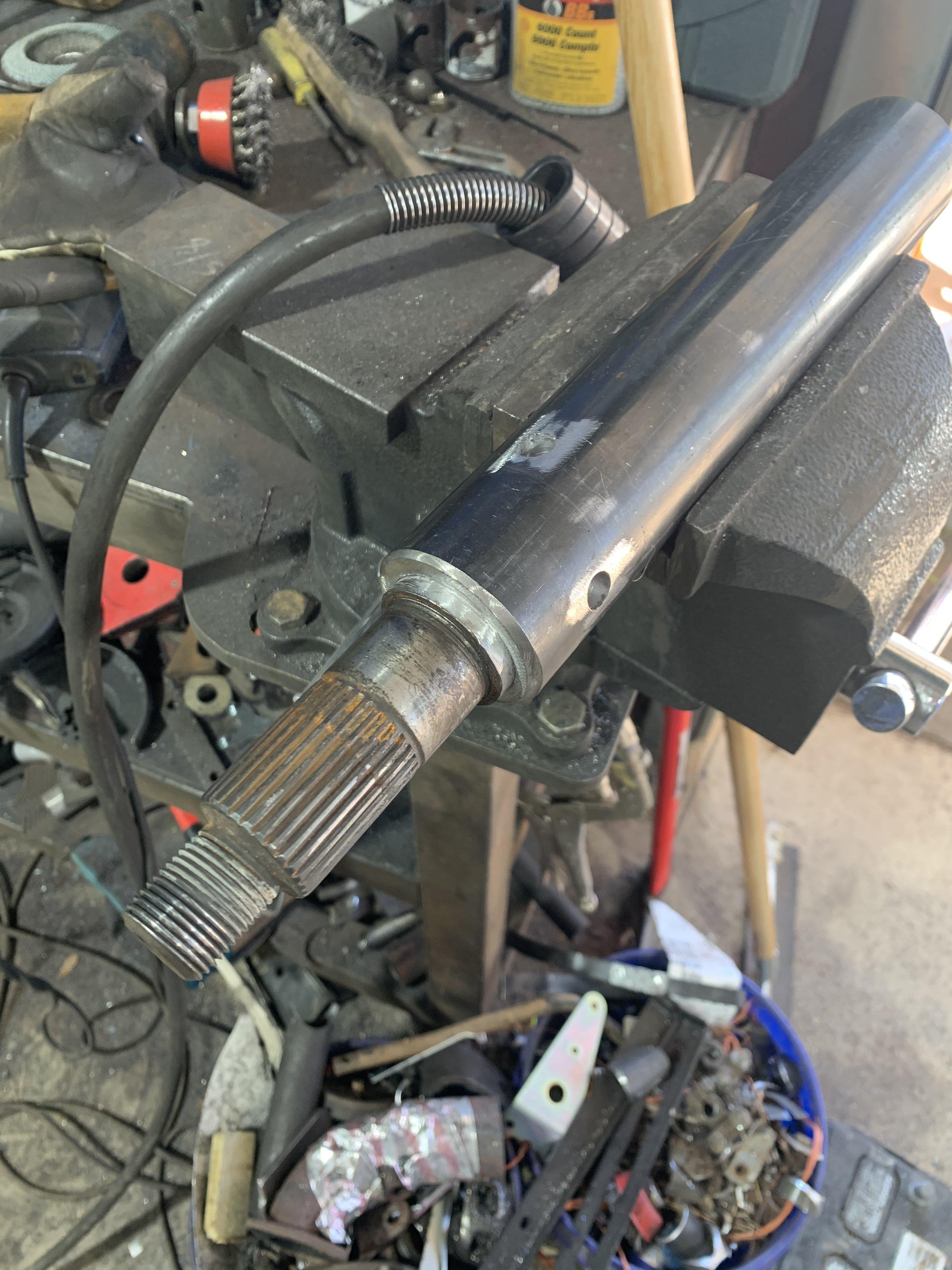

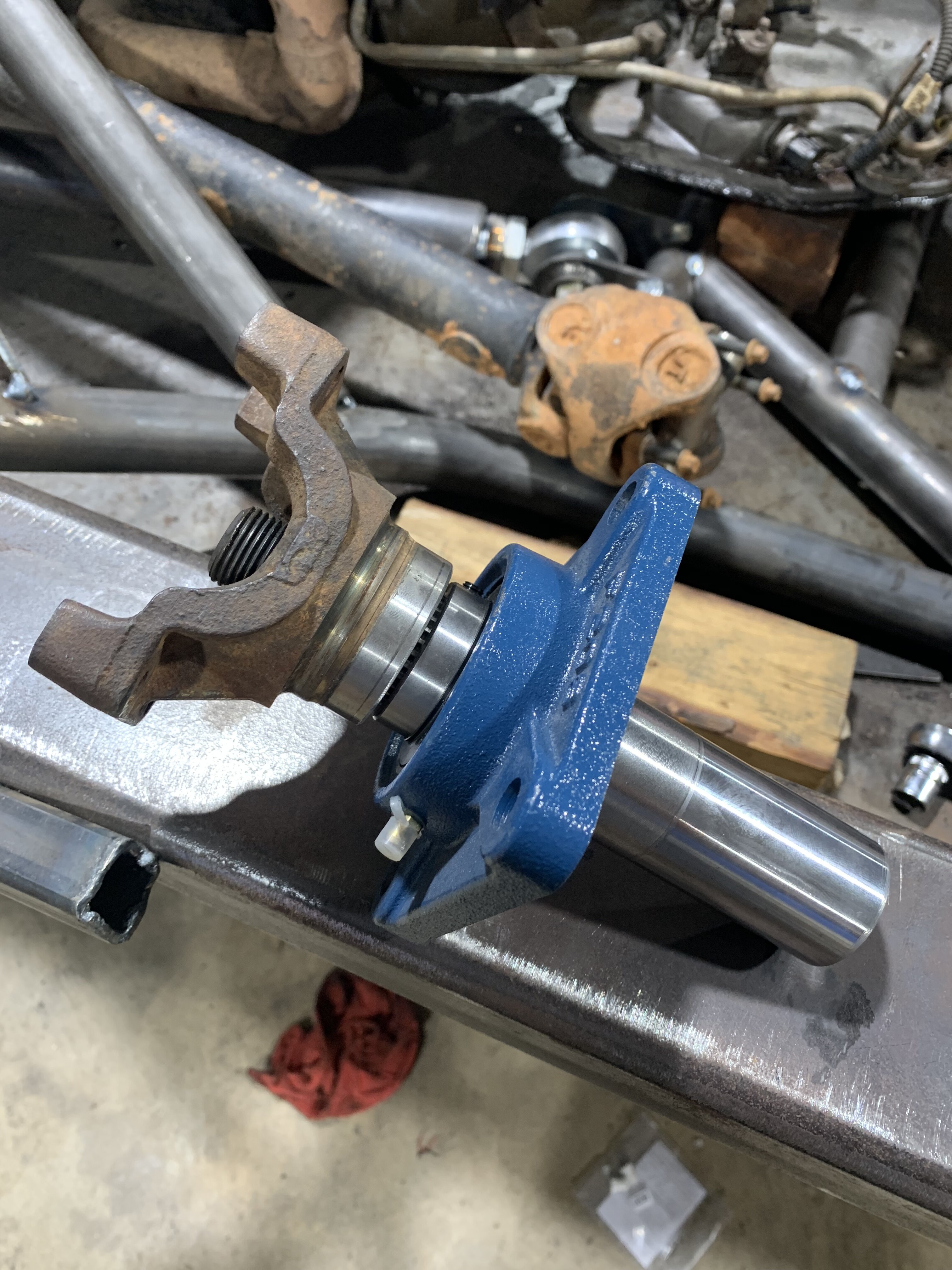

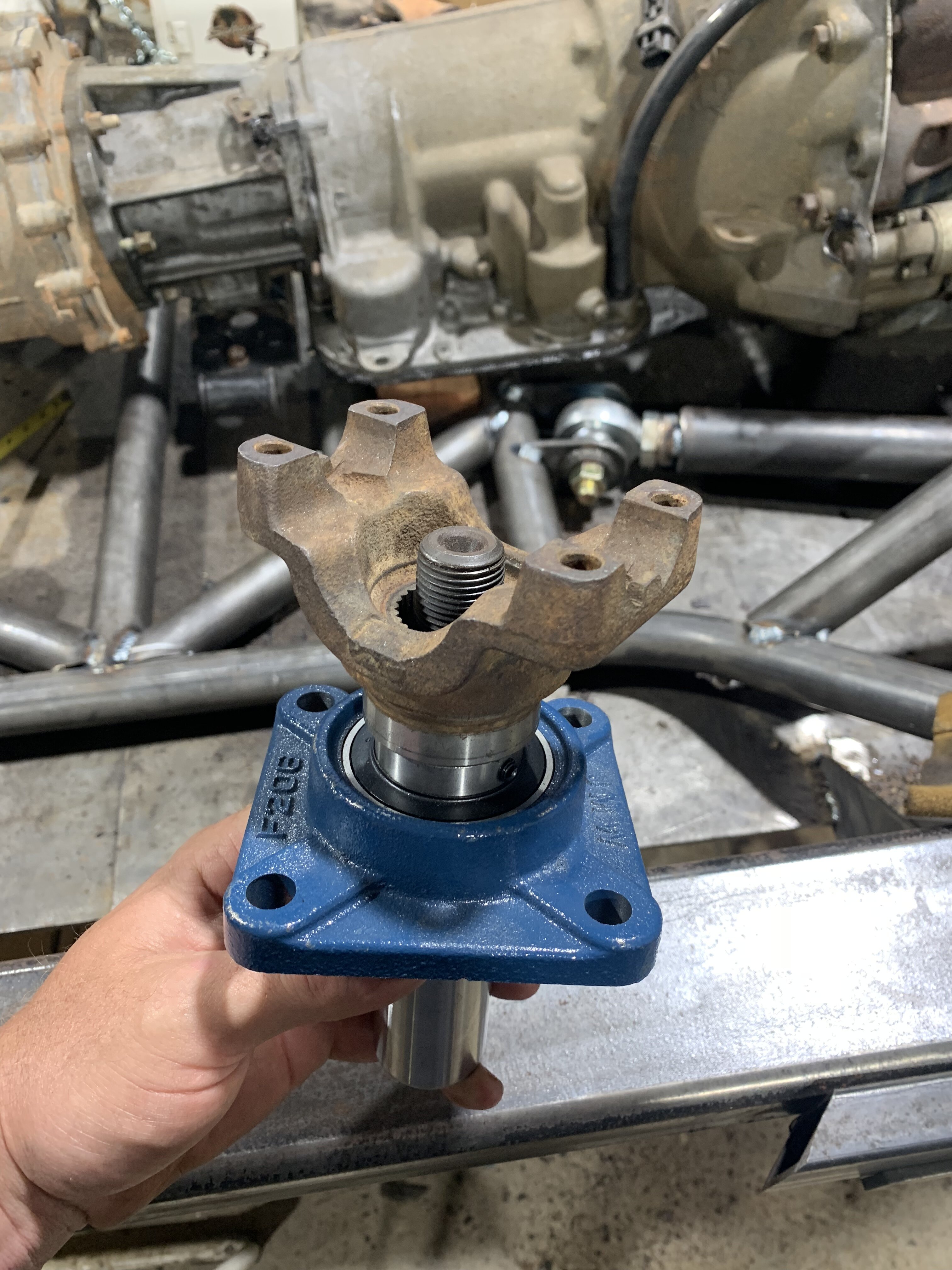

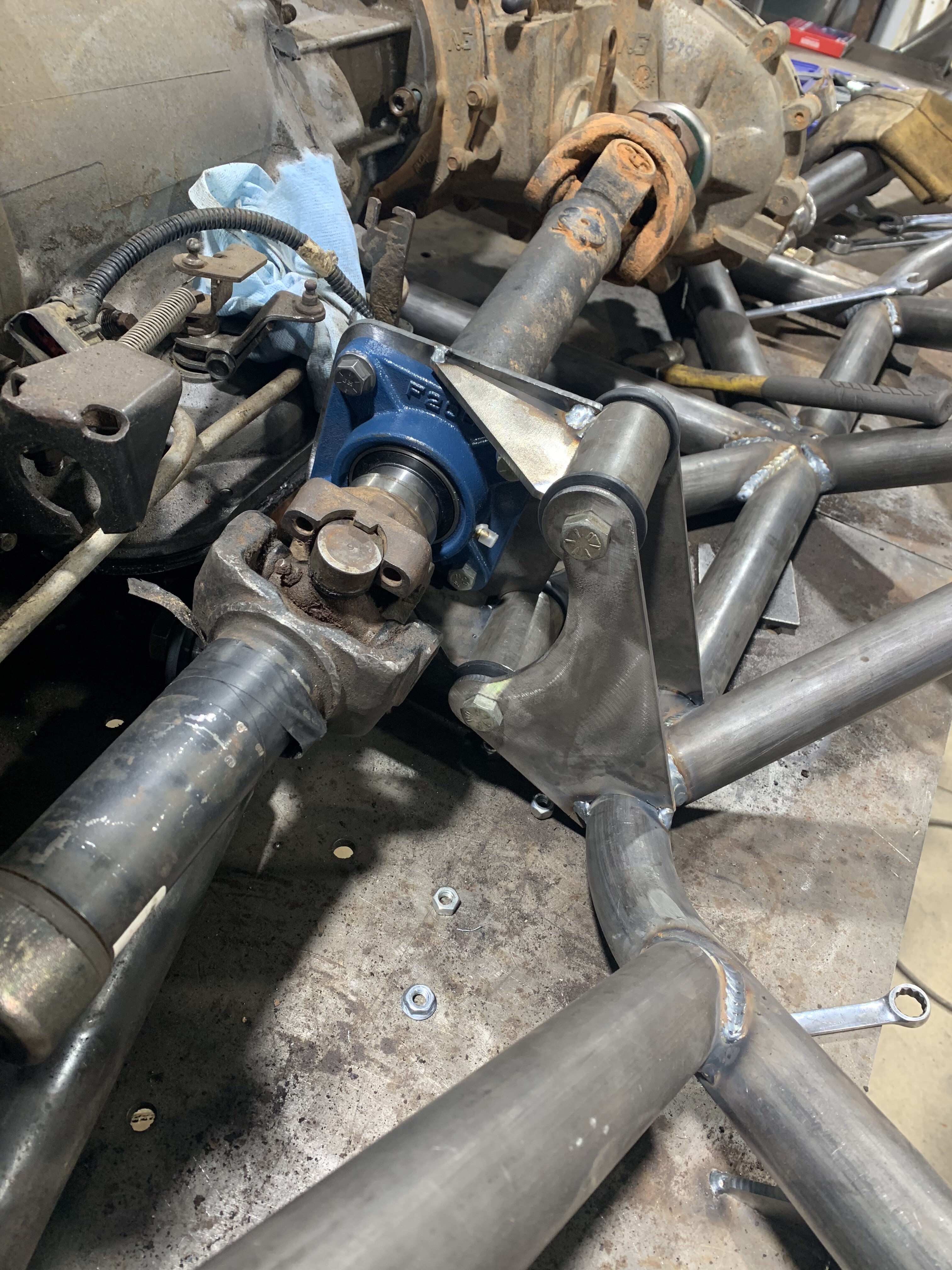

Decided to try and build a cheap carrier bearing set up for my current Jeep. Did some searching and found an old thread on pirate about using a Dana 60 pinion so decided to give it a try. Had a buddy cut the gear off and machine the shaft/inner bearing surface to fit a 1.5 id driveshaft tube. The outer bearing surface was already 1.25 so I found a two pack of these 4 bolt flange style carrier bearings on amazon for $20. Made a bracket with a couple leaf spring bushings and it was done.

Ive heard of the ears breaking on the 2 bolt style so I figured I’d try this 4 bolt style to spread the load out.

Great Idea! Thanks for sharing. Are you going to do anything special when you weld it since its a harder gear material?

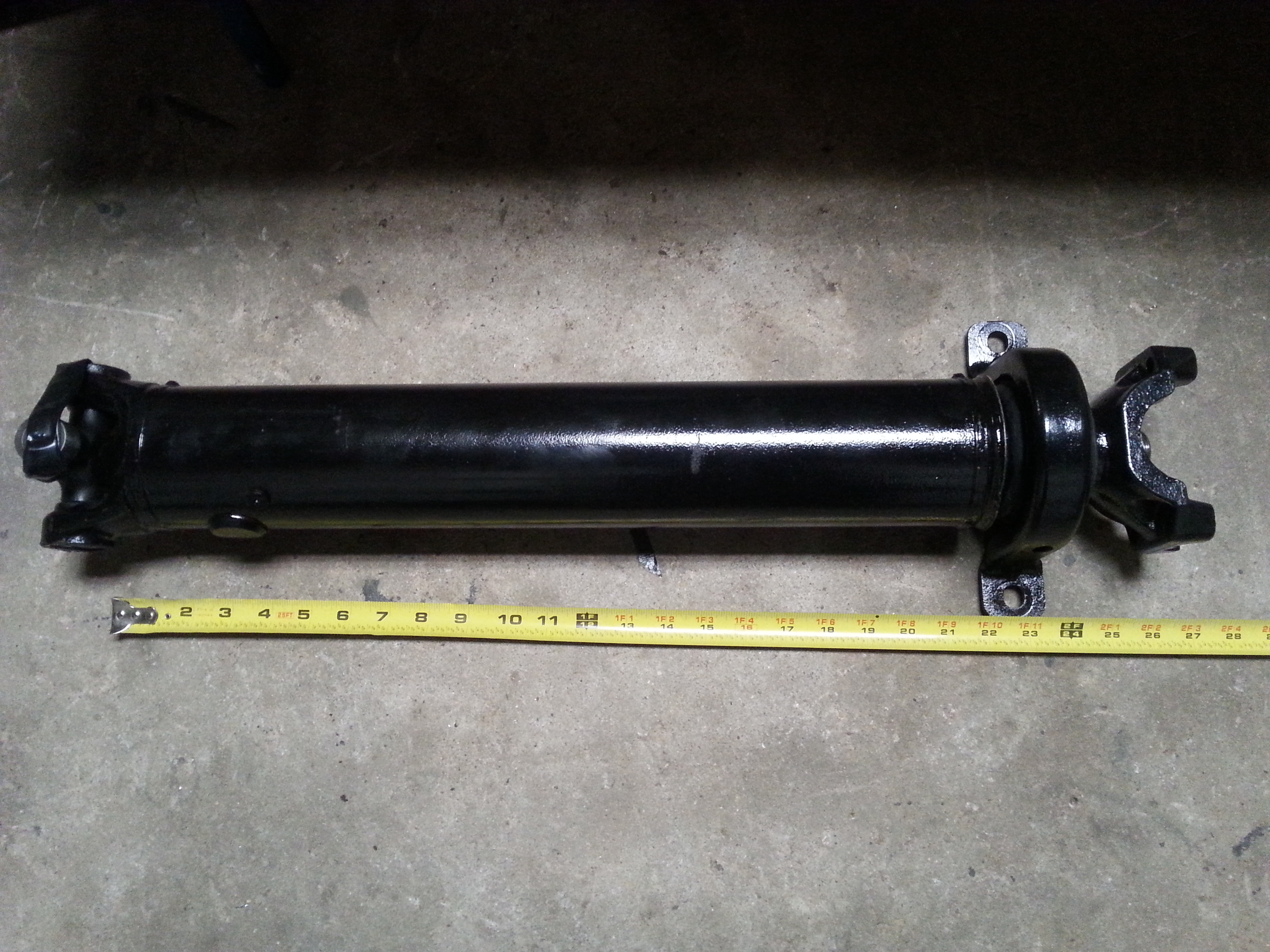

1999 up Superdutys use a 2 pc rear driveshaft. Carrier bearing and 1410 joints. I use one in my Jeep uncut.
I didn’t do anything different than normal when I welded it up. It’s been on two trips, the second trip I twisted the .120 wall shaft between the bearing and axle.
