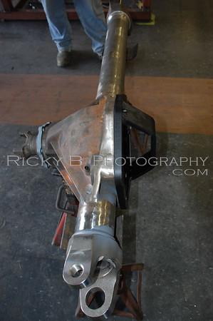

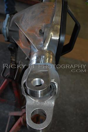

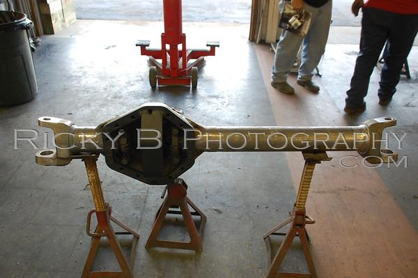

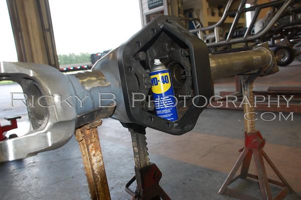

Few spy shots for you guys... the axle tubes are ridiculous!
plan on using solid...for the money and the shear block and 6 bolts plan on using them..should be the key to fixing 60s ring gear problem.

I'm sorry, what? Maybe I'm tired and cant read but that read to me like bible bang, holla' throw.
Are you saying they are Solid "C"s and then using Solid Knuckles with the Solid 6-bolt steering arm? If so then I understand.
That looks nice. WMS made a bunch of those years ago for those monster Jeeps thye used to build. I look forward to seeing the inner axles on these.
It does not seem like this could save any weight over a Rockwell though. I know the packaging is so much easier with these than toploader's though.
