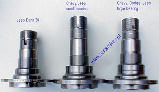

Here is a pic of the different spindles from Parts Mike's website. I coulda sworn that mine looked like the big bearing spindle but of course it is all buttoned up now

so which one is the one off your rig? The ones I have are the same as the one in the middle. I can dig around and see if I have the one to the right.
Believe the break is 1977 and older are small spindle.
Only advantage I know of is the small spindle will allow the use of 1/2 ton Ford rotors with the GM small bearings.
