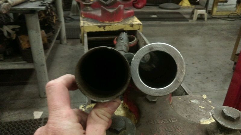

I've bent a .120 wall rear shaft and twisted a .120 front drive shaft. Now all shafts are .250 wall. I run a single rear and two piece front. My buddy twisted a .120 wall mid shaft so don't skimp any where.
There's a formula that you can plug your driveshaft numbers in (length/tube thickness&diameter/ max rpm) that will Tell you if your d-shaft is up to the speed your car is capable of.

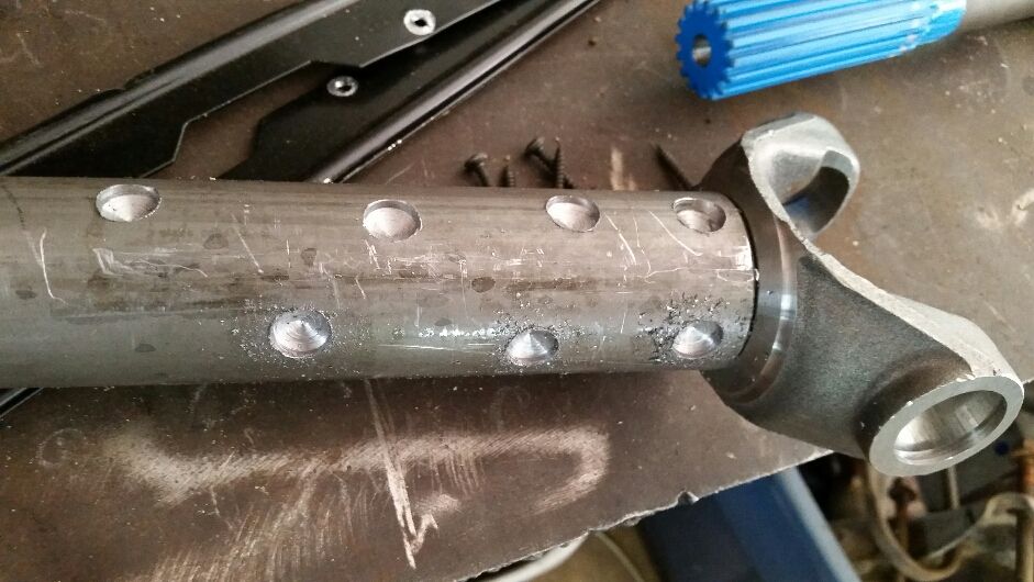

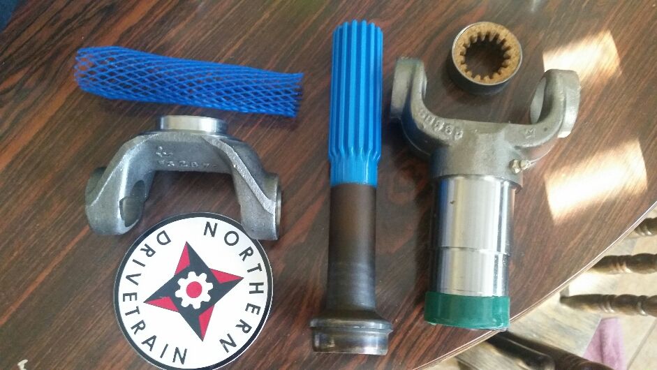

I build my driveshafts using northern drivetrains 1410 tube yokes to fit 2" .120 wall with the 1.375×16 splines. I sleeve the .120 wall with 1.75 .250 wall tube.
This has been great for me...keeps my shaft diameter small with lots of strength. Been holding up fine on my rocks and 54s with plenty of power.
