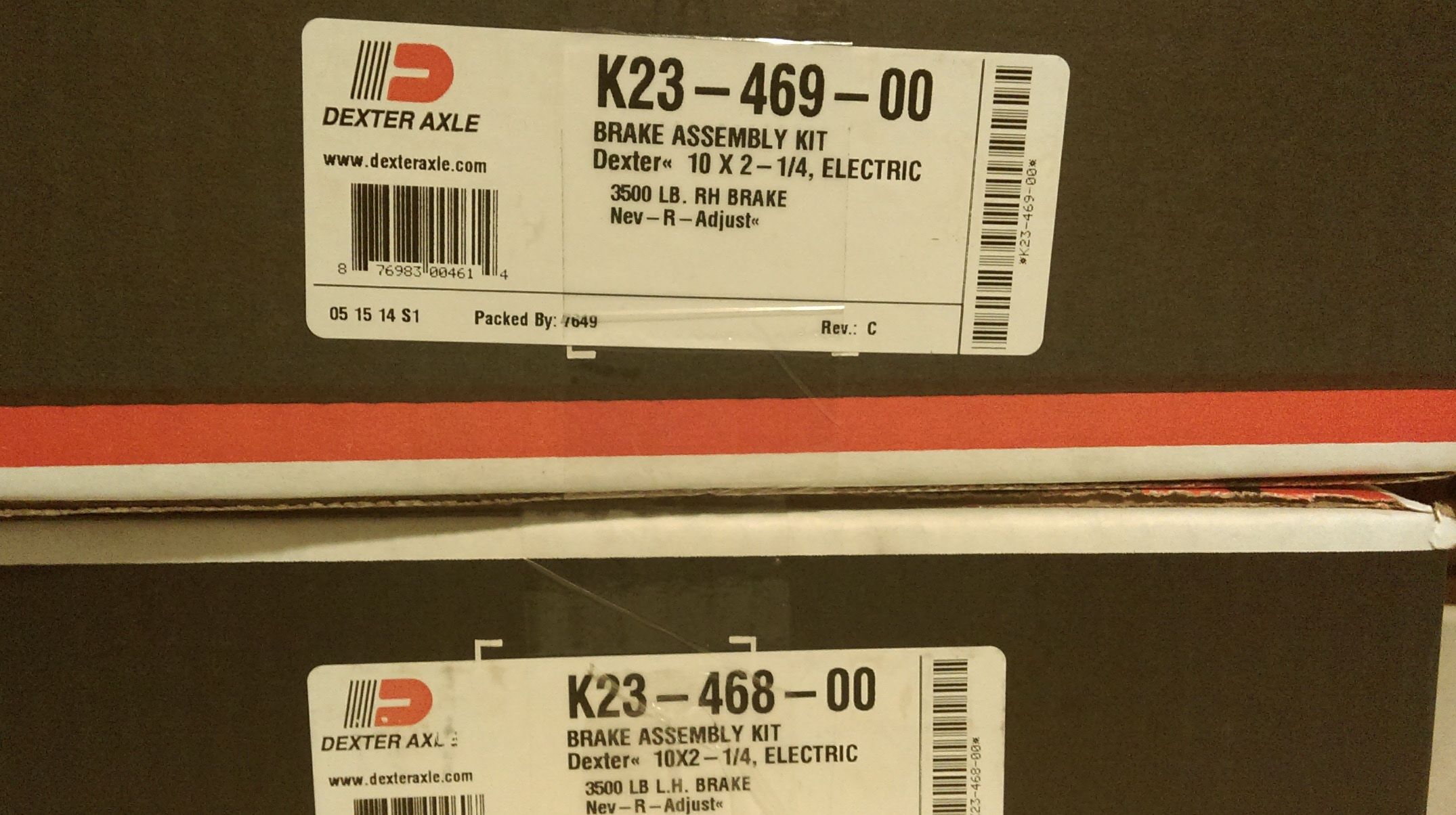

If anyone cares or ever changes brakes here are the common (according to local truck/trailer place) for most of our type trailers. Ended up getting genuine Dexter never adjust "upgrade" for $53.35 each. Made in USA just as fabricator1 said.
Auto wheel and rim. Evansville in. That was with my company discount though. Where I work we buy from and sell to auto wheel.
Drums are good still. Gonna ask buddy of mine to see if he can turn them. If not I'll scuff them and go.
