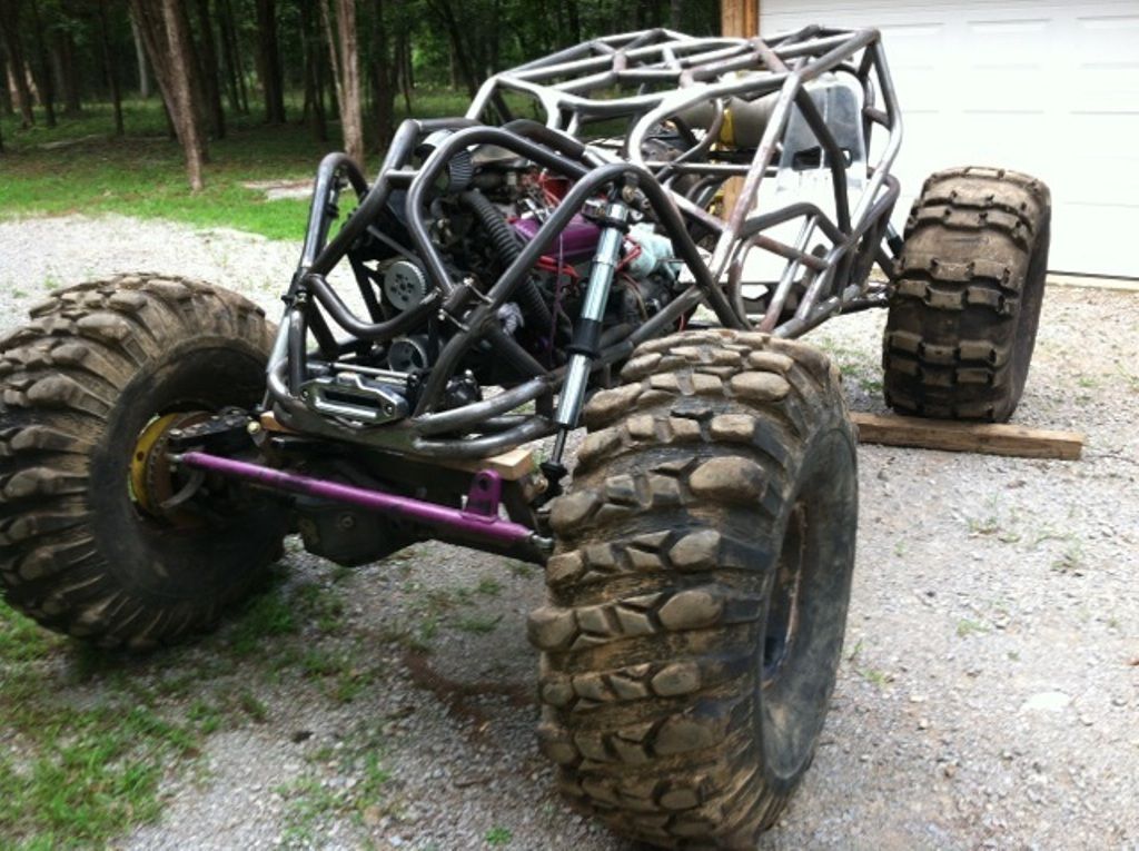

Engine cages. Lets see yours or your favorite.
For you guys that build do you consider the engine cage part of the structure of the front end or just a hood to protect the engine In a roll over. since I'm doing my out of .120 hrew I'm thinking solid mounting it with removable tabs from shock hoop to shock hopp then to firewall would add a considable amount of strength. But easier to put on and off with poly bushings. Thoughts??
