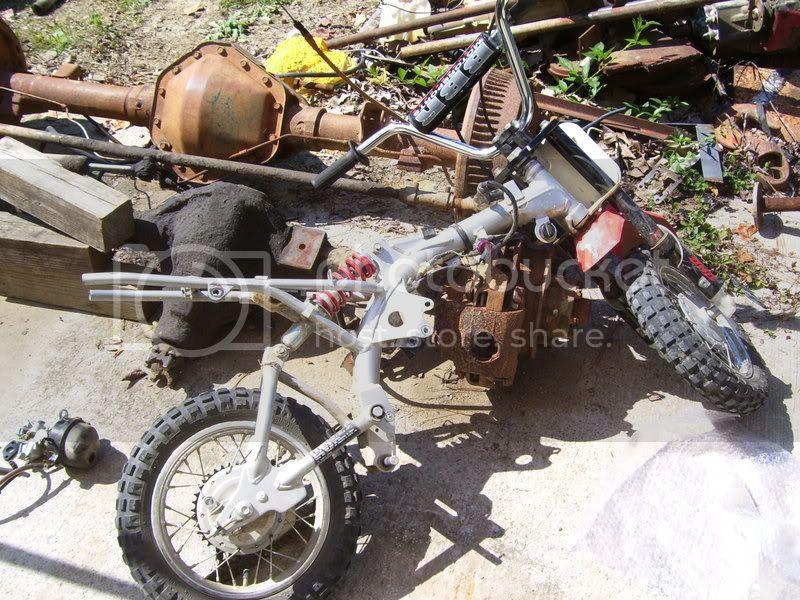

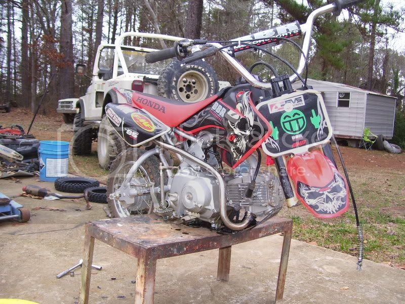

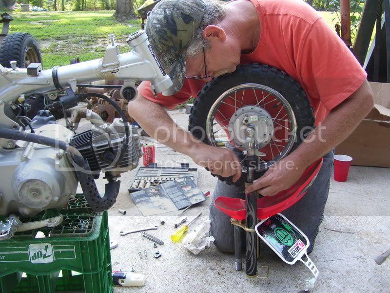

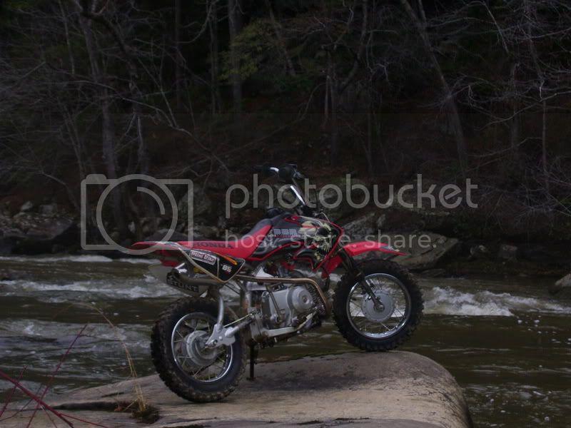

Finally got time to post up what i've done to the Fiddy..

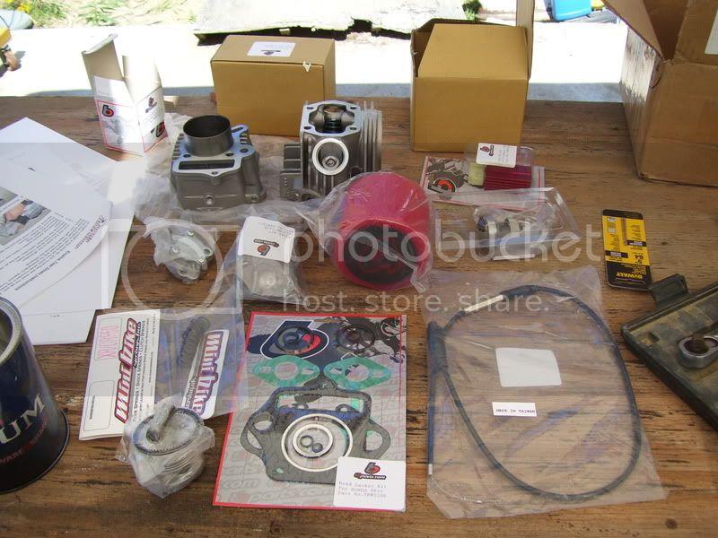

BBr big bar kit, w/ throttle and billet tube.

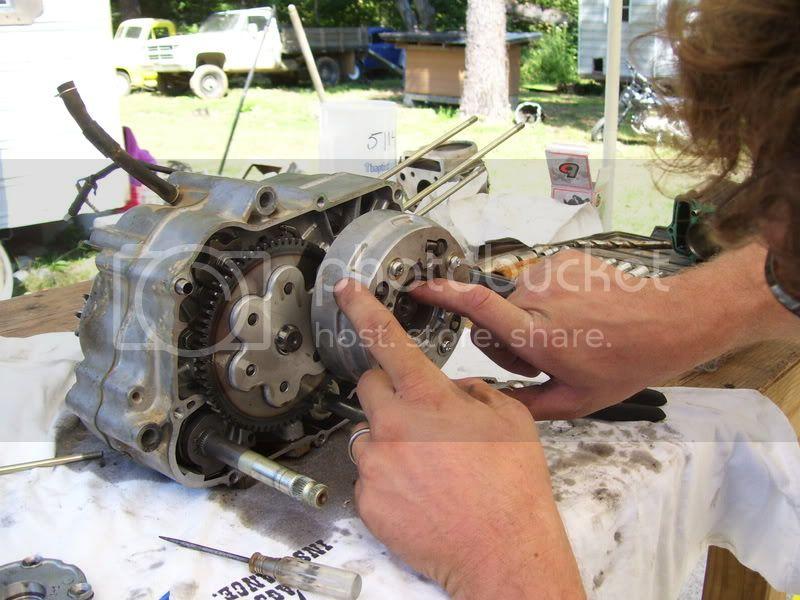

Trail bikes 88cc kit with the race head.. 22/25 mm valves. huge cam.
tb mx CDI
TB 300x high flo oil pump
modded stock exhaust
Keihen 22mm carb
HD clutch springs
TB big filter

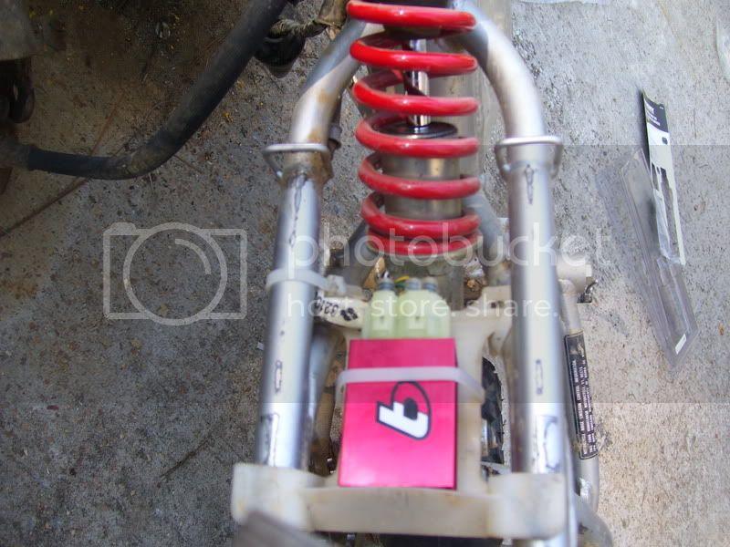

Fat boy rear spring
flat nasty fork stiffeners
and fat boy fork springs..
Bumped the horsepower from 1.5 to 10....

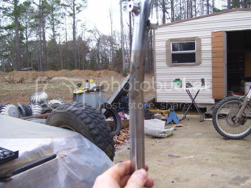

Front fork rod was bent soo bad from crashing at mmorv the forks would not compress at all...

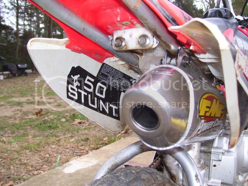

Got the sa-weet new fmf system on it.
It sounds like a 400ex w/ a big bore..
still pretty loud, but very throaty...

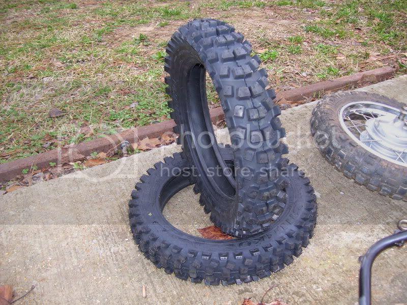

New set of Rubbers..
2.75 on the back
2.50 on the front...
