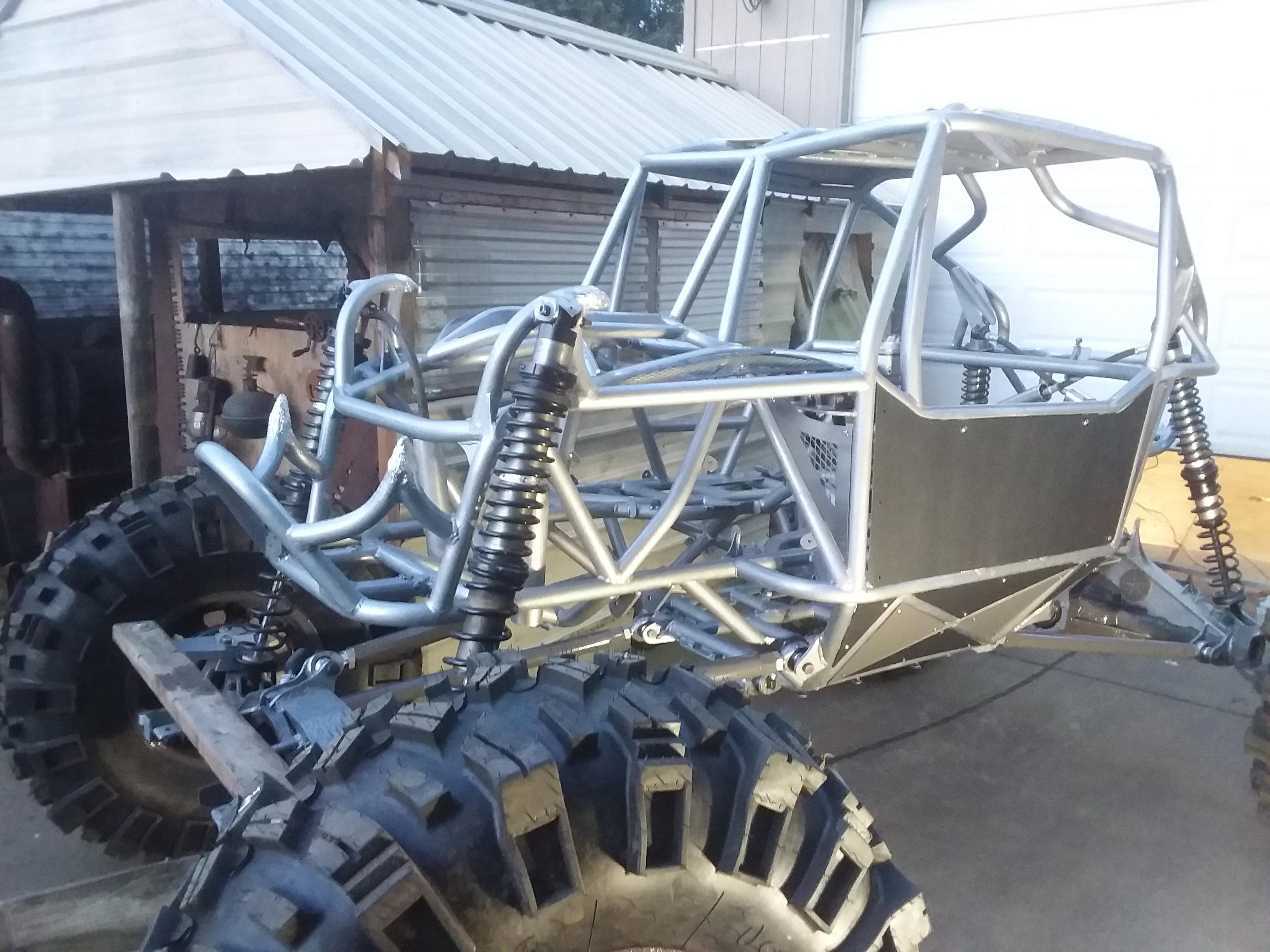

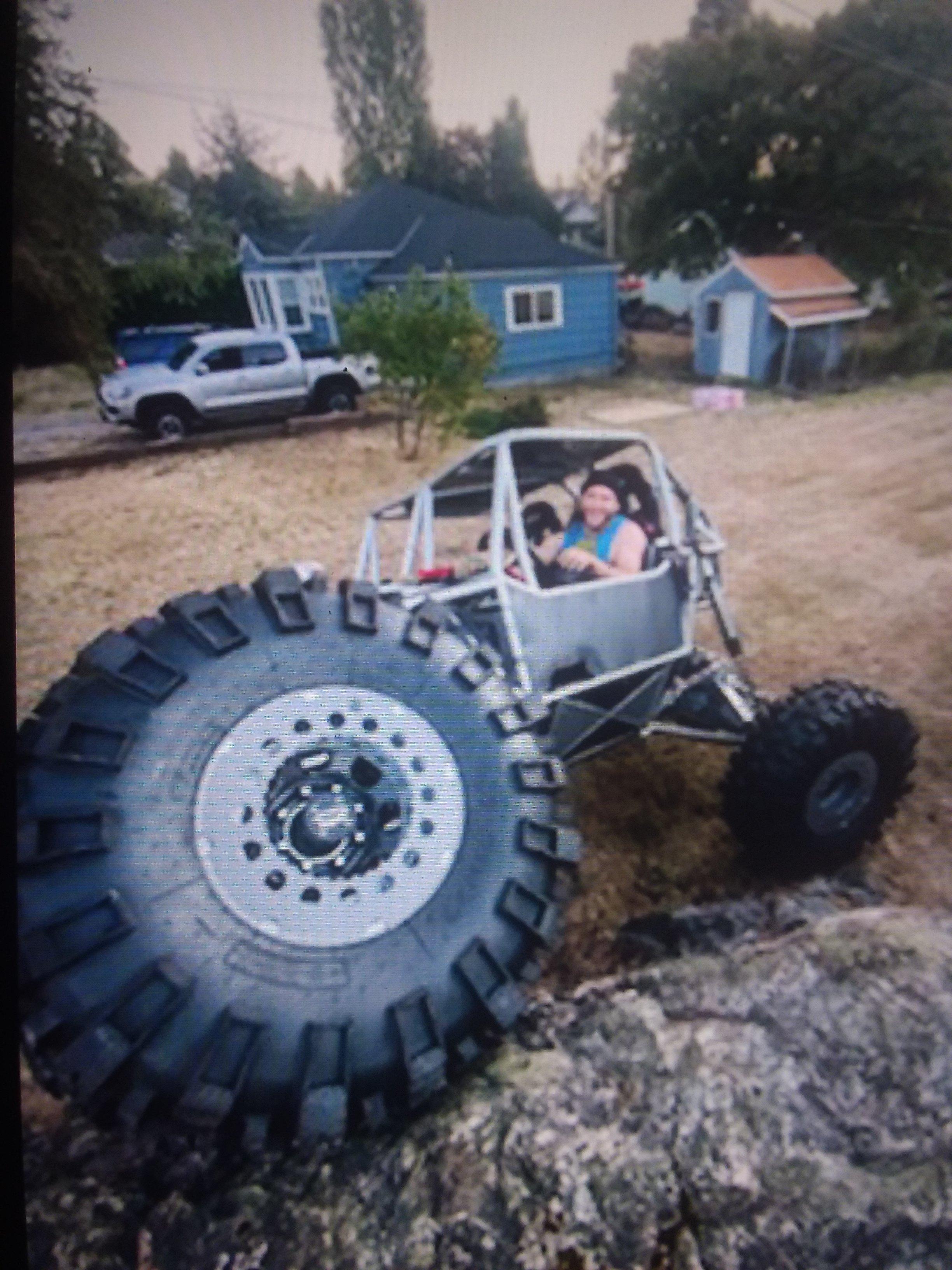

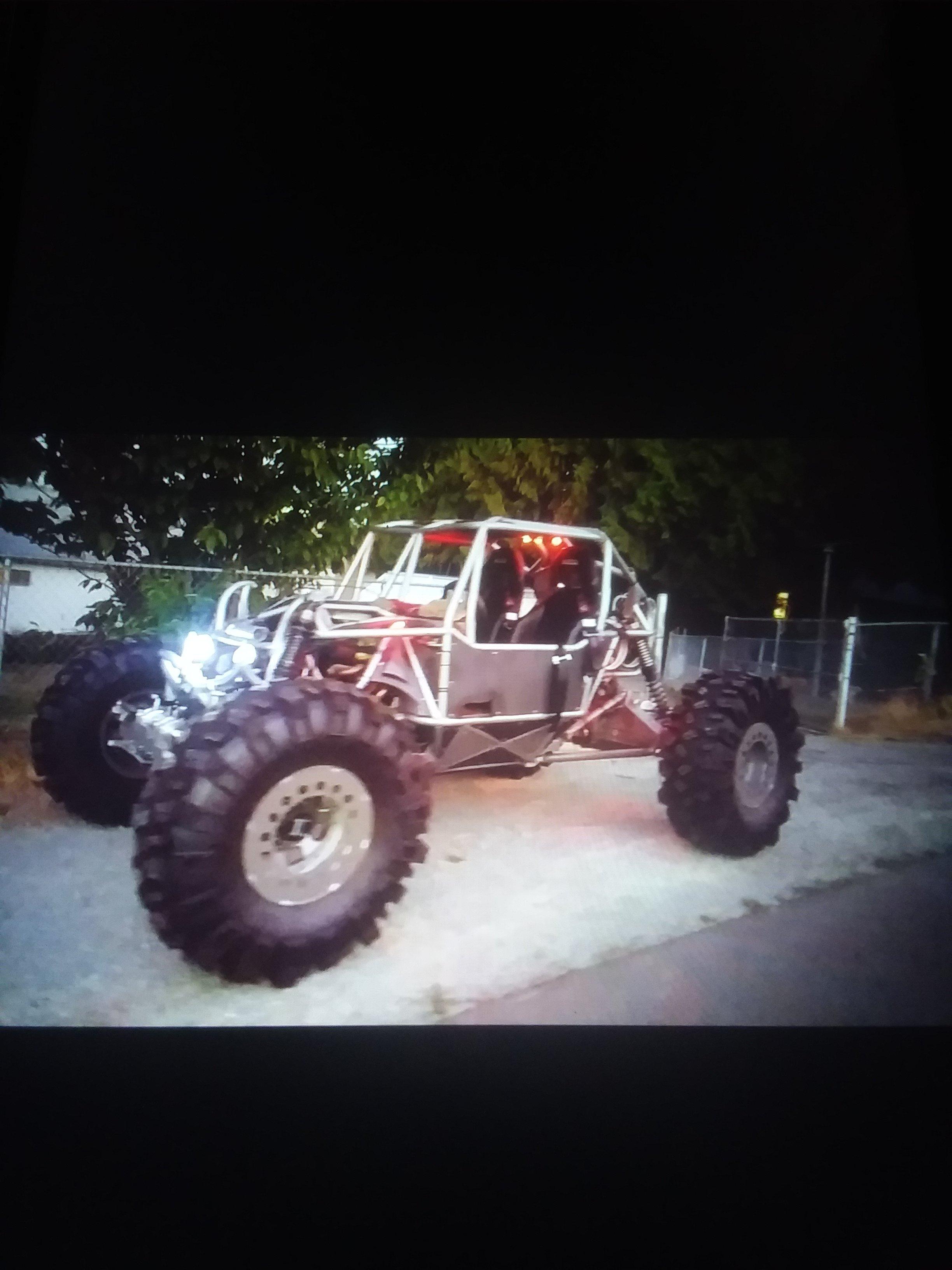

Well it took longer than I thought to build it but its finally done. Just waiting on my oil accumulator.
Just gotta finish a couple things with the trailer and tow rig and hopefully get to Sand Hollow by the 7th of Oct.

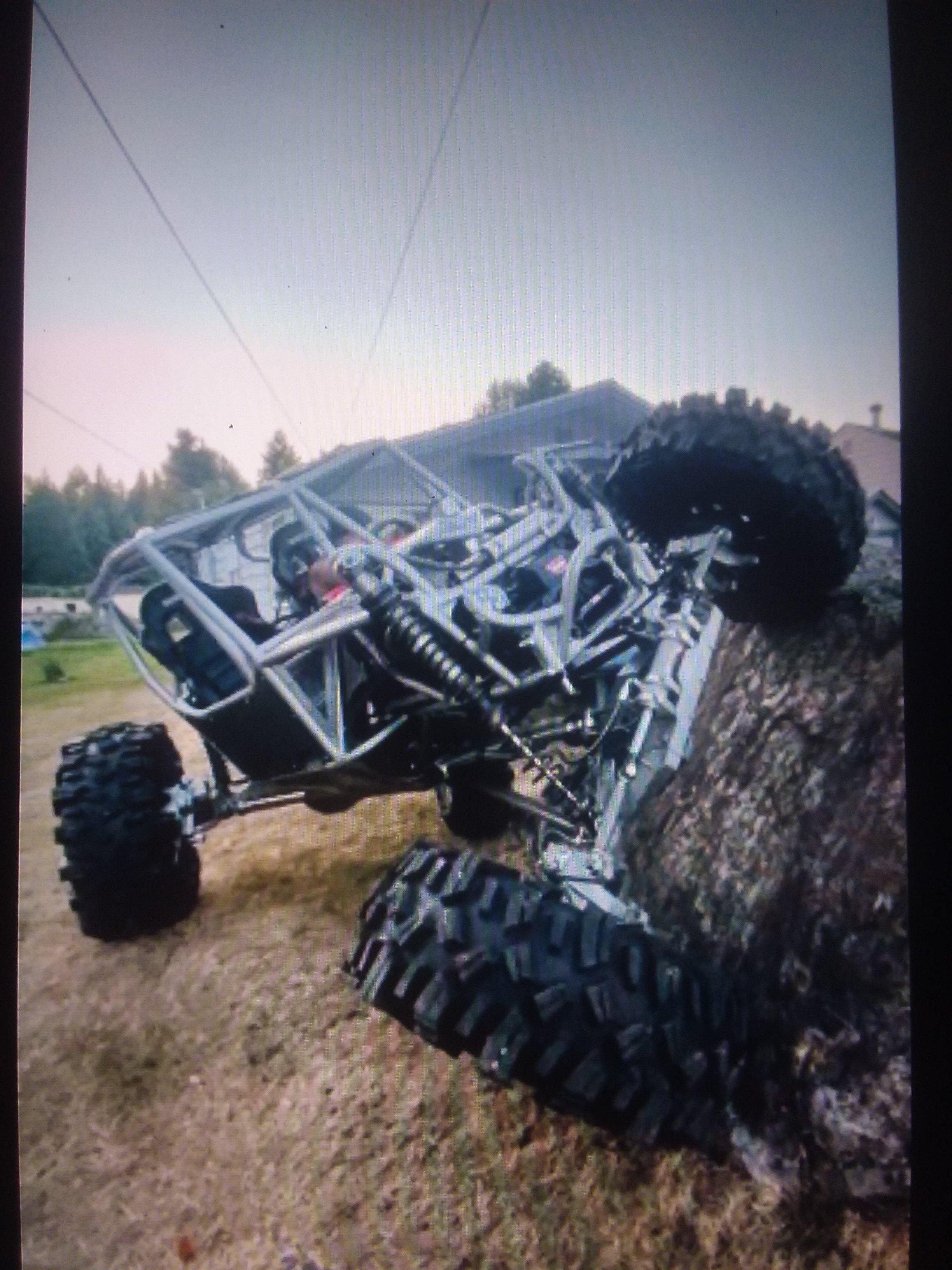

Havent got to wheel it yet exept a poser pic on a neighbors rock in her front yard

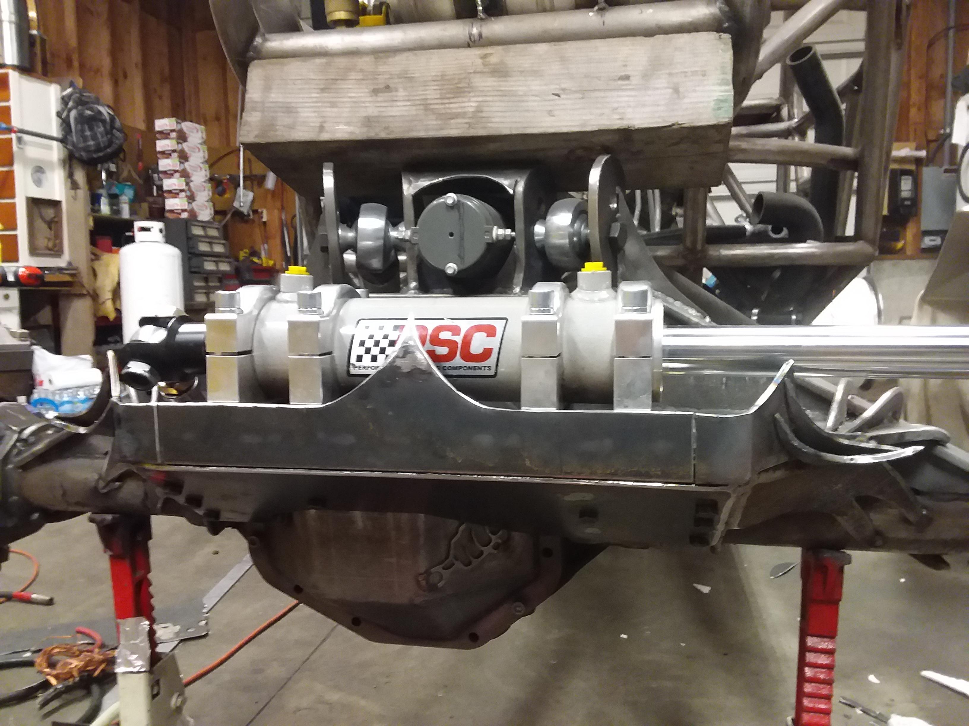

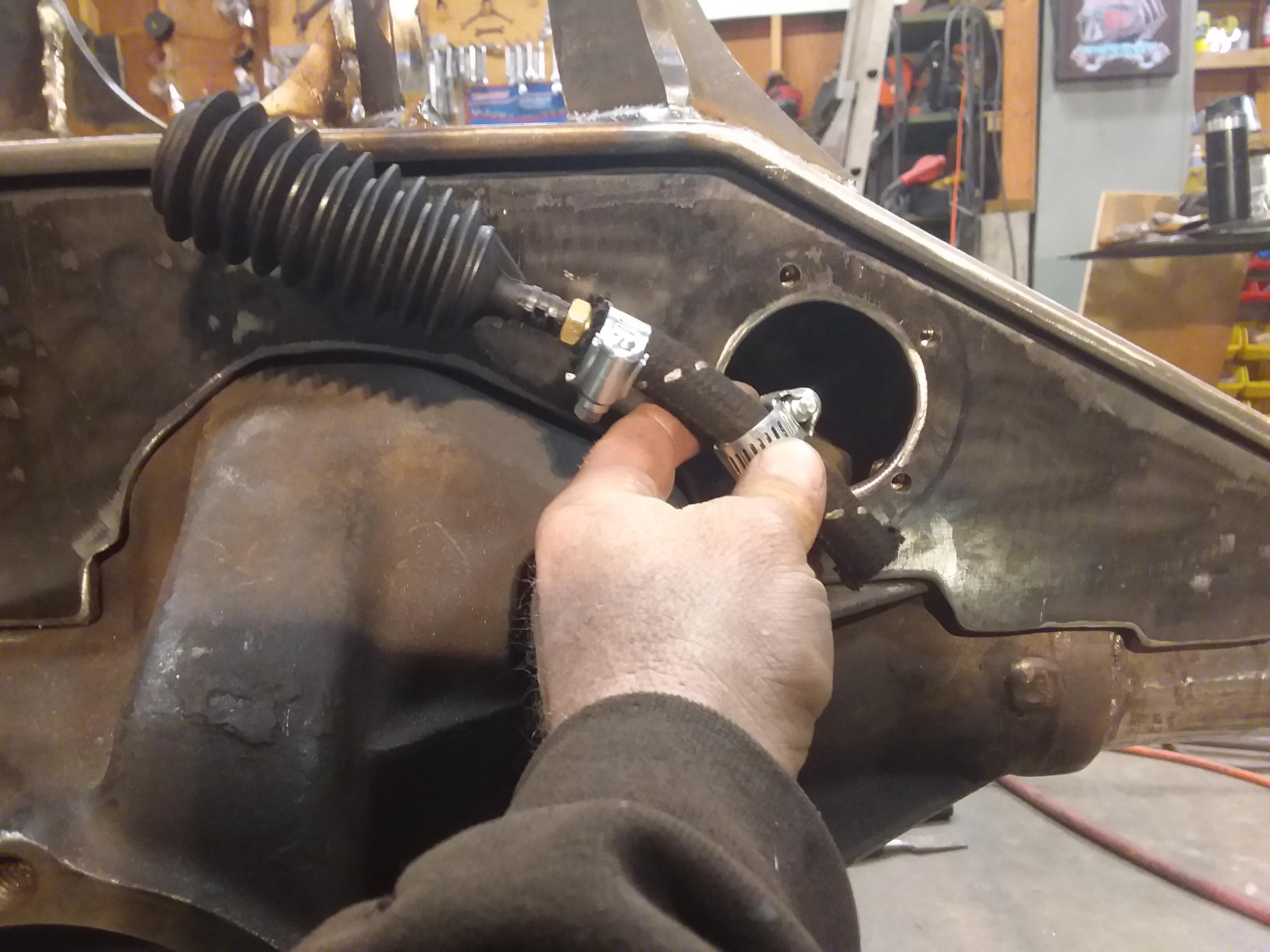

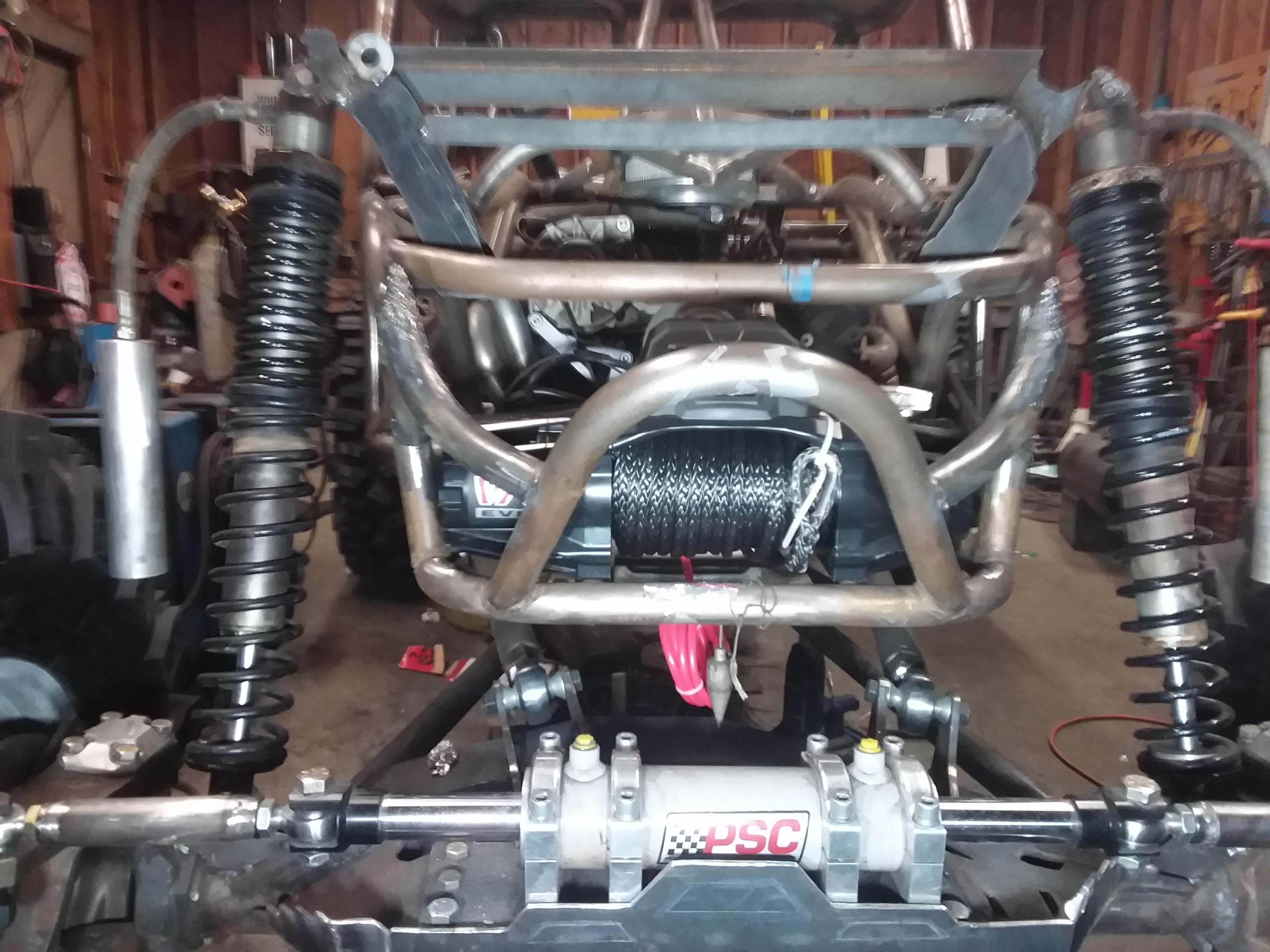

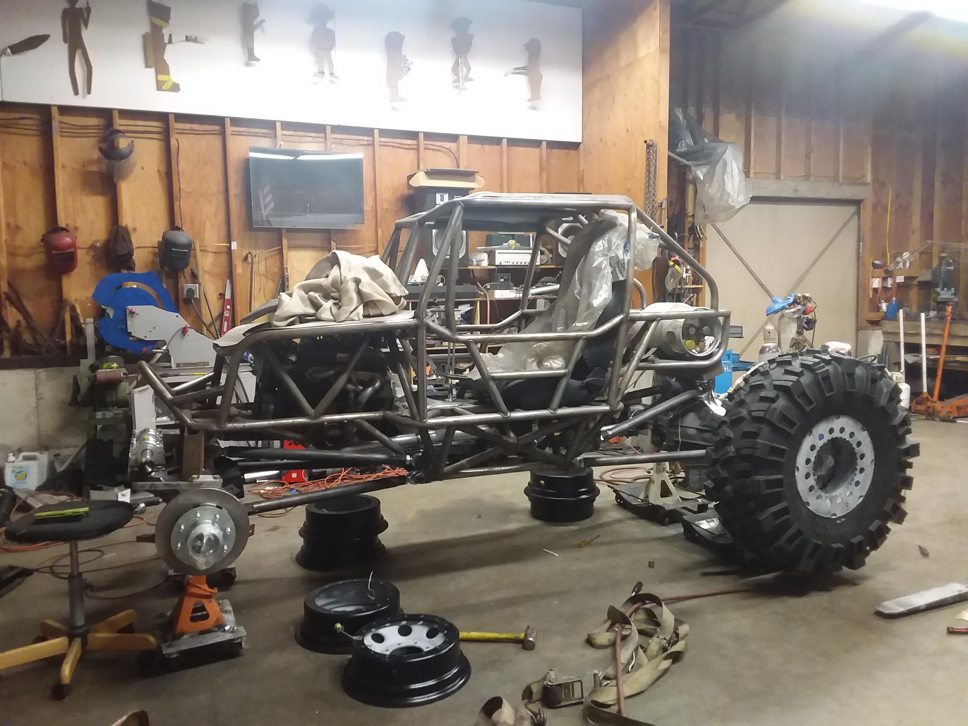

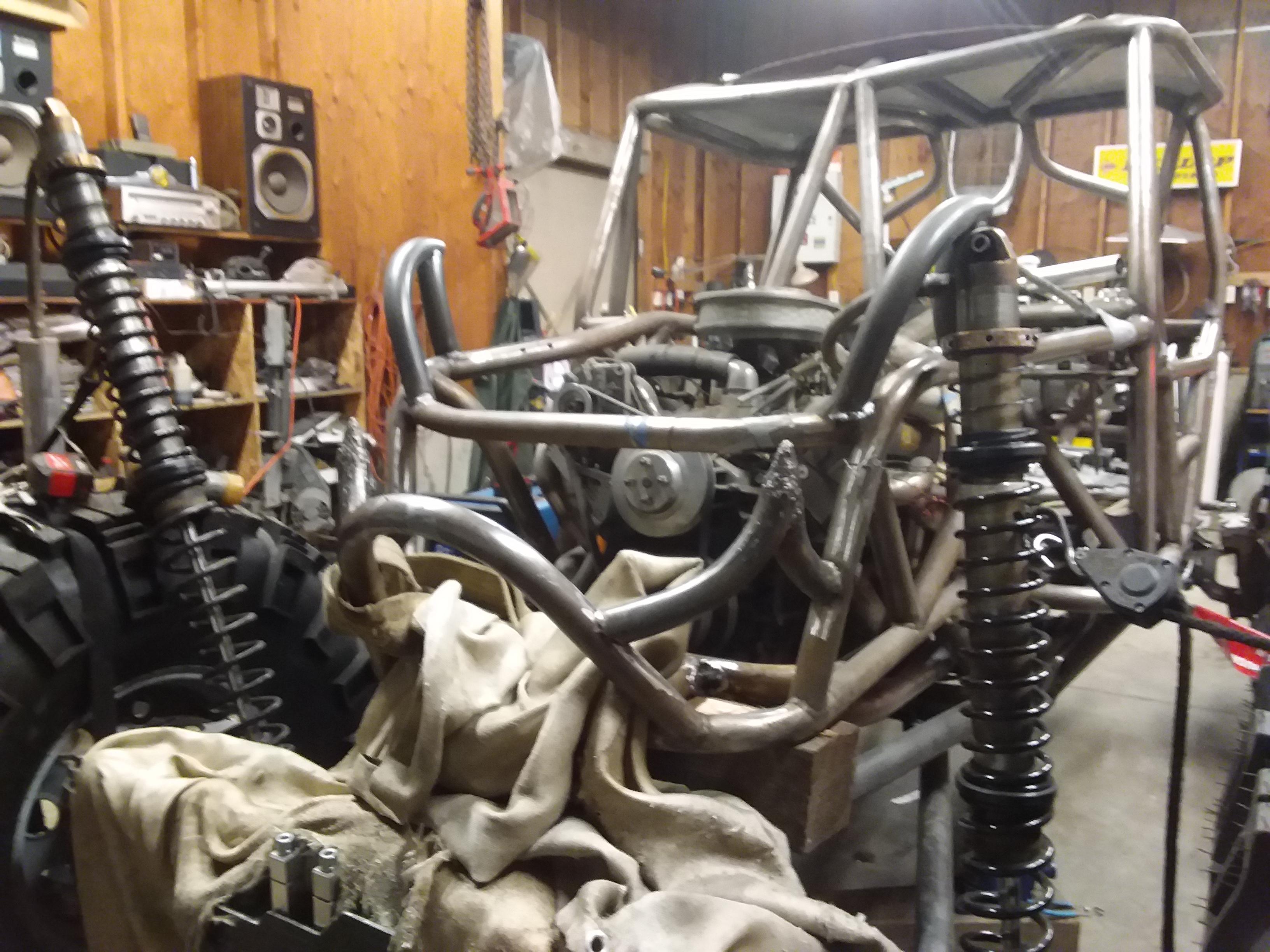

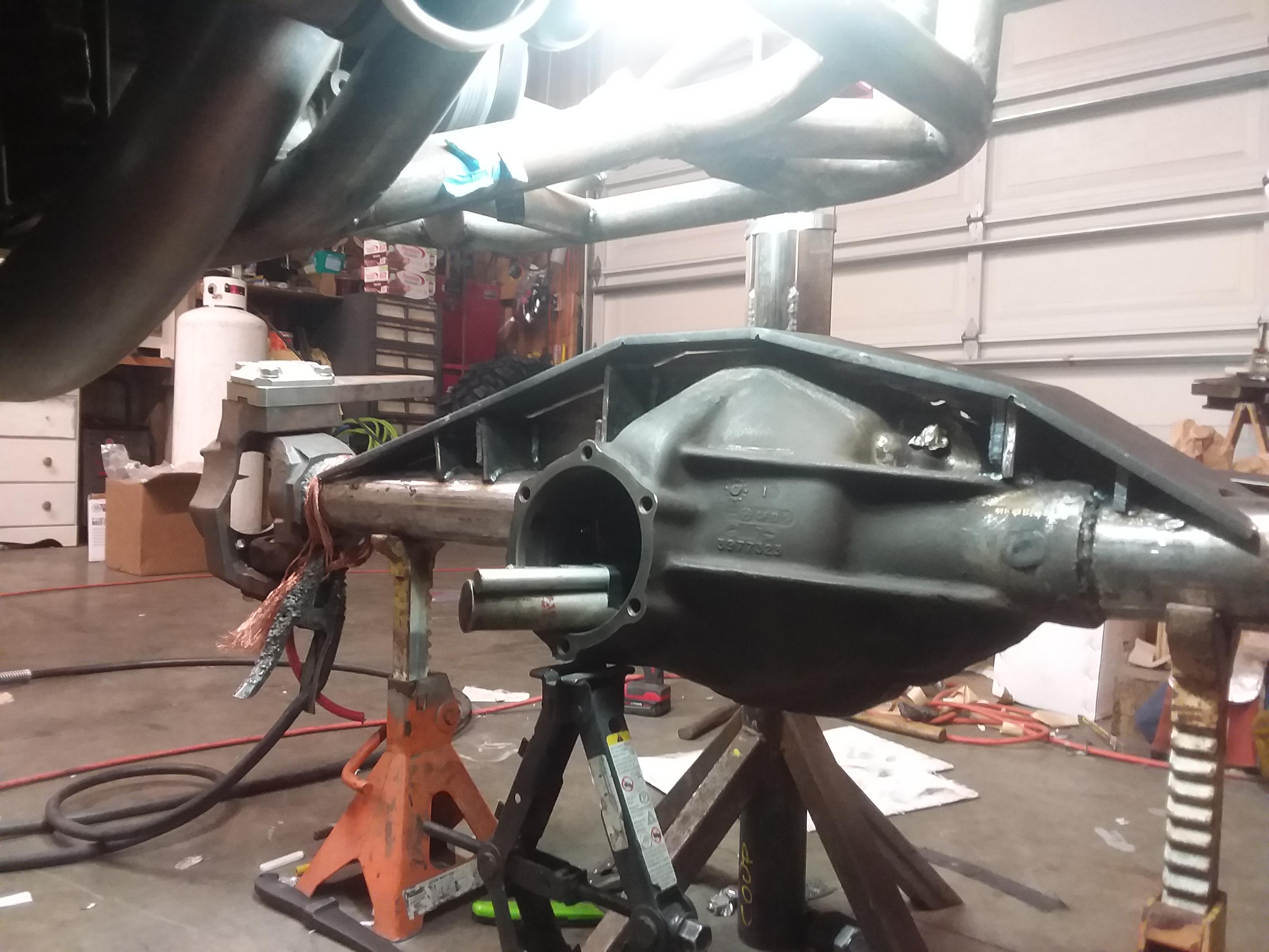

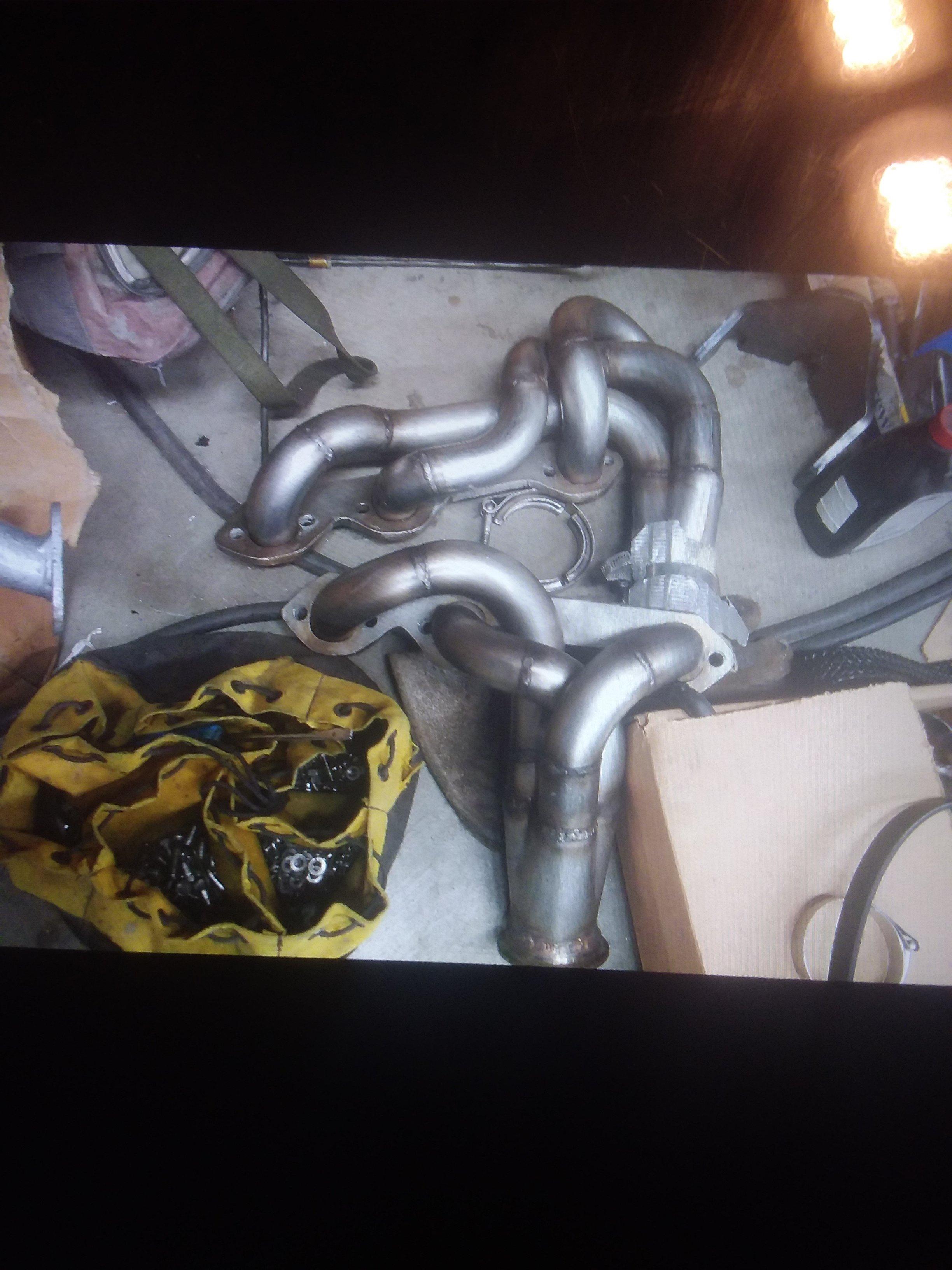

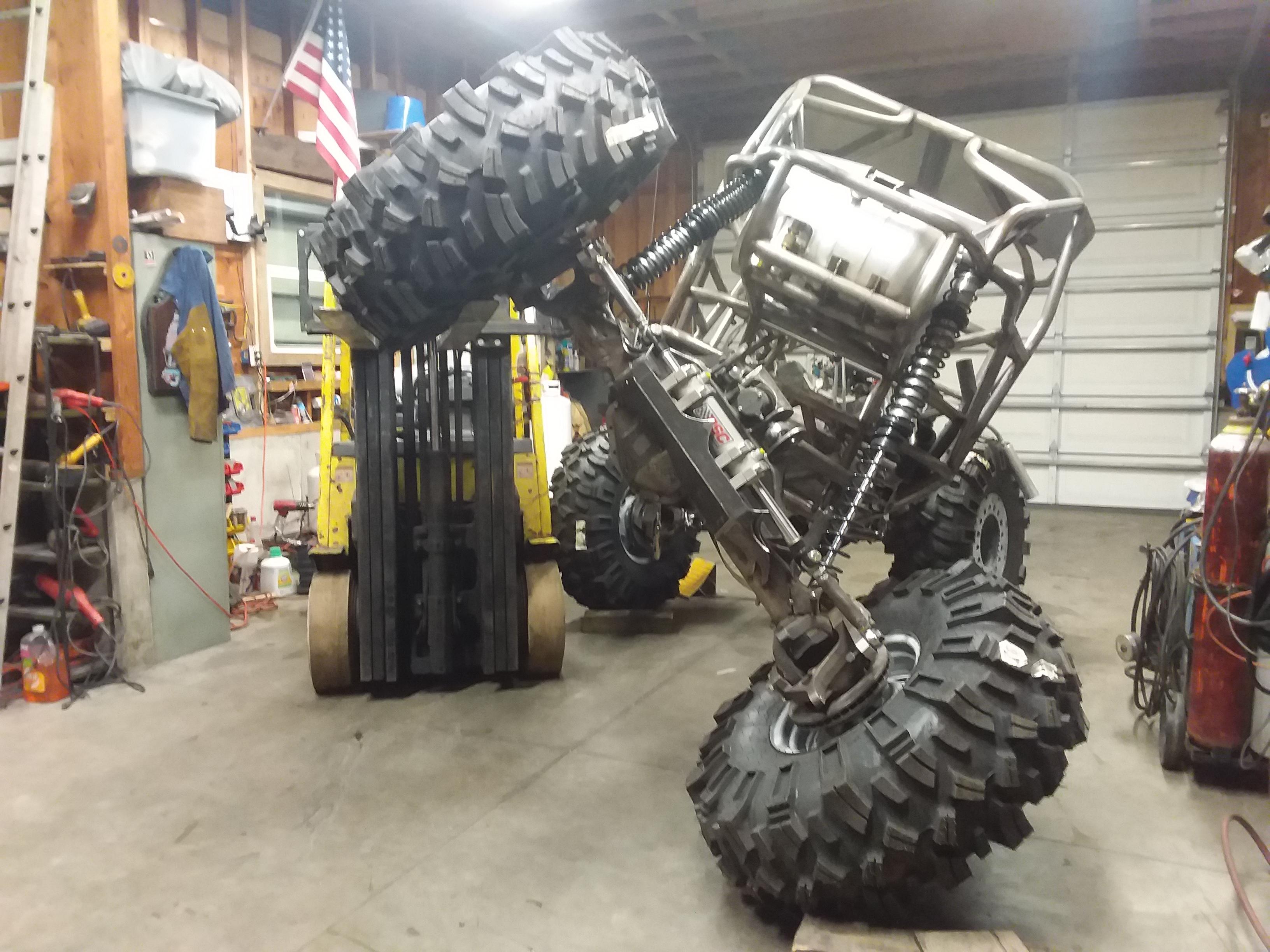

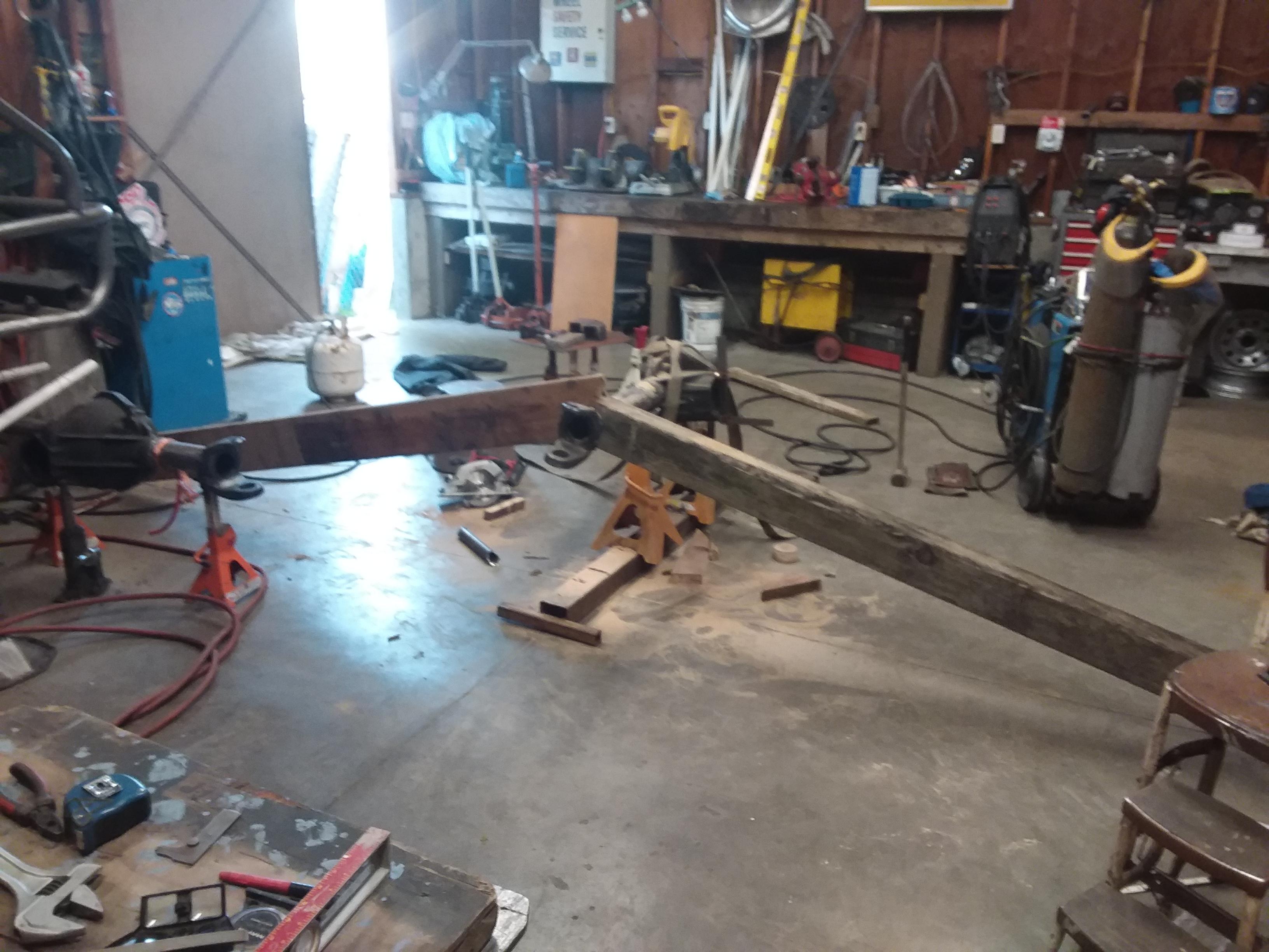

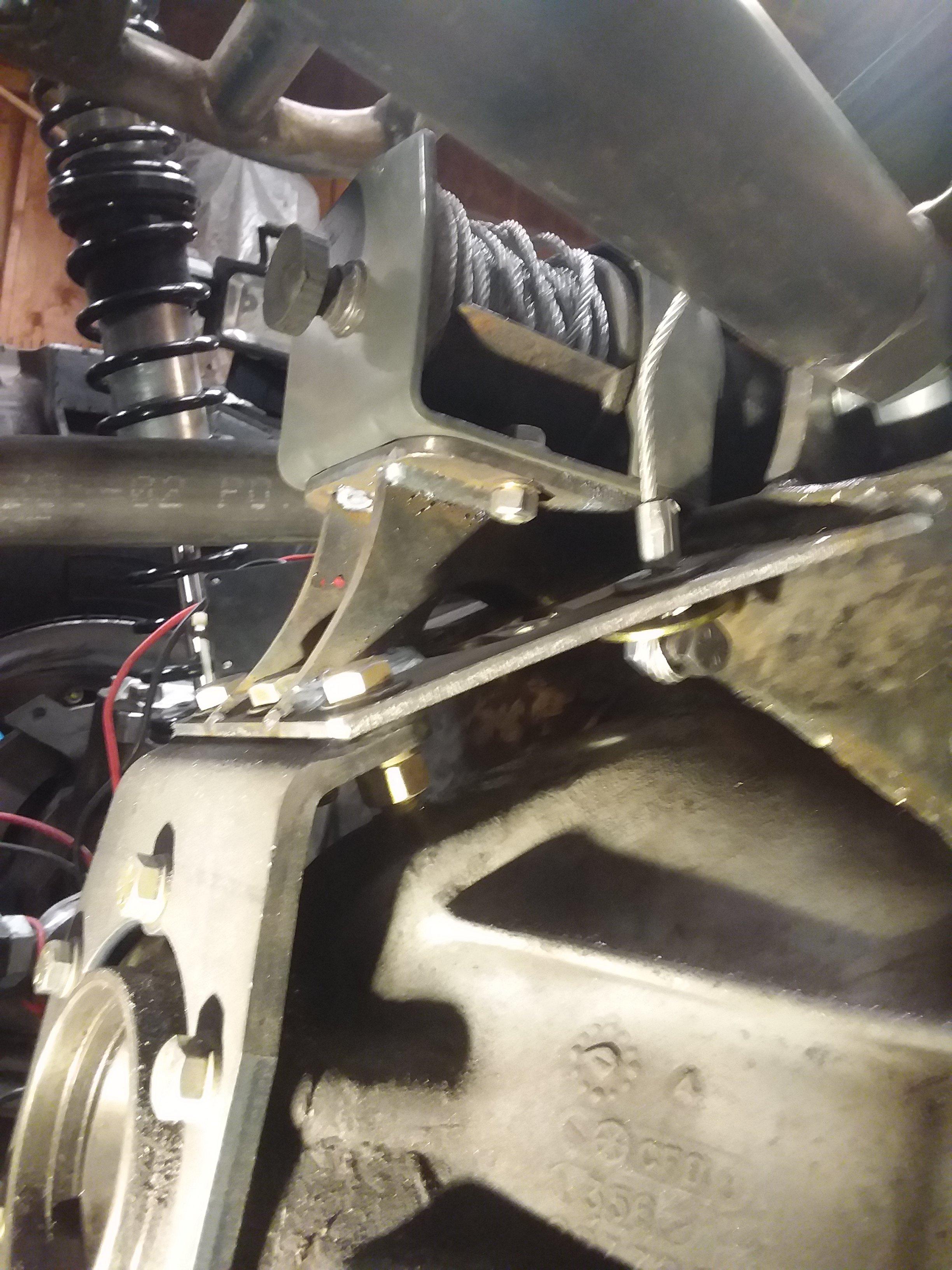

Built 4.3 on propane. Stteering14 bolts front and rear with Crane parts 538 gears spools and hub flanges. Th 350 tranny with reverse manual valve body and a Atlas transfercase. 18 inch FOA Coils triple rate
Trail worthy double beadlocks Kryptonite 40 styckies
Its heavy at about 4700 lbs without water in the front tires
I had the chassis feom way back and recently finished it and changed a bunch of tubing to work for me Just finally started actially working on it about a year and a half ago. I almost had it built after a solid year of working on it many hours a day but the motor I had was junk so I spent the summer assembling another motor with help from my step son.
