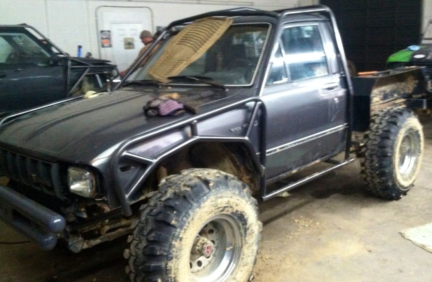

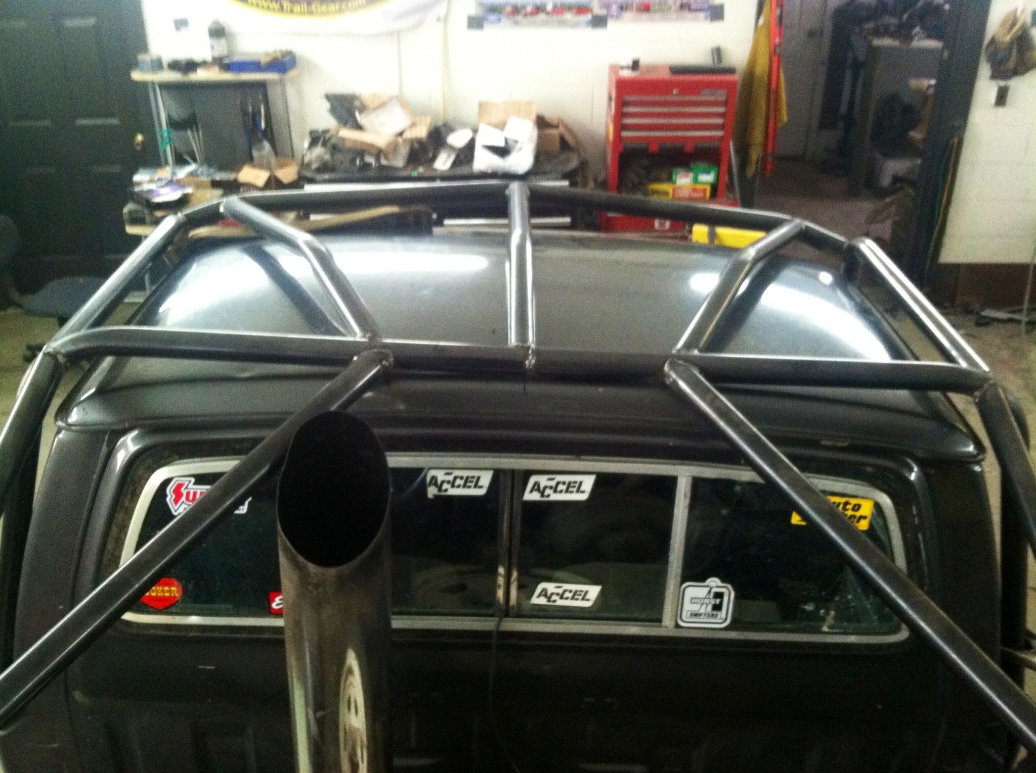

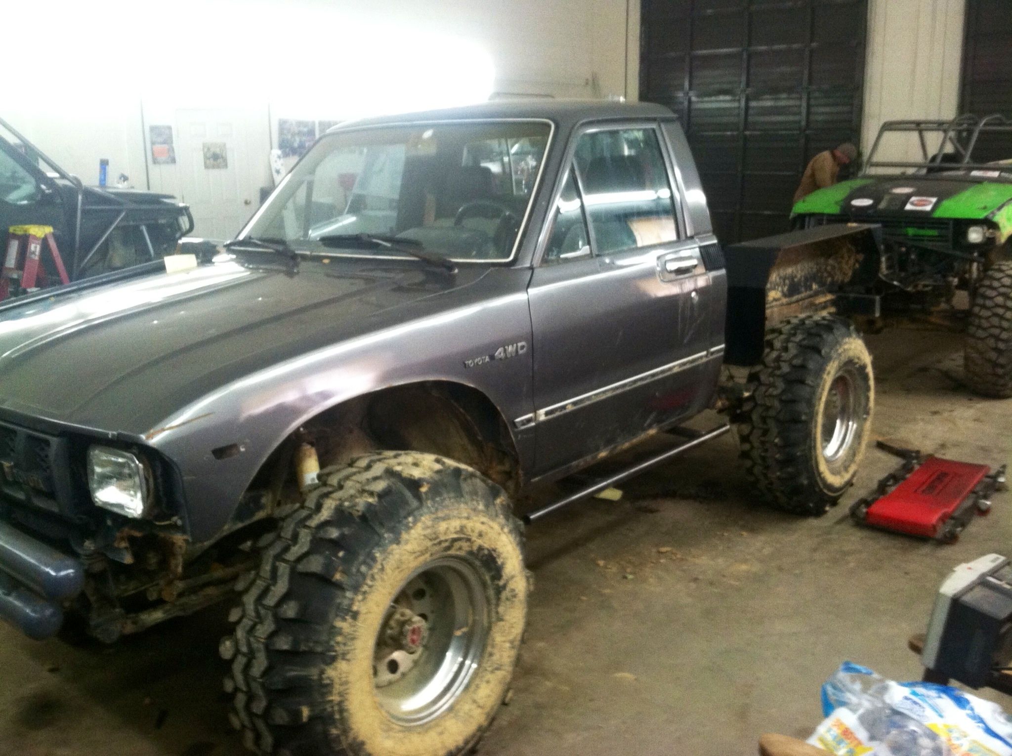

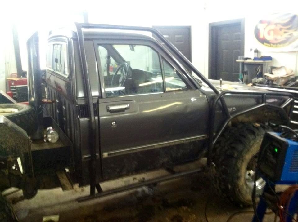

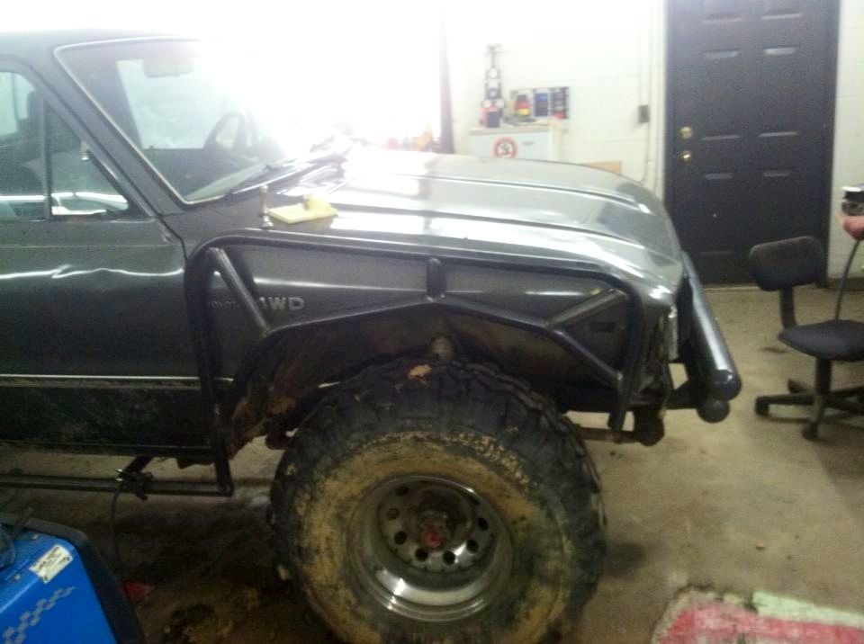

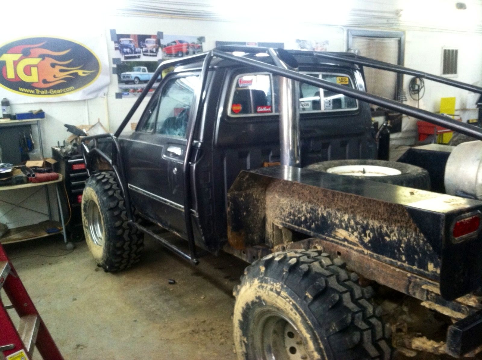

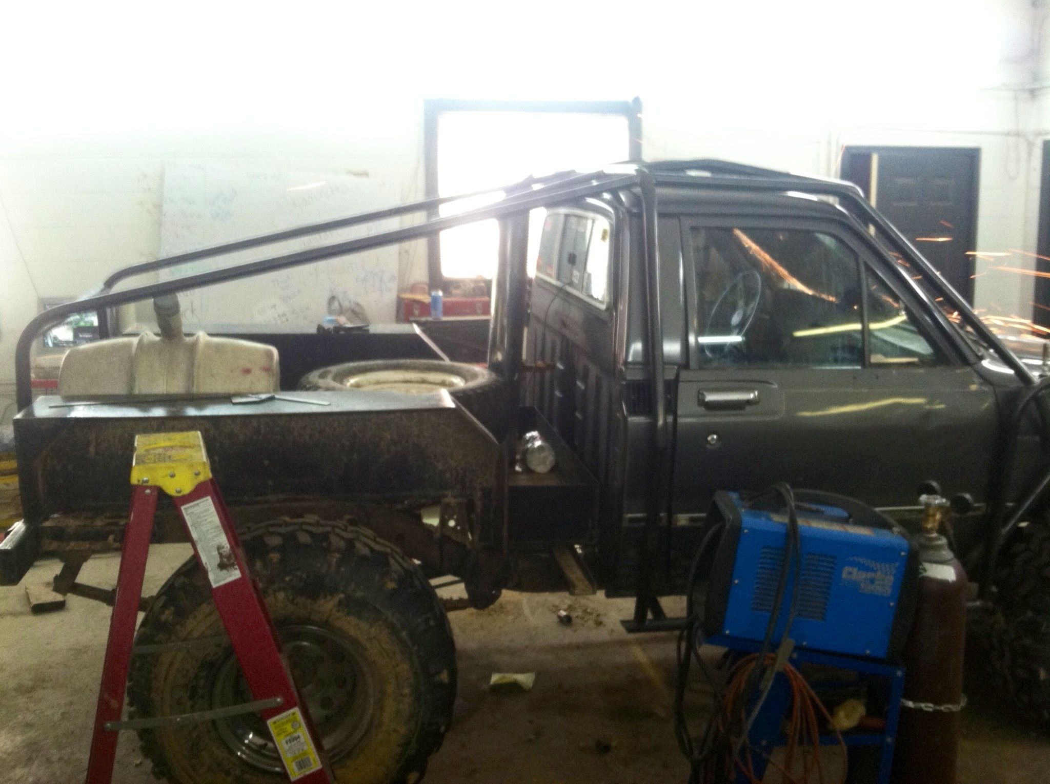

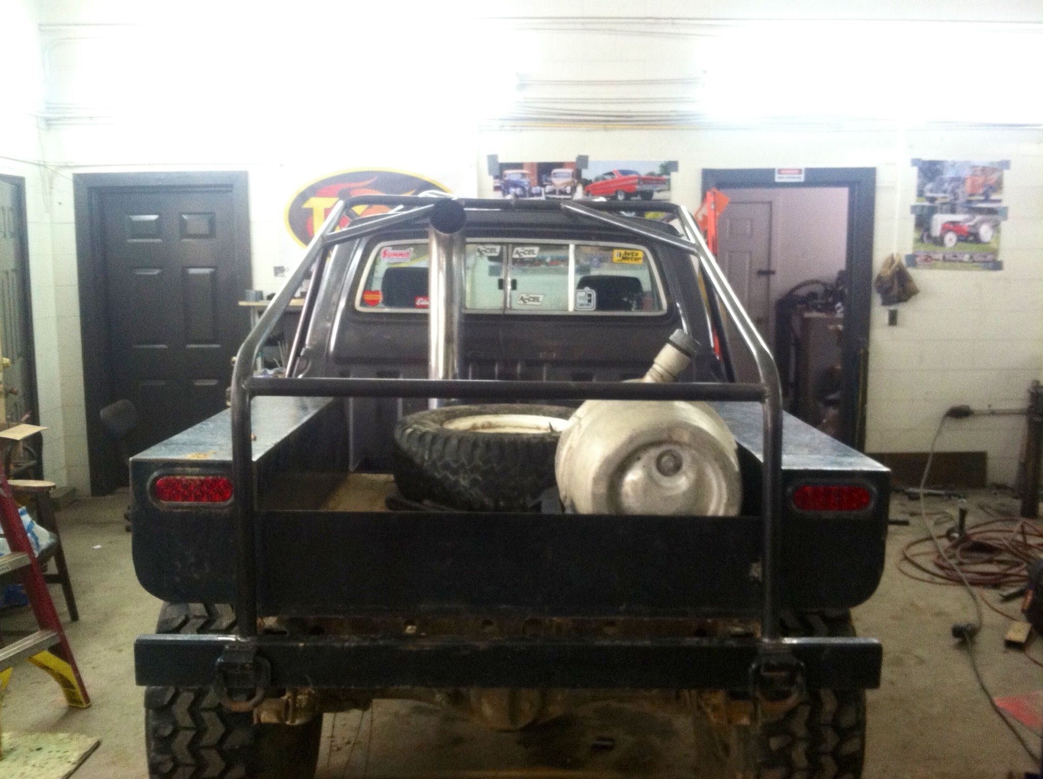

Ok guys we normally don't post up any of our build threads in this forum but since hjpcummins decided to bash our work I figured we would start posting when we do builds. Heres some pics of a cage we are doing for a customer who actually saw the ftoy too. Any way he has a first gen Toyota trail truck that has a flat bed and he wants us to build a cage (his design). SO we started it last thur and pretty much got it finished up this morning. The cage is built from .120 wal 1.5 inch tubing. Mig welded. Big_dodge will be posting pics in just a few from his phone so u guys can check it out.

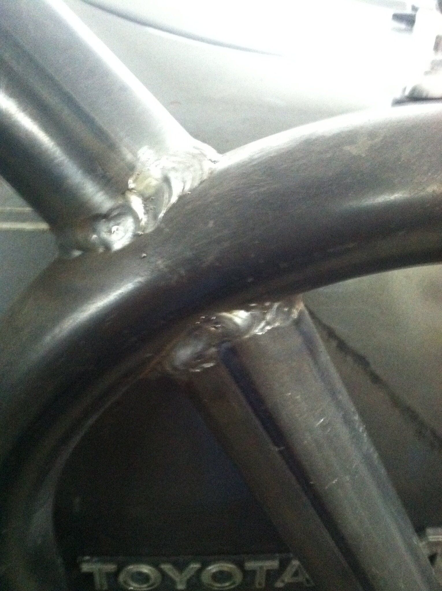

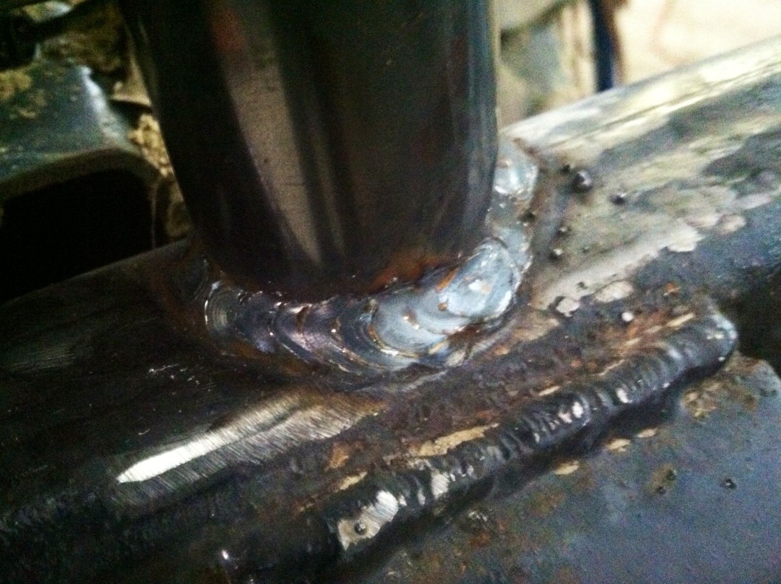

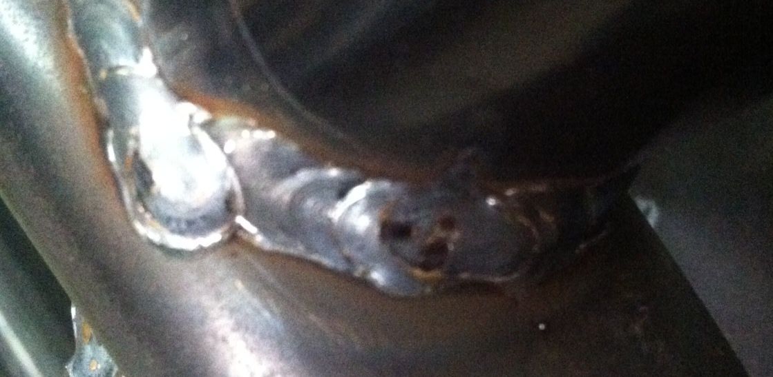

Welds

Looks good! Now why didn't I Recieve the same?
And btw I didn't bash your work, I just laid it out there
I sure hope those rear bars over the bed area get some braces. They will bend fast!
Truck was built to the owners specifications. We're going to suggest bracing down to the 1/4" fenders but its up to him.
As of now it's just a mild trail rig/around town dd.
