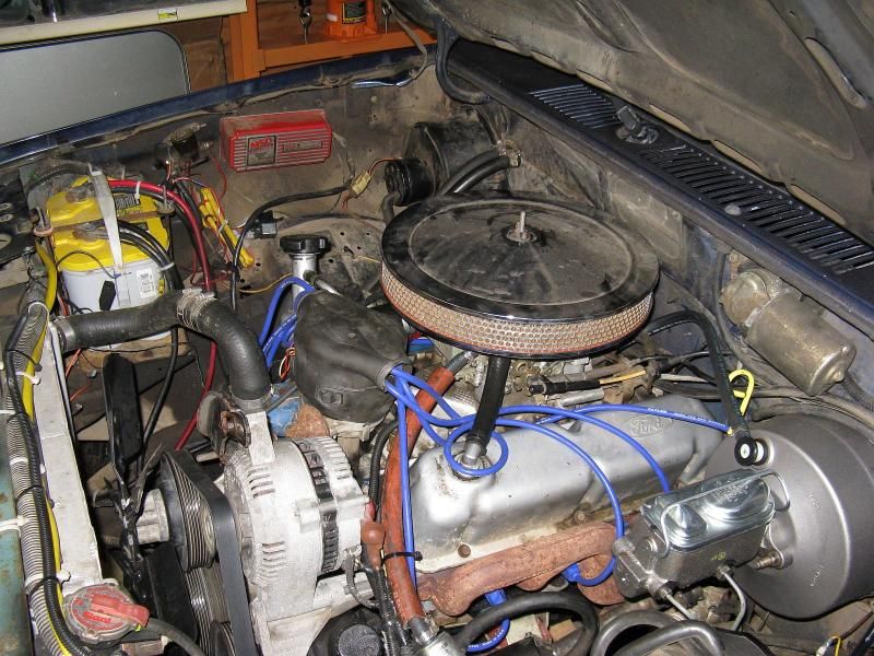

<blockquote data-quote="Poohbair" data-source="post: 1534755" data-attributes="member: 16742"><p>I love my injected 5.0. </p><p></p><p>Aftermarket parts are everywhere, the aftermarket wiring harness is beautiful and simple, all the emission **** can come off, the MAF is simple and flexible to mods. The 289/302 are the same size. The 351w has a taller deck height, a bt wider intake, so the heads and exhaust sit out a hair wider than on a 289/302.</p><p></p><p>Do it. They work.</p></blockquote><p></p>
[QUOTE="Poohbair, post: 1534755, member: 16742"] I love my injected 5.0. Aftermarket parts are everywhere, the aftermarket wiring harness is beautiful and simple, all the emission **** can come off, the MAF is simple and flexible to mods. The 289/302 are the same size. The 351w has a taller deck height, a bt wider intake, so the heads and exhaust sit out a hair wider than on a 289/302. Do it. They work. [/QUOTE]
