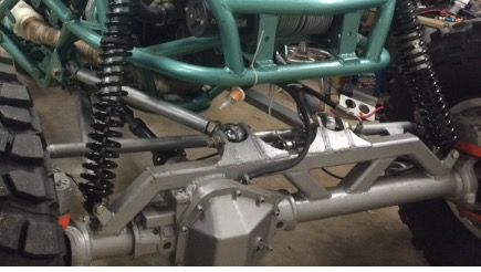

Not a GM, and not sure it will help but this is a ford hp 60. Not sure if it's the factory location as that's where it was when I got it, but my truss doesn't cover it.
It's just a short tube with a bolt in the end. To my knowledge it hasn't caused me any issues yet. My seals don't leak. (Once I got rid of the Yukon "super seals" damn pos's they were ugh)

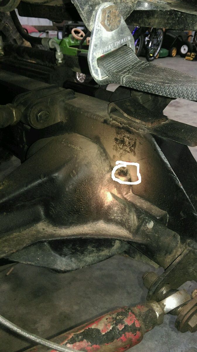

Thanks for the pics and replies guys. Here is a picture of where I THINK my factory vent was supposed to go. It's hard to see, but the truss covers it just enough that I can't thread a nipple or anything in there unless I notch out the truss in that area. Best I can tell, it's been filled up with something also. Maybe JB Weld. I'm thinking about drilling in to the back side of the area, near the bottom of the hole, and adding a vent. I'll look at it more this week and come up with something for it. Thanks again.

That is a bolt hole for the spring bolt. Both my 60 vents are in the same location as in the picture posted before.
HMMMM, guess I'll check the other side tonight and see what I can find. Thanks for the info.
