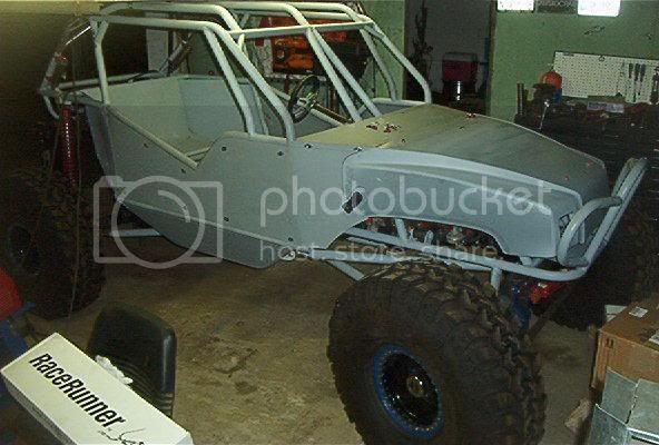

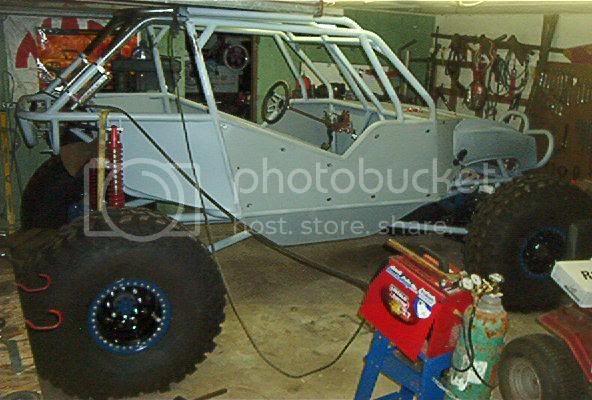

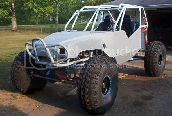

Couple of pics of were Joe is at on it when he dropped it off.
The rear has a floor and sides around the seat to protect the kiddos, pretty cool. He said he had one of the rear skins almost done. I have to put some tube and get the CO figured out out back so he can skin the rest in. We got some other lil cool things in the works too . Spent pretty much all the time deciding on direction and not really executing much.

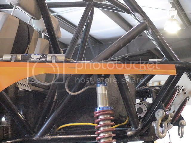

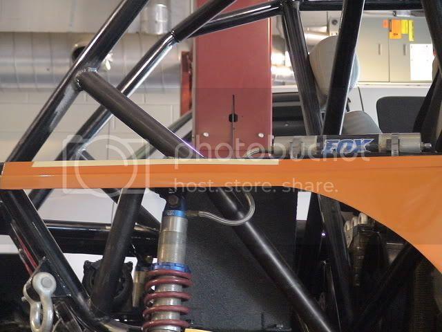

Looks a lot different. Is there gonna be a skin that covers the rear tube (ie: outside of the coilover mounts)?
Looks good, My motor is getting pulled tomorrow so hopefully he will be able to get it Tuesday or Wednesday.
My only question is the way the rear coilovers are mounted to that straight tube with no brace on top. My coilovers used to be mounted similar to that and it started bending the bar up. We had to put in some braces'.
they really arent even mounted... just stuck them on some tacked tabs so it could roll and simulate ride height... they will be further inside the chassis when its all said and done and I agree with you on what your sayin .
