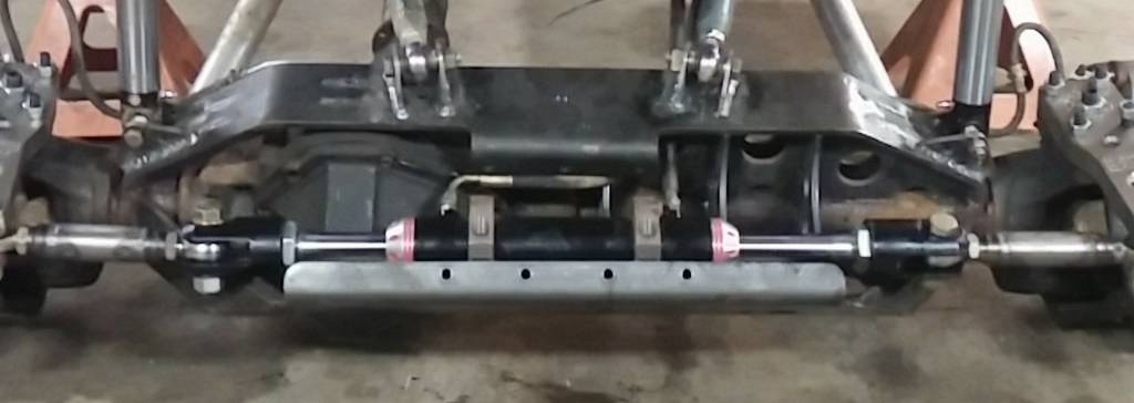

The way I set them up is, turn the knuckle full lock out until the ears of axles touch, move the knuckle out to give 1/8" clearance. Extend ram and measure a straight line, mark for hole.
I don't use steering stops, I setup the ram to be the stops to prevent it from over traveling the knuckle.

The pics above show the artec truss, but I didn't mount the ram mount until I verified like I mentioned above
