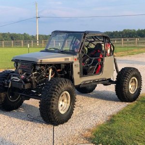

Does hydroboost introduce a lot of additional heat into a steering system? I have been battling a hot fluid issue on Jessica's buggy pretty much since day 1. We are about to be on pump #3. The first pump was deemed bad but I'm pretty sure heat killed it, second pump lived for a good handful of rides but it is now about ready to give up the ghost. I can tell her fluid smells burnt and just putting my hand on her steering res vs laying my hand on my steering res after we run the same trails hers is way hotter. Our steering systems are identical with the exception of two parts.

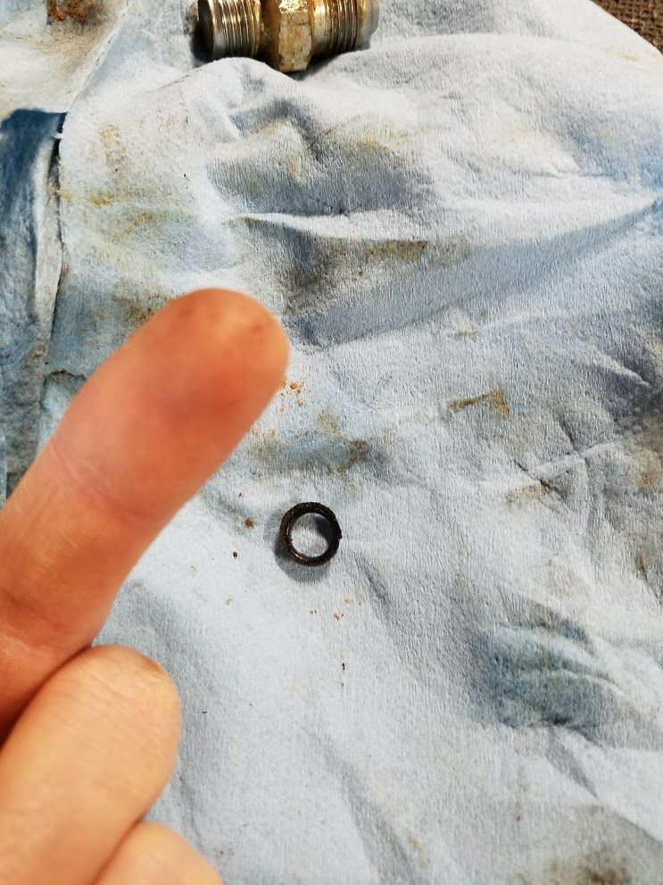

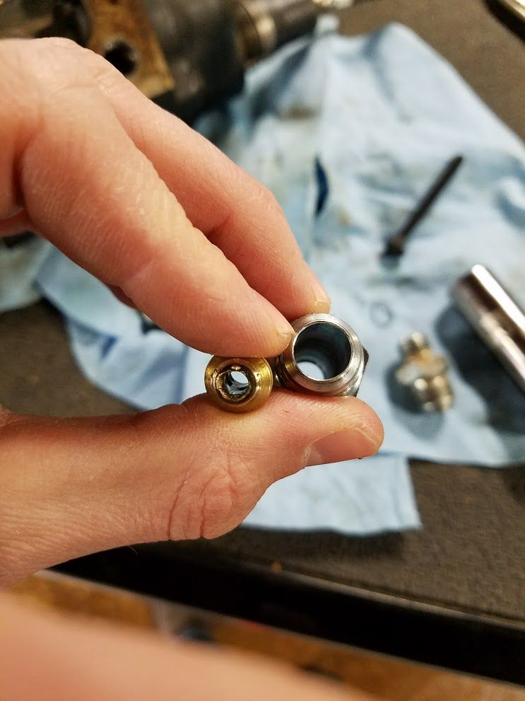

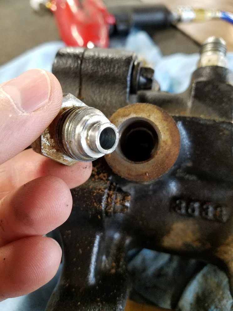

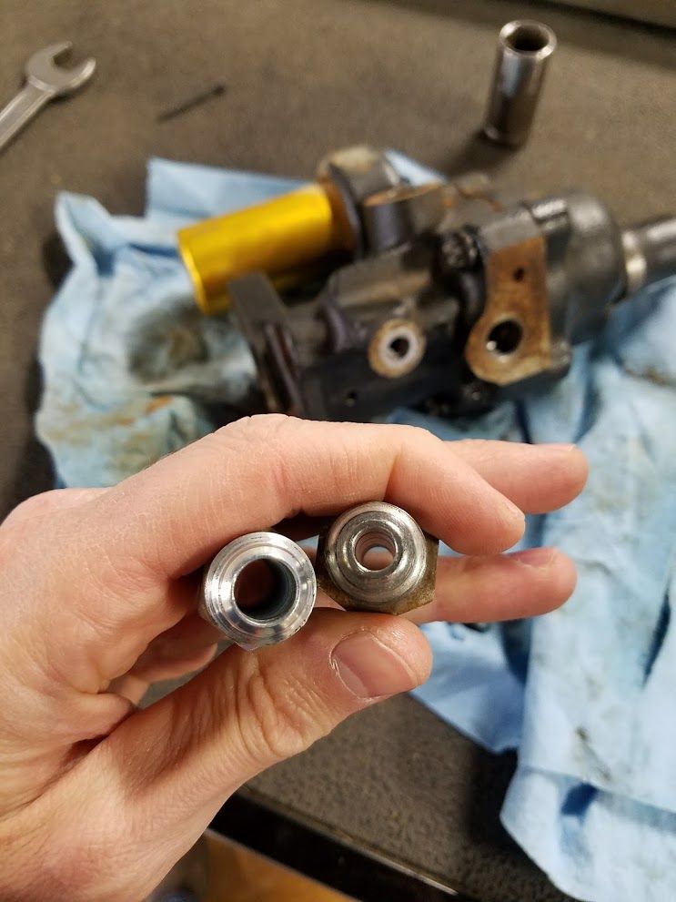

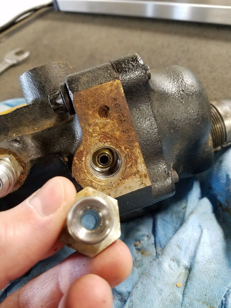

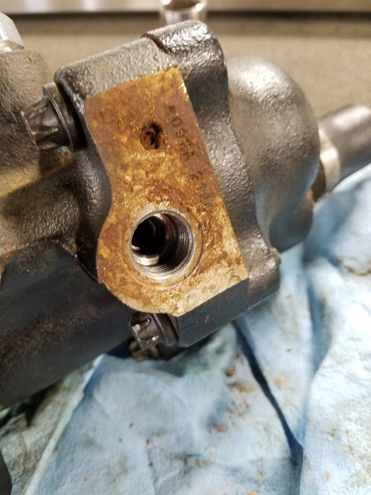

Fingers crossed, I may have this problem whooped. We'll know for sure after our next ride which is New Years at AOP yea c'mon. Hydratech wasn't much help. It's clear those dudes know their stuff and are total hydraulic nerds and they inundated me with a bunch of tech, but all their solutions pretty much revolved around limiting the flow from my pump. Not gonna happen. They're not offroad guys, so I guess they don't really understand what we're trying to accomplish with these big pumps and massive rams. As a last resort before going to manual brakes I called up Lance at PSC. He set me straight in a hurry. Wish I had just called him first. We were essentially trying to push a **** load of fluid through little tiny ports and fittings in the hydroboost unit which was creating a ton of heat. Lance says they run hydroboost on everything and just modify them for high flow. End of story. I'll let the pictures do the talking.
