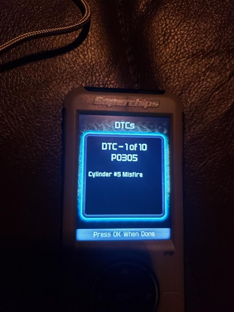

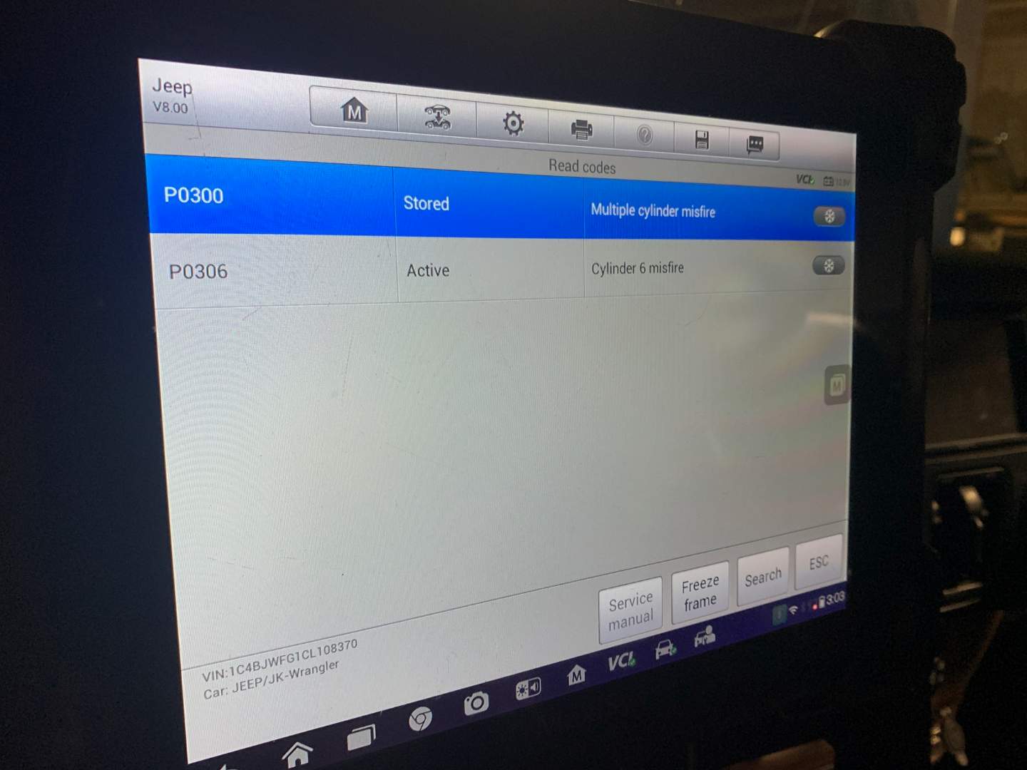

Finally got a chance to dig into the jeep using the real scanner and not my Flashcal. That scanner is showing misfire cylinder 6. again..
Talked to the service manager at the dealership. they said to bring it in, if it is cylinder 6 they will warranty a new head.
I am curious why the scanners are reading different.
