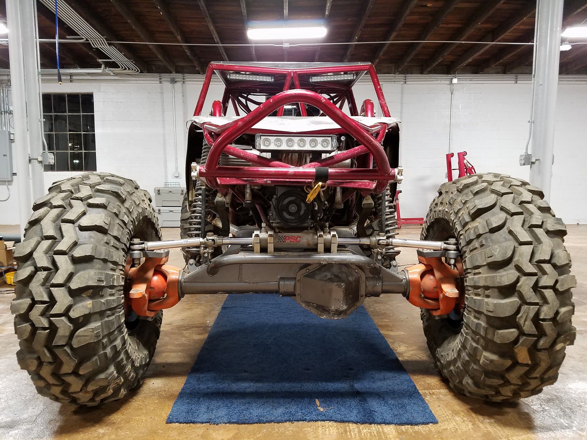

JDodd is making/looking to make just what you are looking for. Uniballs and Unit bearings with Rockwell size joints.
http://www.hardlinecrawlers.com/forums/index.php?topic=54209.0
JDodd said:
RCV is getting close to fully release their big bell axles for the Ford hub so who is thinking about runing them?
I have designed some fabbed knuckles around this setup and i'd like to hear some input from the guys looking at running these.
branik will be making 1550 yokes and joints for the 05+ superduty knuckles very soon
the factory knuckles are cheap
the reid super knuckles above are an aftermarket version of these with kingpins
