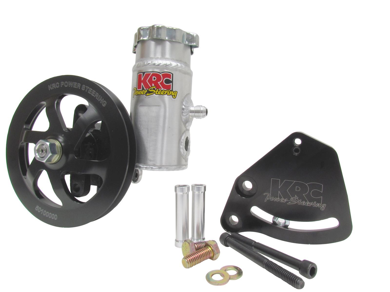

I just purchased a KRC pump and it didn't last but a few hours. It was on a sbc and had the bolt on reservoir. I'm not sure what happened to it but it stopped working after just a few hours.. I had to put my stock gm pump back on and continued riding. Any one have any ideas?
Check your plumbing. About the only thing that can destroy a pump that fast is air, or debris in lines. Post up some pictures of what you are working with.
Check the keeper at the end of your pressure relief valve. They are just pressed on and I've had them pop off before. Always tig them on now.
This is the exact pump I have. I was running a stock pump before with no issues and then put the stock pump right back on after the KRC failed. I told KRC it quit working after a hard hit to the frame. They said it could have messed the pressure relieve valve up. I guess I will return the pump to Jegs but don't want to keep on having the same problem. I do not believe it is a plumbing or air issue.

The pulley is 1/4" smaller than the one that is on the stock pump. I just pulled the control valve out and there was some kind of plastic pieces on the relief valve screen. I'm not sure what it is. I did notice some marks on the control valve nut that looked to me as if somebody had already opened it up. KRC told me that if it would have been a complete failure that it shouldn't be able to free spin easily. Maybe the trash had the screen blocked and couldn't get any fluid through? I will put it back on tomorrow and see. I agree with everyone on the pump being a good one. I got a buddy that has one and its been trouble free.
