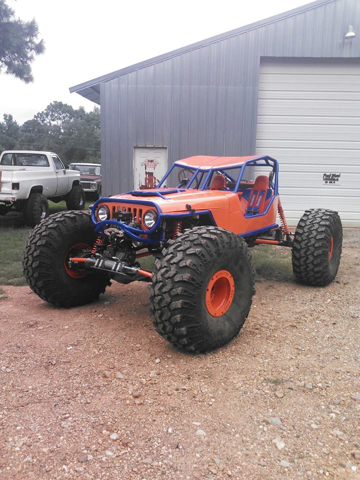

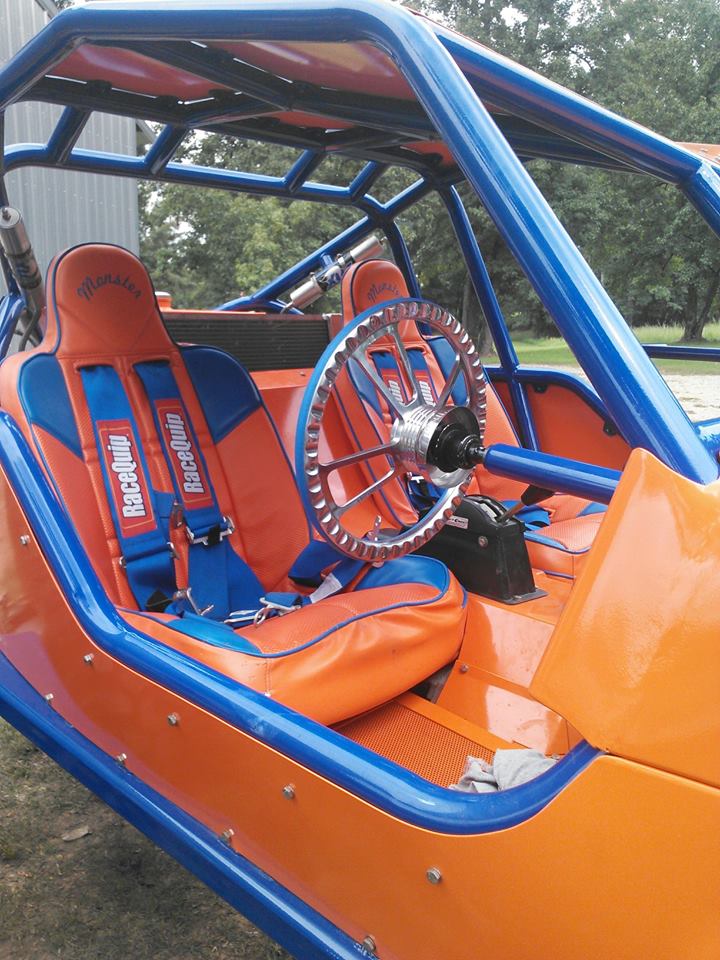

I'll start with this tube chassis jeep we built in about 2003
Lt1 383 striker motor, four speed, narrowed Dana 60's, 12 in coil overs, 44 boggers, 112 inch wheel base and 26 inches of belly clearance

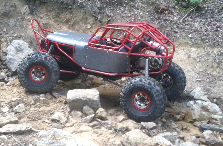

I just got my 46 willys "Dirty Bastard" Trouncer (trail ride / bouncer) Rockwell buggy on the trail.
My tube chassis
6.0 slight tweek
Twin steer rocks
Th400
Doublers
And some other stuff
