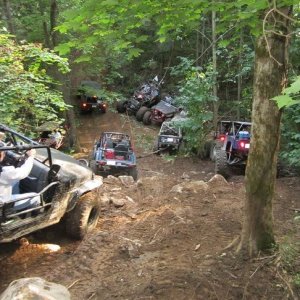

Something looks weird here...
Thanks fer sharin' Pooh!
I thought that was Rick's ride in one of those pics...:awesomework: Tell him Kev says high next time you see him.:awesomework:
Yikes! And I thought snow wheelin was supposed to be easy on parts....
My last time out I had the same problem on my junk....steering arm studs loosened up, stretched and eventually broke. Fortunately I was able to limp it back to the parking lot and onto the trailer.

Not my truck, its a buddies...
42's, Hydro Assist, bit wheel spacers, and stock steering studs.
He is going to fix it, get a new arm,and get some ARP studs ...
Mine is the Runner w/ the Pitbulls... I put in the ARP studs when I stepped up to 39.5's and Longs!

Isn't the knuckel Cast? thats why the weld no worky:beer:
True, but 6011 weld rod works as new studs in a pinch. :D I think the first job would of held, had he not been screwing around on the way out. Classic I told you so moment. :haha:
