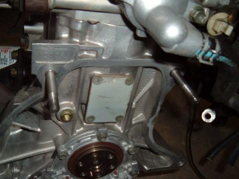

1st one is just of the adapter
2nd one is mounted to the tranny

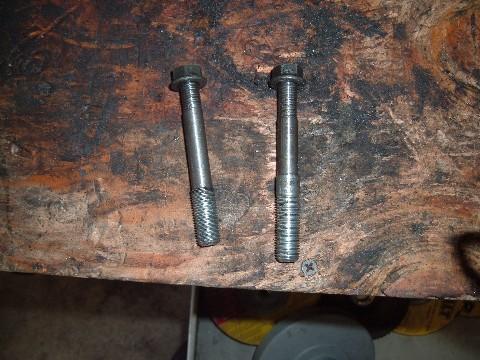

3rd one is new motor studs i had to make
4th one is new studs installed

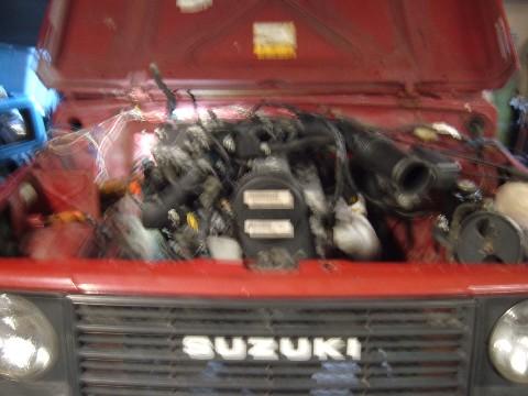

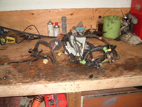

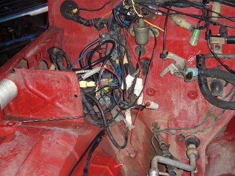

there was such a mess of wiring under the hook here are a couple pix of it and then the new wiring that i built to go in there to run all the efi stuff :cheer:

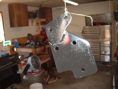

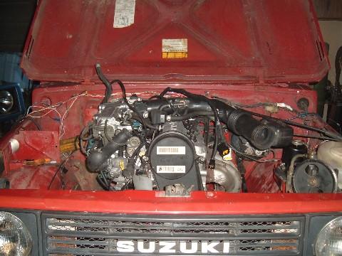

2 shots of the motor installed & the passenger motor mount moved and also the new power stering bracket now all he has to do is keep fluids in it :flipoff:

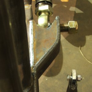

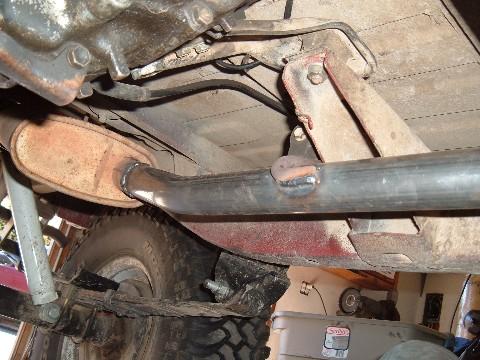

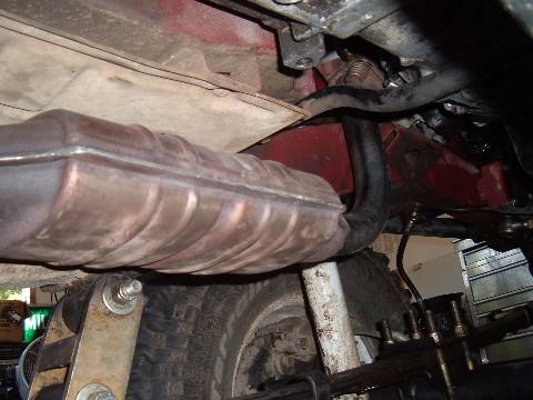

hooking up some pipes so he can take it to emissions :rb:
Some post install impressions: As has been stated, I can do 70mph now:D
It did take some driving adjustment, as I no longer have to ride the clutch and rev the motor to keep running, especially on inclines. I no longer feel that I'm taking my life in my hands, or waiting for a 3 mile window when I turn in and out of Reiter road across Hwy 2.
Gas mileage was 25+ driving at 3800 RPM over the pass loaded with 2 people and camping gear.
I like my Zuk a whole lot better now:cheer: :cheer: :cheer:
