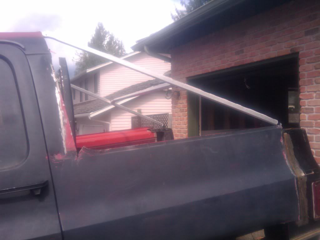

so i guess 4 tents was way over kill, one covers the whole thing.

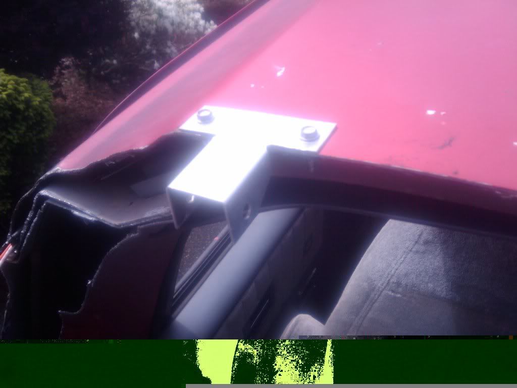

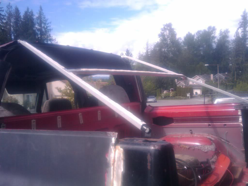

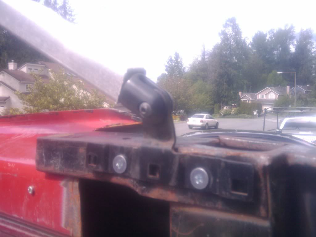

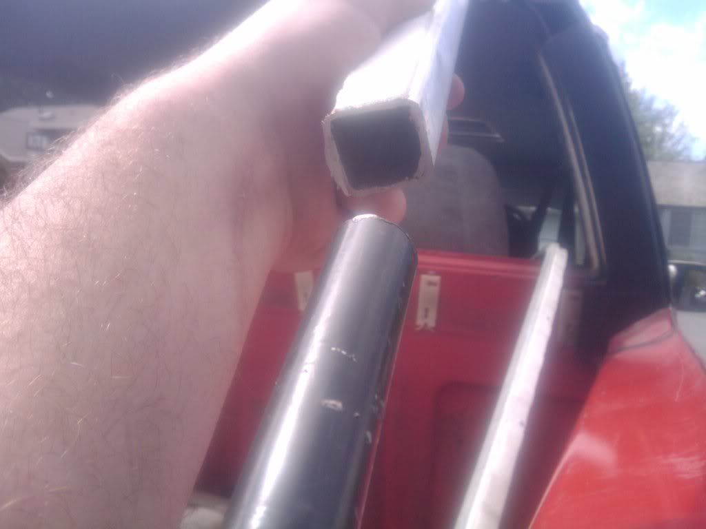

i mocked it all up just now. the sami frame is tube and the top ribs are rectangular, which just so happen to fit over the sami tube. Which made this super easy. All i did was use the frame pieces, and since they were too short, i cut lengths of the tube to fit in it and extend the frame piece. then i used the sami factory lower mounts to attach to the back of the bed on the inside of the bed rail. all of this is held with duck tape while i mock it all up, and i will take pics tomorrow before i proceed. To lay the canvas without falling in the voids i used a truck bed spider bungi and went over the whole thing then put the canvas over it.
the pics tomorrow will explain what i mean easier. but im amazed at how simple this is going.
snags i foresee are adding tension straps to the canvas, and getting all the pieces fit together.

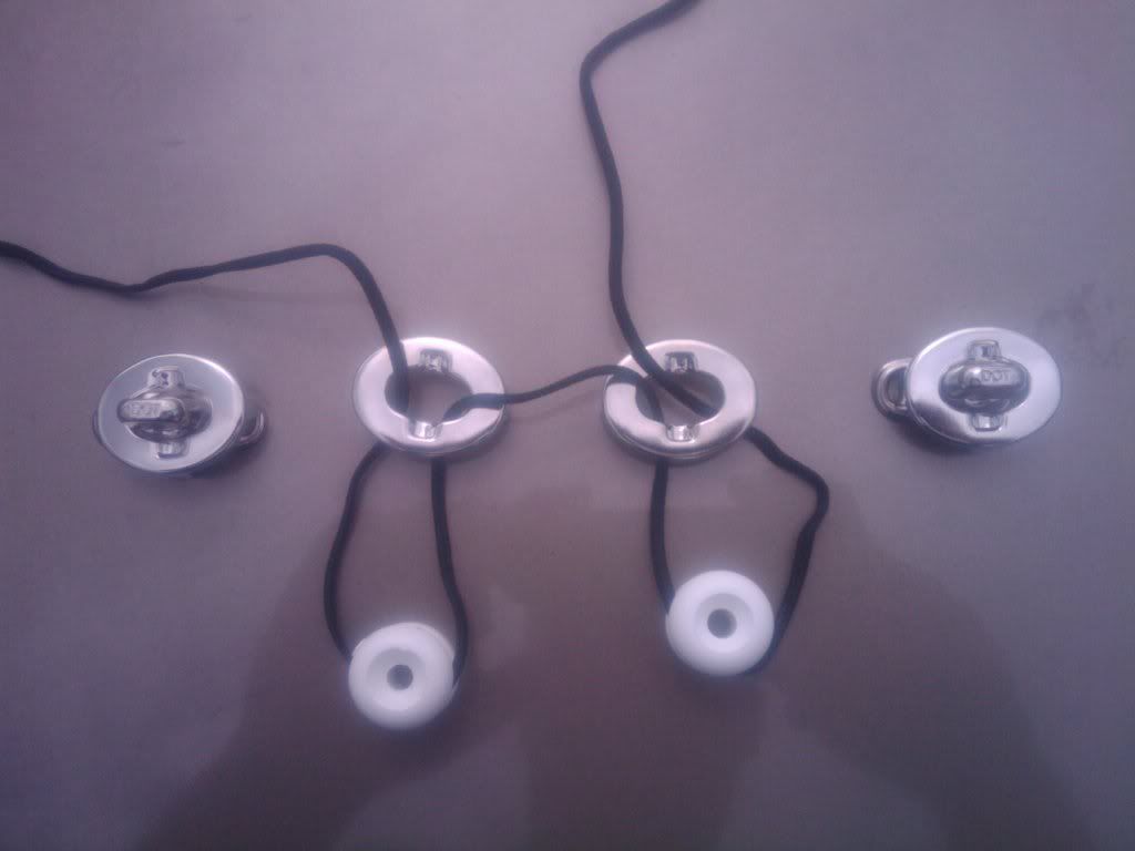

so i went back and got a ribs from a fullsize truck top. i also went and got "common sense snaps" with extra canvas tabs. i have a crazy idea with those and some 550 cord. ill post a pic later.
so now im into this an extra 75 bucks. i have everything i need for the most part.
the badass part is the rear mounts swivel back n forth so when im camping i can unpin the roof mounts and have portable shade
pics!!
this is the pattern the "snap" system is going to be in. snap loop loop snap, its gonna be sick (btw thats just shoe lace to give you the idea, im using parachute cord)
also, this is all done with 4 ribs out of a full size camper shell with all hardware as well. i simply undid each mount on the top, 2 screws each side, and paid. the junkyard is my friend :)
